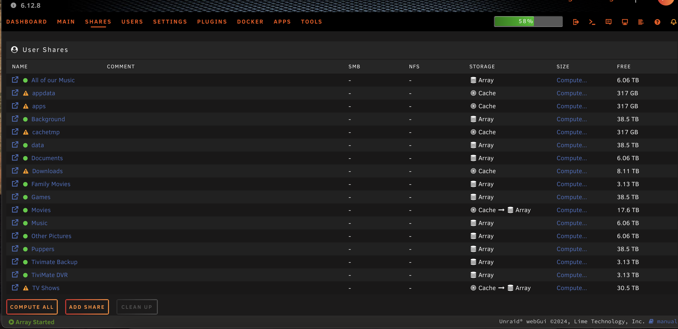

upgrade cache drive
I must be missing this part, could you post a screen shot of where this is? I can't seem to find it. Click on Shares and change to "Yes" all User Shares with "Use cache disk:" set to "Only" or "Prefer"
