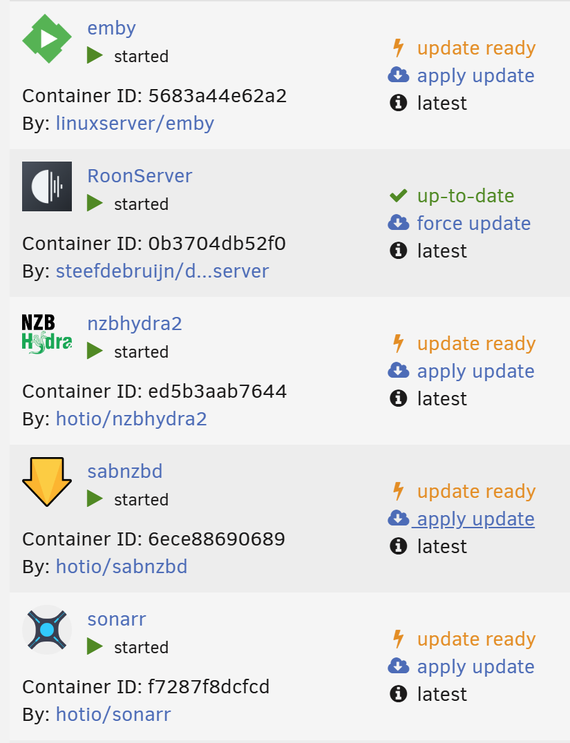

Most of my containers will not update.  Here is screen shot after doing "update all".  Only RoonServer updates correctly.  All the rest still say "update ready".
Do they update if you do a manual docker pull, like other users mentioned a few posts above?

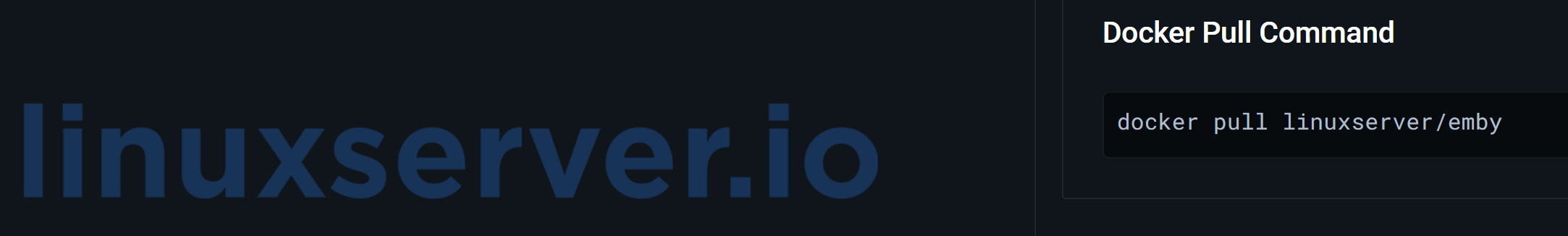

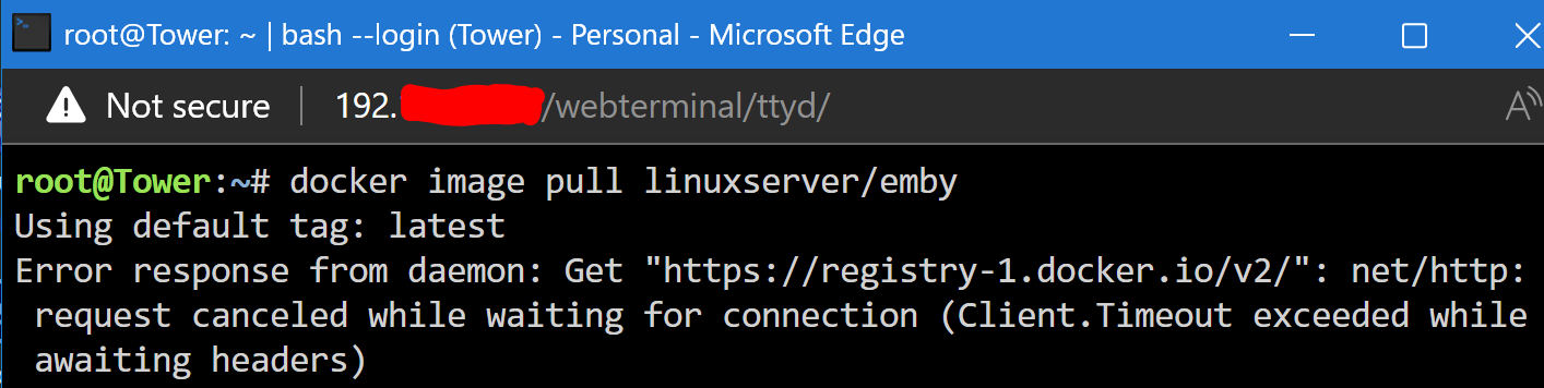

This is the first time I used the shell.  For the first words, I tried both "docker pull" and "docker image pull" and got same error response:
The address may not be complete, click on the docker image, then edit, and make sure you are using the full repository path, e.g.:

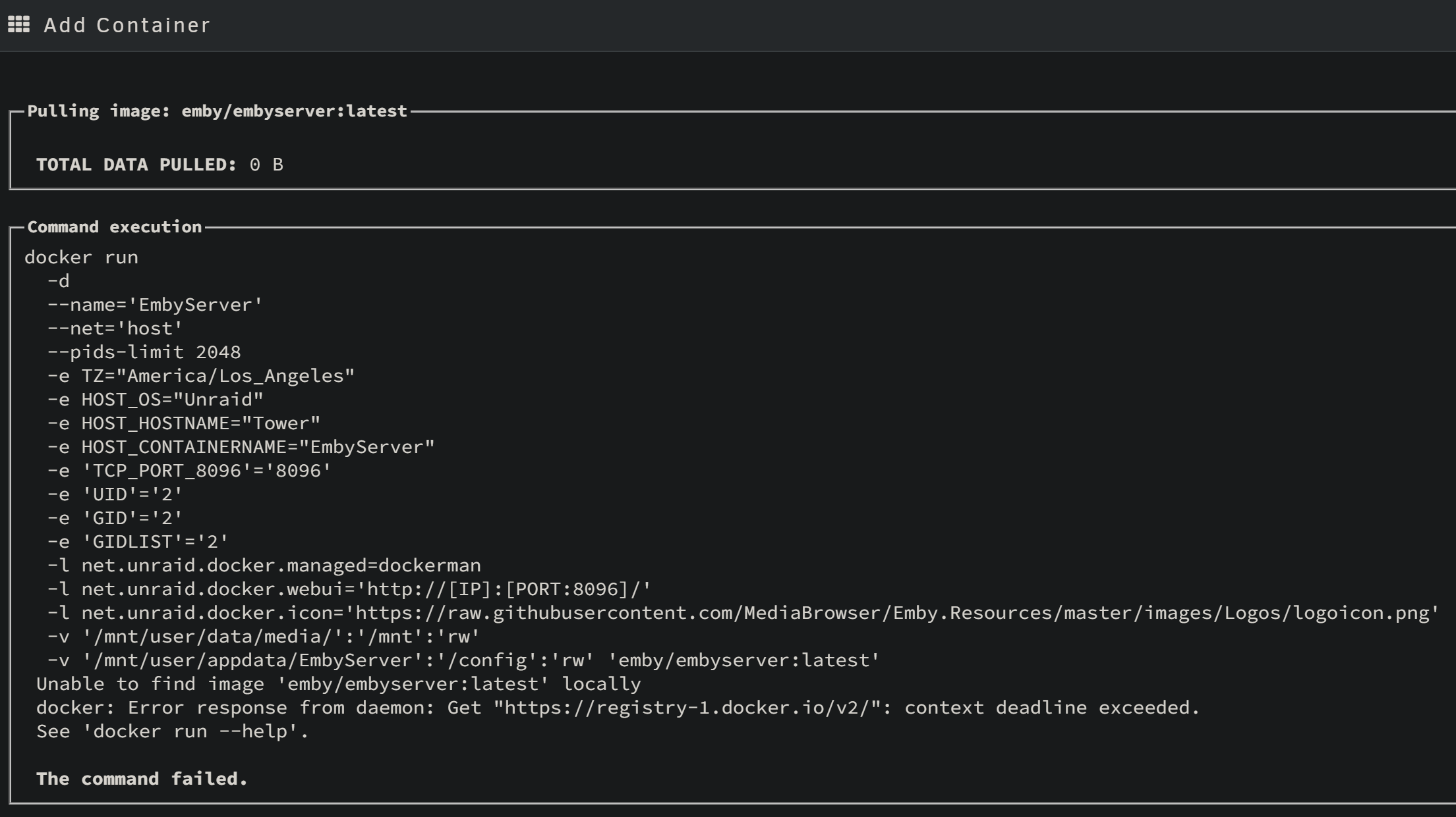

I tried installing a different emby repository - the official one from emby, and I got this error message:
Hello all, @xrqp i am not sure it's related to our problem even if symptoms seem to you related, it'd seem it is a throttling issue from docker hub : https://docs.docker.com/docker-hub/download-rate-limit/

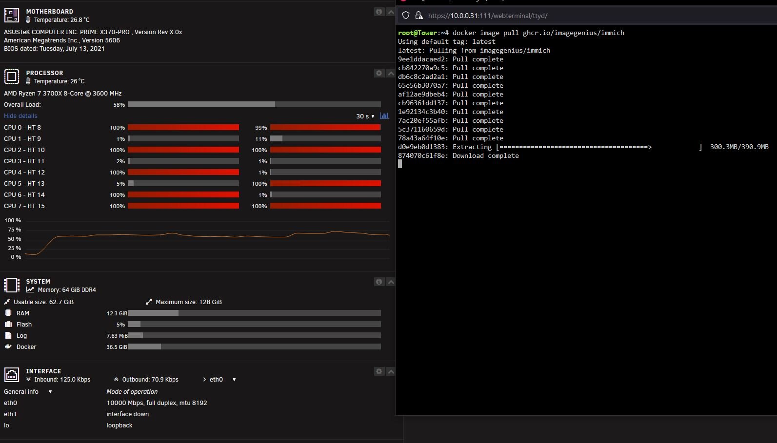

i have the same issue, i confirm that when you manually pull the image that you can update the docker.
But what is very wierd is that the cpu while downloading/extracting goes crazy on load..
I have also an HBA but with a S-ATA controller. I will test if the update works, if i install the SSD directly into the motherboard.
