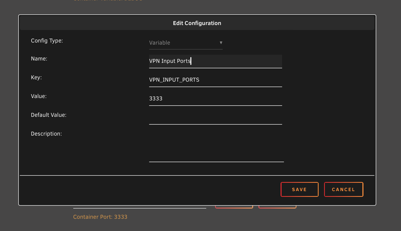

Did you also add it to your VPN_INPUT_PORTS list?
I don’t have that variable in my qbittorrentvpn docker template. Can you post a screenshot so I can add it?
Edited by wgstarks

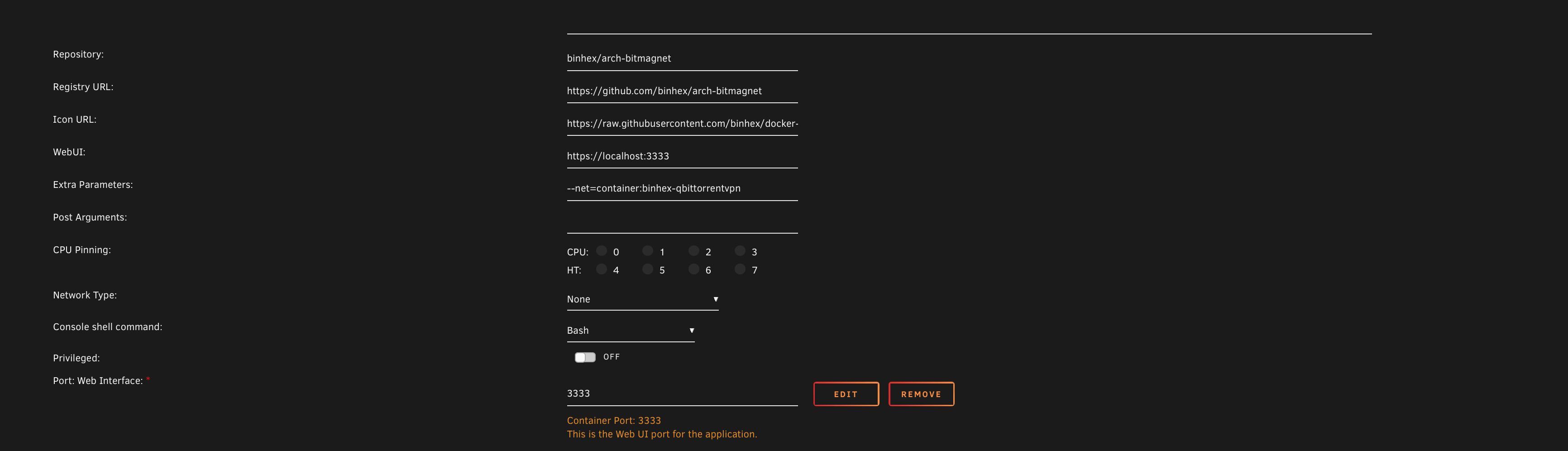

I added that variable and changed WEB_UI to localhost:3333 as dictated in the FAQ but still no dice. Also attaching supervisord.log since I'm seeing errors there.
qbittorrentvpn-
bitmagnet config-

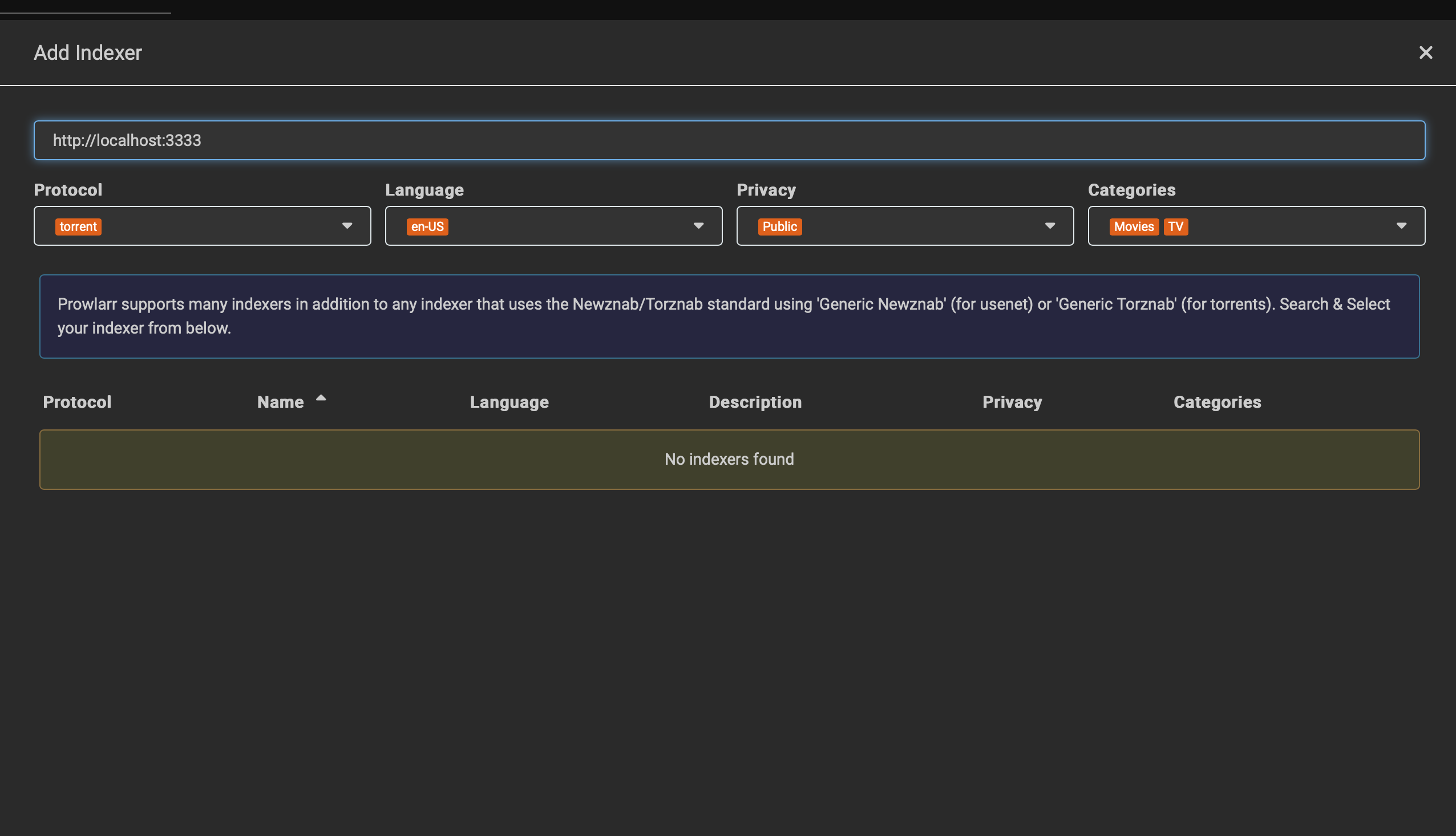

But if you do want prowlarr to talk to bitmagnet then you will need to use the ip address of your server NOT 'localhost', you only use localhost if you are performing communication between two applications inside the same (vpn) network, so this is wrong:-
From the FAQ:-
Please keep in mind that when defining connections from an application to another application in the same VPN container network that you will need to set the host to 'localhost' and NOT the LAN IP address,
This is not the case for you (as things currently stand).

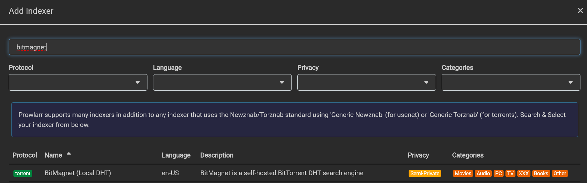

One other comment, from your screenshot it looks like you are making things a little more complex than they need to be, prowlarr already has a pre-defined index site for bitmagnet. no need to define custom:-

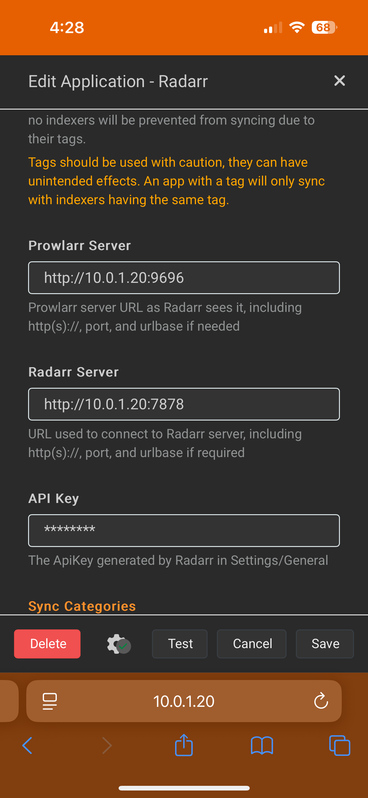

If I test the Prowlarr indexers in radarr/sonarr the tests pass but Prowlarr is showing all apps unavailable. Doesn’t look like the sync function is working either.
Edited by wgstarks
If you go to settings, apps in prowlarr, do all your apps show up and test good?

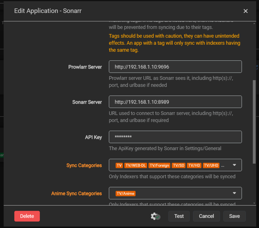

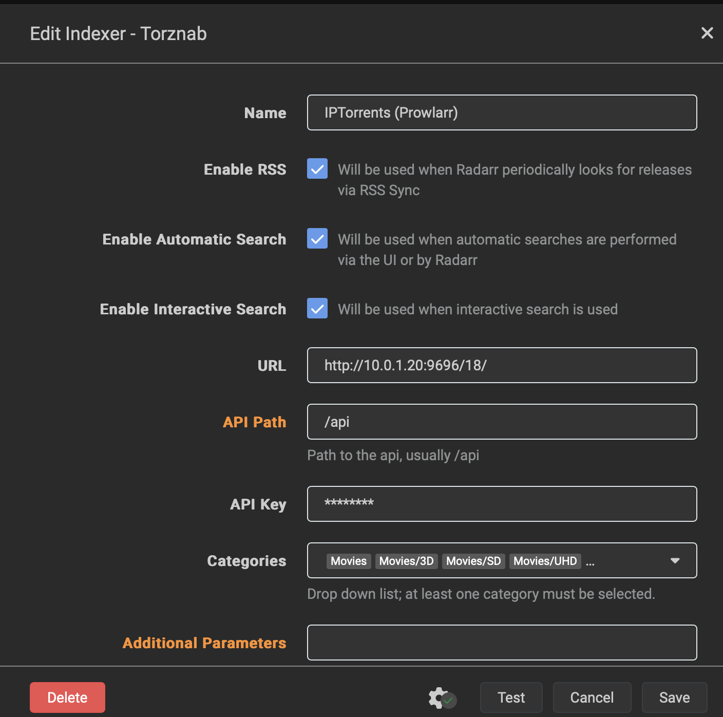

this is what my prowlarr app settings for sonarr look like, do yours look similar?:-
Also keep in mind you will need to permit prowlarr (inside the vpn) to talk to sonarr (outside the vpn), this is done by adding sonarr port to VPN_OUTPUT_PORTS list, like so:-
This is probably the problem.
Added the variable VPN_OUTPUT_PORTS with the proper values and it’s working thanks to @binhex and @JonathanM for the help.👍👍👍

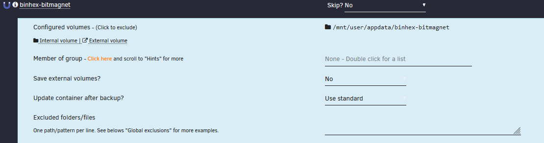

i use appdata backup plugin to back up my containers appdata folders.
i am getting the following error when it runs:
can someone help me correct this?  thank you!
Pretty sure you just need to specify an exclusion for that path. It's out of the ordinary for the normal way of doing things, so it trips up the defaults in the backup plugin. It does not ever need to be backed up, it's simply a way for multiple separate binhex containers to share information.
so in the "excluded folders/files" i just type "binhex-shared"  no quotes?
