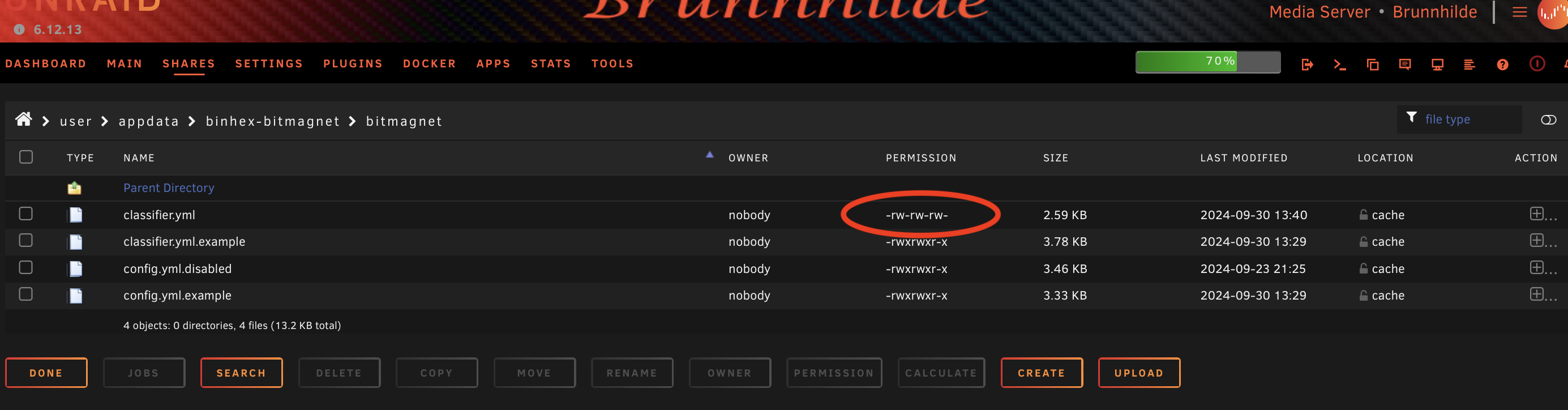

I installed the classifier.yml file using file manager to upload it. Noticed that permissions differ (not executable). Do I need to adjust this? If so how? File manager will set read/write but not executable.
51 minutes ago, wgstarks said:
Permissions look fine, classifier yml is a configuration file so it does not need to be directly executed
Also, noticed that my config.yml gets disabled when I start the docker after adding classifier.yml. Should this be happening? You can see it in the screenshot above.
Yes I forced the rename as you cannot have both config and classifier
Got it.
