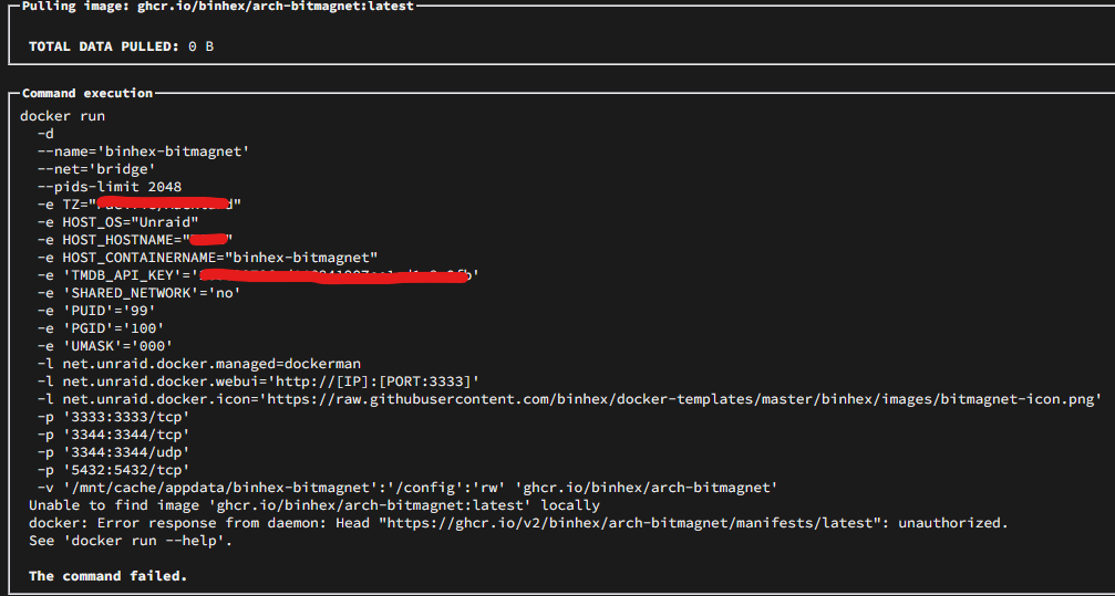

Hello there, whenever I try to pull the docker image (either from the community apps or from docker pull) it throws an error, if im logged in with my docker or github/ghcr.io accounts (access keys configured, etc) them its 'ghcr.io: response from daemon denied'. If I am not logged in, then its 'Docker error response from daemon: Head <ghcr.io url to image>: unauthorized'. I have had this happen with another binhex docker image too, overseerr, but the bedrock minecraft server and *arr dockers download perfectly fine. What is the issue here?
screenshot shows pulling arch-bitmagnet from community apps, NOT logged in to ghcr.io in dockerbinhex-bitmagnet-errored.thumb.png.fb11644114d45c9128b814d0955a2273.png
working on this too, also see the fix, i will let you know when all is fixed shortly.
EDIT - Fixed, please try pulling the image(s) down again.
Yep it pulls successfully now, thanks!
