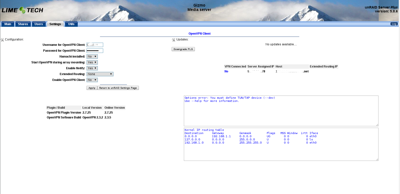

I am also getting same error as Crackus. I see error description in screenshot he attached to the post.
Options error: You must define TUN/TAP device (--dev)
Use --help for more information.
Thanks for your help.
-DJ
