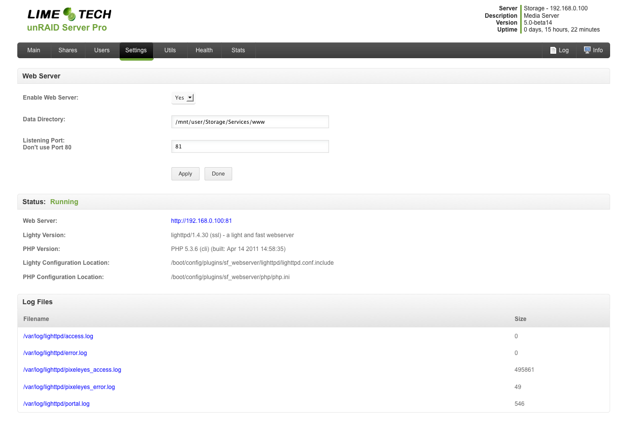

I've created a WebServer plugin for unRAID. It has production conf files for PHP & Lighty. It's all wrapped up into a nice and easy to use package, with a web gui and easy to access configuration files.
All dependencies (hopefully) met for default modules (GD etc). Tried to keep as modern as possible. The package size is just shy of 20Mb. Uncompressed the libraries total 67Mb. Works great with the MySQL plugin wondering around. The lighttpd.conf.include in the /config/plugins/sf_webserver/lighttpd folder can be used to hold your own custom configs & sites. Same thing with the php.ini file. Any changes you make will remain on reboot.
Download from Google Code: simplefeatures_webserver.plg
Requires unRAID Version 5 Beta 12 and above.
Make sure no other PHP packages (via unMenu, etc) are installed before using this plugin!
Features:
• Lighty Web Server 1.4.30: Light and quick web server
• PHP 5.3.10 : With all the bells and whistles
• WebGui Control: Stop/Start your web server, control which port & location. Check logs & version numbers.
Let me know what other features you might be wanting.

Our personal site is now being hosted by unRAID  :)  Port translation is a mighty wonderful thing. Server holding up over the last couple of days, no problems or memory leaks that I can see. Was worried the replacement PHP/libtool would affect the stock webGui, but hasn't appeared to have done so. If anything it's faster & better featured.
For anyone interested, response headers below:
Server SimpleFeatures - lighttpd
Transfer-Encoding chunked
X-Powered-By PHP/5.3.6
