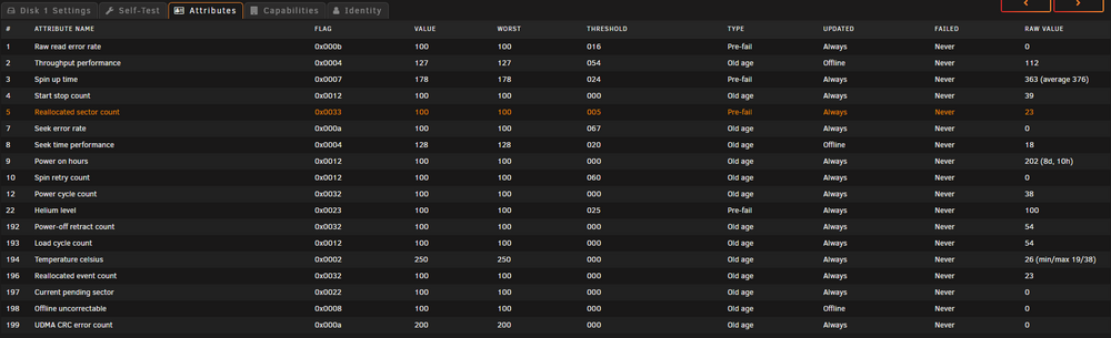

reallocated sector ct is 23 on a new disk
I keep getting
Unraid Disk 1 SMART health [5] reallocated sector ct is 23, started off at when I installed the drive and creeping up, I did google it and think I read somewhere this can be safely ignored and happen on modern drives?server-smart-20250129-1627.zip
Should I look to be replacing this drive even though its new?
