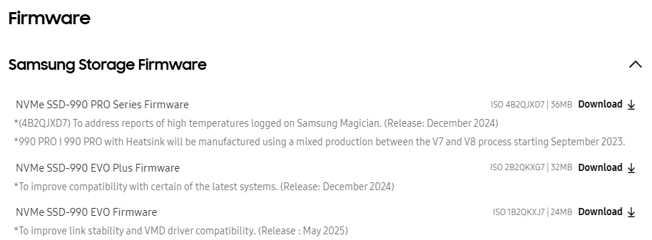

Update the firmware on the 990 pro to 6B2QJXD7 too. That's also supposed to help.
That firmware release has been withdrawn and no longer available publically
image.png pub
Oh interesting. I updated one of my drives in a two drive ZFS pool and it seemed to help. Haven't had any additional issues since doing so. Wonder why they pulled it.

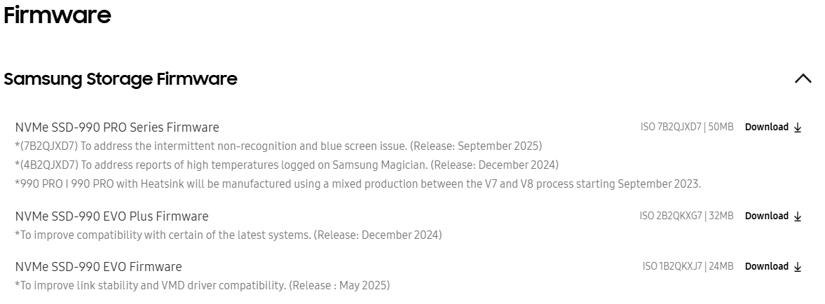

Here to say I'm having the identical issue. same drive 990, same issues..
looks like there is a new firmware release with a potential fix, I'll try it next time I'm doing server maintenance.
Thanks for the heads up. I've just updated both the 990s that make up my mirrored cache drive.
After my primary drive disappeared again on 27th of June, I restarted the server and not had either 990 drop out since then. But it's not been good knowing that one or both drives could drop out at any time, especially if high throughput is the cause as with them mirrored they were being hit simultaneously.
Anyway, I made it through a busy summer without issue, now hoping this latest firmware version finally, permanently resolves the problem. Will keep updating here if anything happens.

Started having similar issues a few months ago.
I have two 990 pro bought both in 2023, updated to firmware 4B2QJXD7 before installing them in unraid.
One is for appdata + docker.img while the other one acting as a temp cache
temp cache was fine i think but the one for appdata and docker would just drop and be inaccessible until a restart was made, both on unraid 6 and 7
Just updated the firmware to 7B2QJXD7 hoping that solves it
