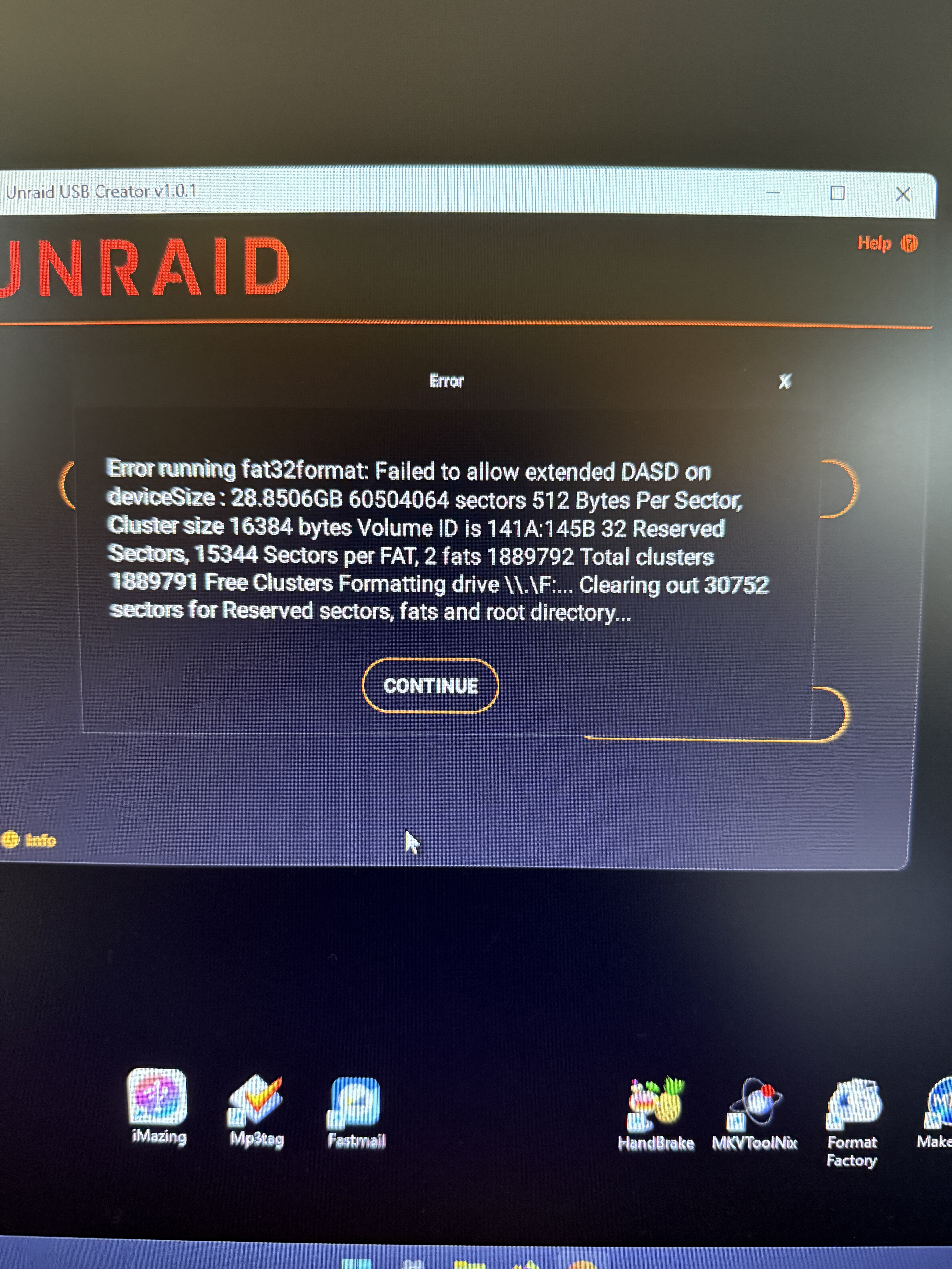

The USB Creator is terrible, no matter what I do (in order to replace my old flash drives)
I keep getting the below message.  I wish there was a better way!
Any suggestions? My walls are getting dented from banging my head on them lol..
