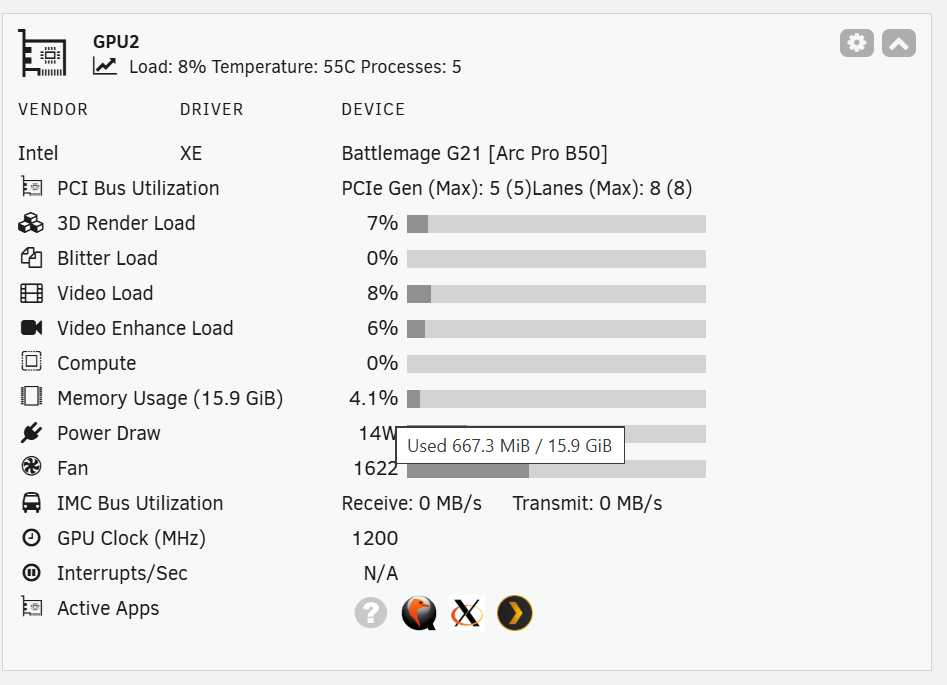

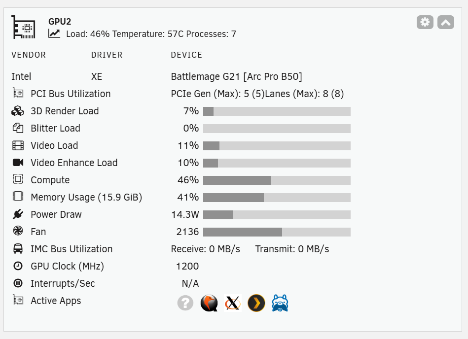

GPU Stats is limited on XE I am working on integrating qmassa
WIP So far for XE - Question mark is NVTOP. Working on Bus sizes and bar usage. Hoping to have an initial release this weekend.
With Ollama running SpaceInvaderOne Testing
Give release 2026.05.08 a try for XE additional stats. This is the initial release and may need tweaks going forward.
