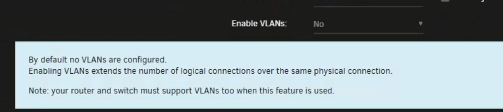

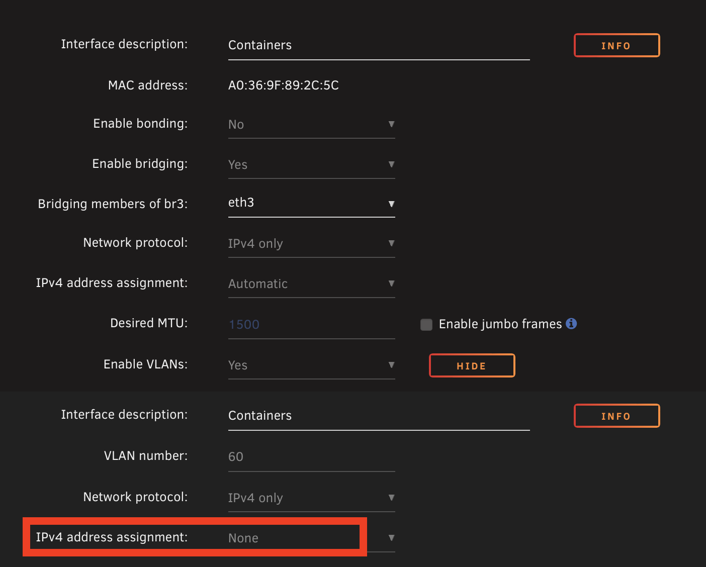

I'm not sure if this is what you're asking, but i've had many containers setup like this and they'll just get an IP address on the network/VLAN and then setting up the port forwarding is just like any other IP on the network.
I solved this by enabling vlans in the network settings on the interface, and then in the docker settings i enabled the network. Then when chose the VLAN network when creating the docker container.
I don’t recall if I tried that or not. I will check later and see if I can get it to work.
Exactly what I did. I created a Docker VLAN in Unraid (br0.3) and a Docker VLAN in Unifi network. I assigned docker containers an ip address manually in the range of 192.168.3.100 - 192.168.3.150. I did not use DHCP in Unraid VLAN.

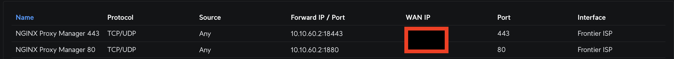

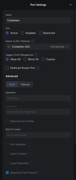

I tried it again but it did not work. Here is my configuration in Unifi for port forwarding. What I'm I missing?

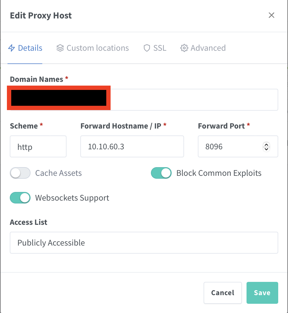

This is the setting in NGINX Proxy Manager for the host domain.

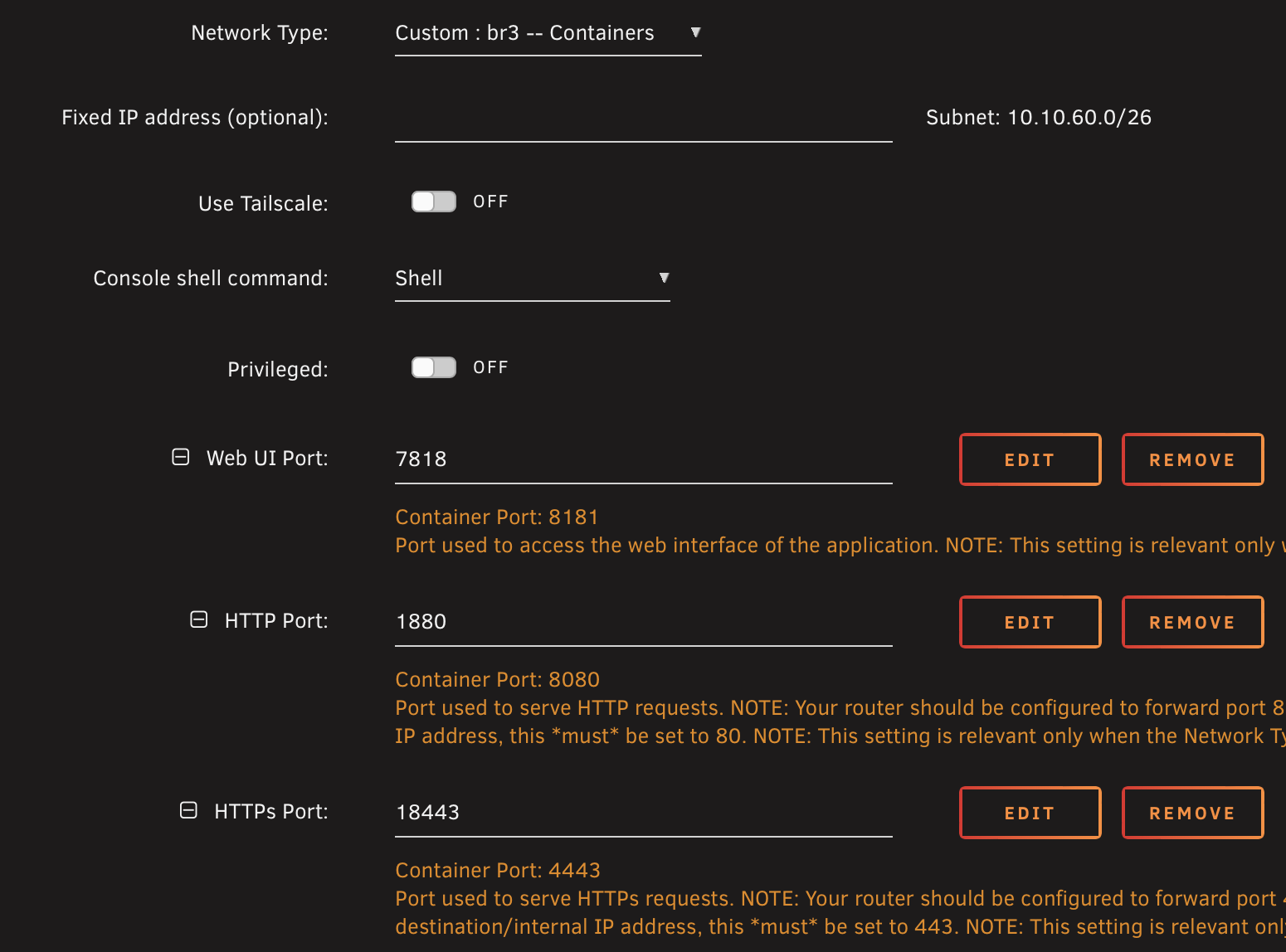

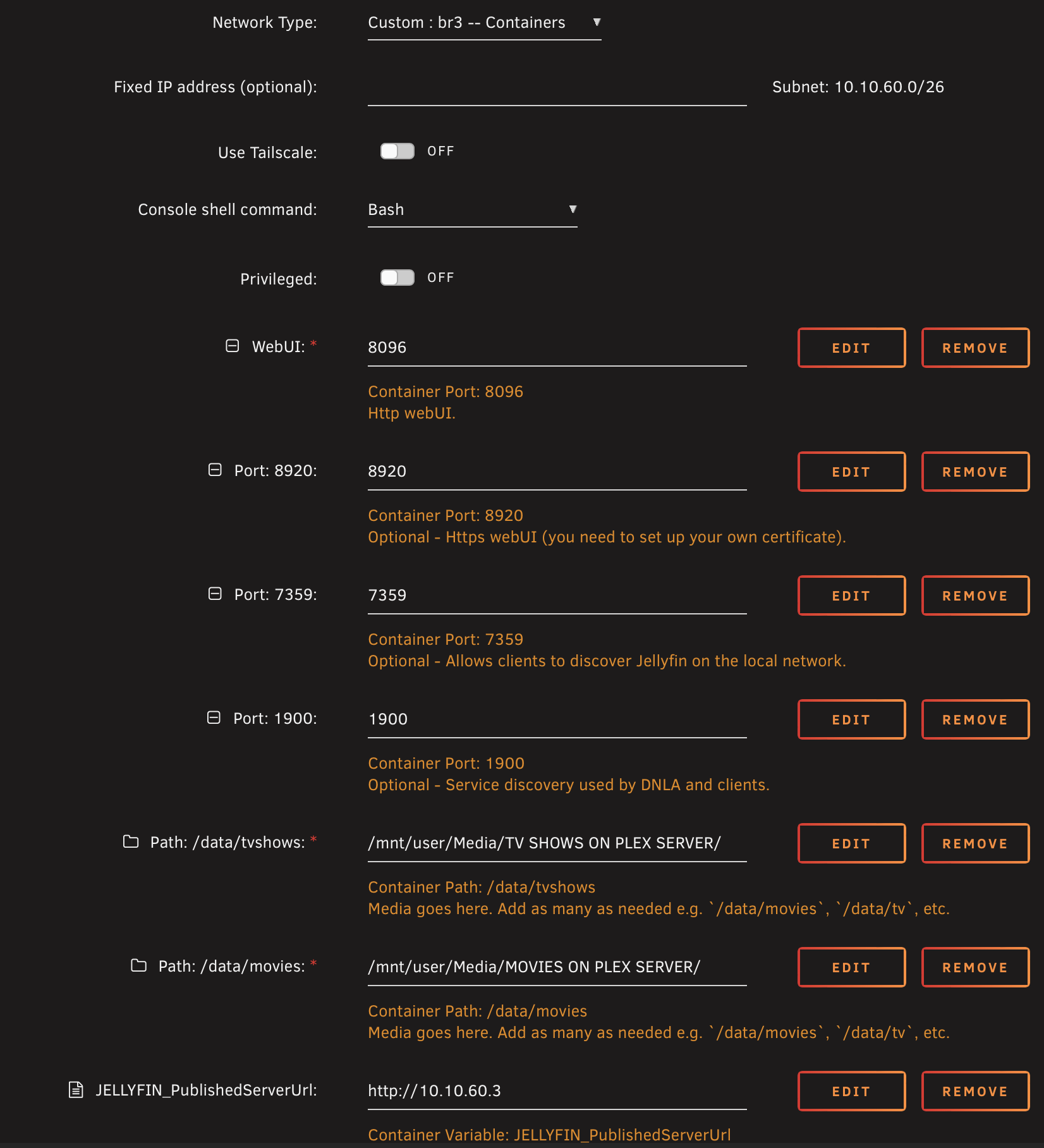

NGINX Proxy manager Docker template. IP Address 10.10.60.2
JellyFin Docker Template. IP Address 10.10.60.3

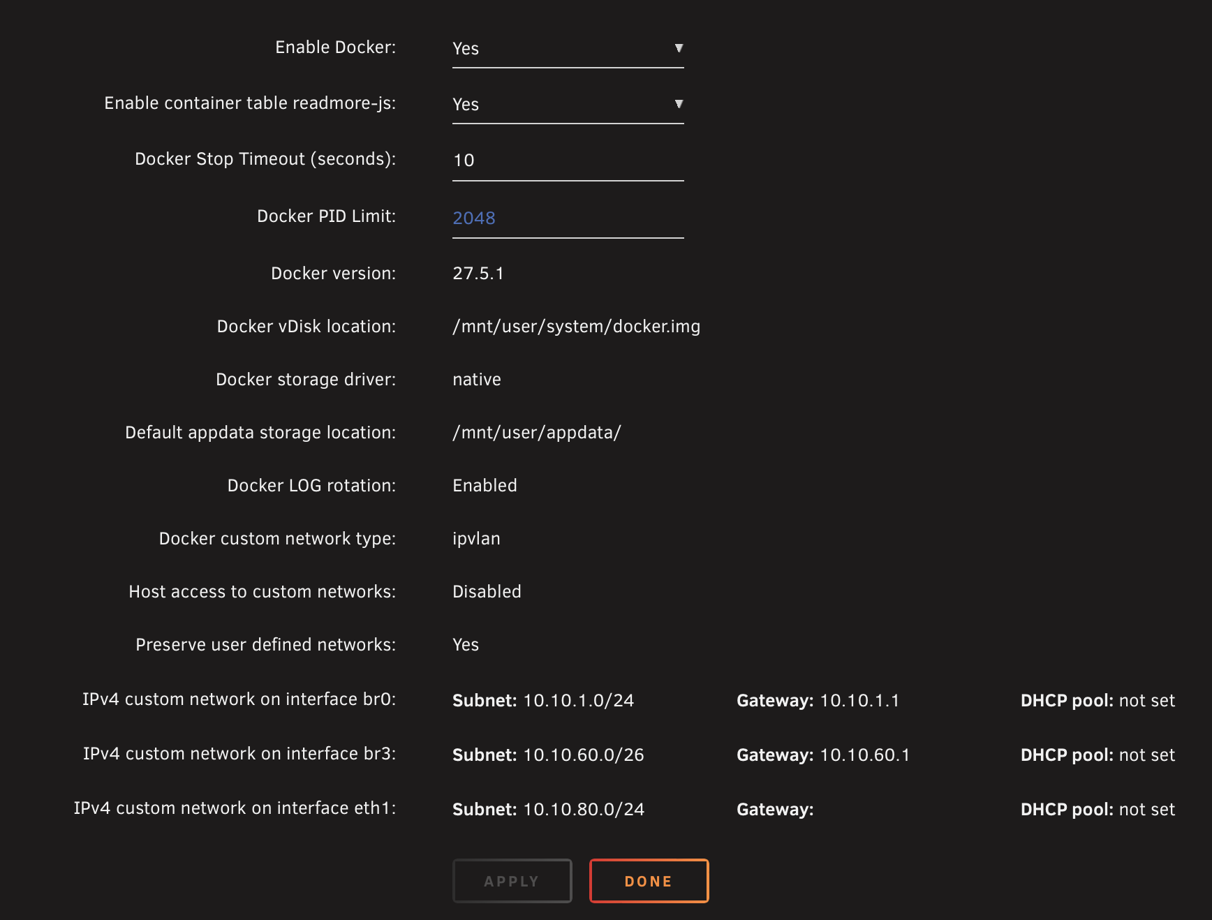

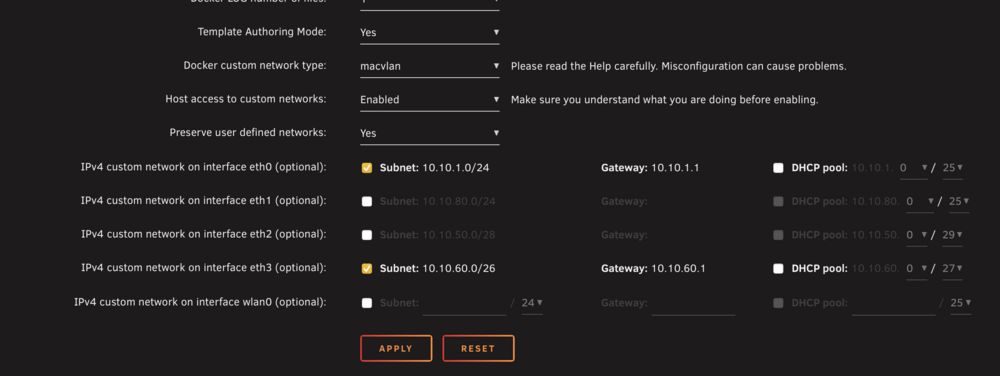

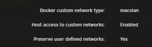

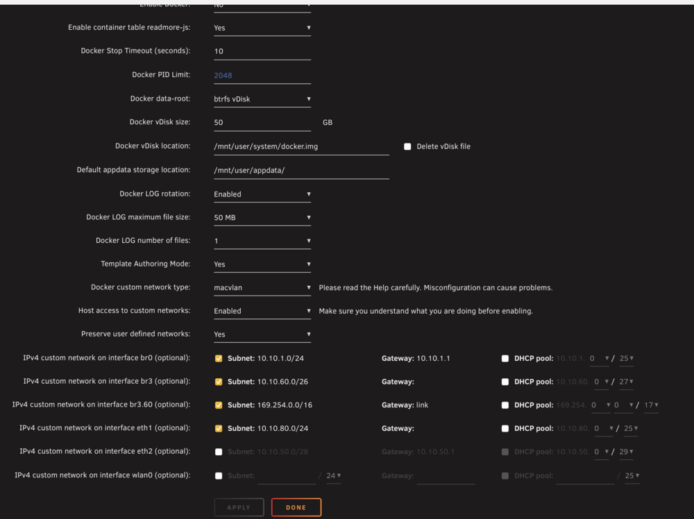

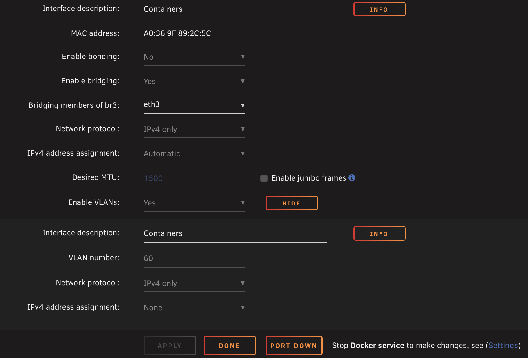

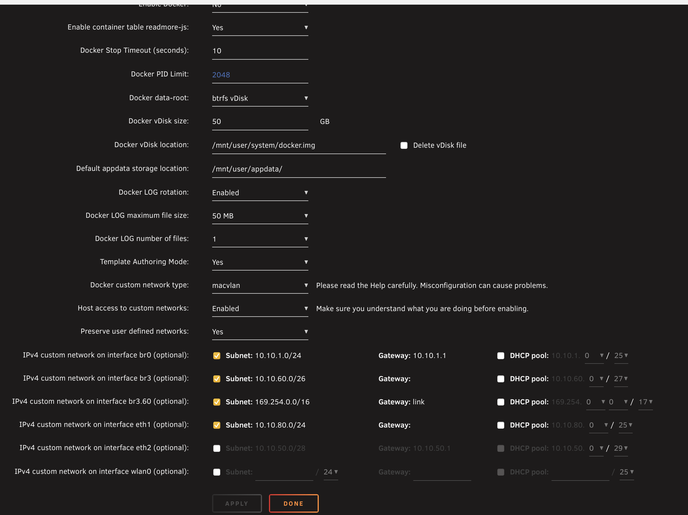

Network Settings.
Docker settings.

I can only assume network misconfiguration and docker network misconfigurations...
nginx is in what docker network as this is possible...
Would need unraid vlan network layout and unriad network setting layout to further assist...
Since Vlan.. I would suggest making your own custom vlan docker network at br0.vlanID# and assigning nginx a custom ip via the docker network vlan creation...
not enoth info to assist. can only give generic info then...
this is becasue your npn docker netowrk is sill using vlan 1 as you passed br3 to the continer
when you need to make a docker netowrk (preferable macvlan...) and use the bridge interface and valn id nubmer
npm shoudl be using something like br3.2 whcih uses vlan 2 as example...

with all dockers off i need the output of ip a
I need to know the vlan IDs that you have setup (so I can give you the corect comands and docker network on how to get it working...
I need to know what vlan and IP npm needs to be set too
then I will glady infomr you where and what settings where broke and how to fix

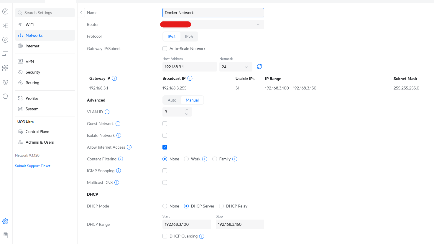

example pulled form unifi settigns overview I need to knwo the vlan ID and subnet
-As you can see I use the subnet to also help inform the valn so vlan 42 will be 192.168.42.x
In your case, I need the VLAN ID that is subnet 10.10.60.0/26
ok and what ip of the docker that npm can also access to be a Reverse prxy in what vlan ID that in unraid.
as npm will need to be able to talk to xyz dockers on unraid or on lan to be a RP over the vlan.
This will dictate docker nework setting for nginx and others.

The VLAN id is 60. The NPM and JellyFin are both in the same network 10.10.60.0/26.
Does this setting needs to be setup to Automatic?
It can I would to allow unifi the abilty to assgin a dhcp ip over that vlan on unraid. no not techanly necessary.
What unraid version are you running?
general basic guide setup. Pre-setup instructions...
Docker settings are
Docker network > macvlan
host enable access to custom enabled
preserver custom networks enable:
Macvlan is needed for mac address latter... due to vlan intreractions.
-while posbble I ahve issues with ipvlan docker netowrk and teh use of vlan them selves...

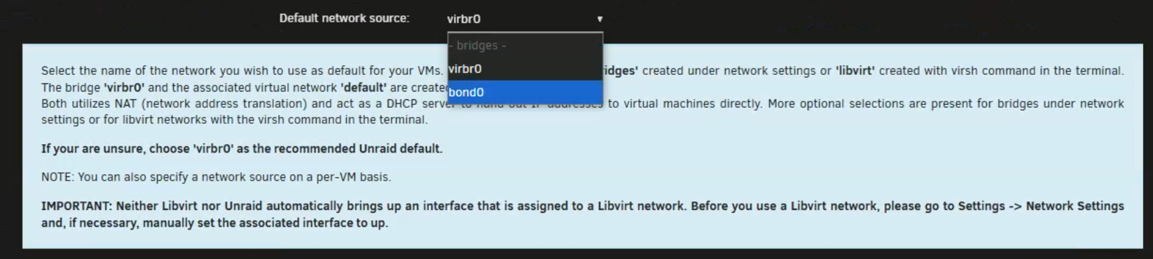

in VM settings make sure it is not virbr0 this adjust are docker vhost0 / shim-brdge network that we will be using...
and under Unriad network setting you have enabled vlans.
Please make sure these settings are set I now have enother info to generate teh needed infor for termainl comands to make the necessary docker netowrs to use with npm

I changed the settings to MacVLAN and host access to enable and also the preserve was set to yes. Now I see that br3.60 is getting the 169.254 ip address.
OK Here is what I understand form the post overall interactions:
Goal Summary:
  • VLAN 60 is on interface br3.60 (associated with eth3.60)
  • Subnet: 10.10.60.0/26 (range: 10.10.60.1 to 10.10.60.62)
  • br3 already has IP 10.10.60.11 in that range
  • You want NPM and Jellyfin to be accessible within that VLAN (ideally NPM reverse-proxies Jellyfin)
  • Containers need to be attached to a macvlan network on br3.60

Double check and Configure NPM to Reverse Proxy Jellyfin:
Once NPM is up:
  • Go to http://10.10.60.21:81 (NPM UI)
  • Log in → “Proxy Hosts” → “Add Proxy Host”
  • Set:
    • Domain Names: (e.g. jellyfin.local or real FQDN)
    • Forward Hostname/IP: 10.10.60.20
    • Forward Port: 8096 (Jellyfin default)
    • Enable SSL (if needed)
    • Optionally add access lists or cache settings

Here is my docker network.
root@Tower:~# docker network ls
NETWORK ID NAME DRIVER SCOPE
ed036bb9b6d1 br0 macvlan local
6323836f8922 br3 macvlan local
065a67fd4699 bridge bridge local
4a0546e90094 eth1 macvlan local
bfa58ee9ccb5 host host local
e2b5c5604762 none null local
afd014fe03db proxy-network bridge local
Edited by Tucubanito07

Okay now I got this.
2c0d737c23b6 vlan60_macvlan macvlan local
perfect this tells me that you have a unraid docker network that is using and on vlan 60

Now its on to editing the dockers tempalte to the new docker network in the drop-down list.
Please edit npm and select custom vlan60_maclan
you will need to set a ip statical here as well
you will need to set the same for jellyfin
