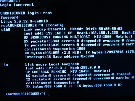

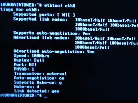

Here is the ifconfig, and ethtool the print is before the video pause (crash) the pics are from after the crash
root@UNRAIDTOWER:~# ifconfig
eth0      Link encap:Ethernet  HWaddr 04:4b:80:80:80:03
          inet addr:192.168.1.66  Bcast:192.168.1.255  Mask:255.255.255.0
          UP BROADCAST RUNNING MULTICAST  MTU:1500  Metric:1
          RX packets:27878 errors:0 dropped:0 overruns:0 frame:0
          TX packets:34191 errors:0 dropped:0 overruns:0 carrier:0
          collisions:0 txqueuelen:1000
          RX bytes:2229009 (2.1 MiB)  TX bytes:132268528 (126.1 MiB)
          Interrupt:26 Base address:0xc000
lo        Link encap:Local Loopback
          inet addr:127.0.0.1  Mask:255.0.0.0
          UP LOOPBACK RUNNING  MTU:16436  Metric:1
          RX packets:8 errors:0 dropped:0 overruns:0 frame:0
          TX packets:8 errors:0 dropped:0 overruns:0 carrier:0
          collisions:0 txqueuelen:0
          RX bytes:560 (560.0 B)  TX bytes:560 (560.0 B)
root@UNRAIDTOWER:~#
root@UNRAIDTOWER:~# ethtool eth0
Settings for eth0:
        Supported ports: [ MII ]
        Supported link modes:  10baseT/Half 10baseT/Full
                                100baseT/Half 100baseT/Full
                                1000baseT/Full
        Supports auto-negotiation: Yes
        Advertised link modes:  10baseT/Half 10baseT/Full
                                1000baseT/Full
        Advertised auto-negotiation: Yes
        Speed: 100Mb/s
        Duplex: Full
        Port: MII
        PHYAD: 1
        Transceiver: external
        Auto-negotiation: on
        Supports Wake-on: g
        Wake-on: d
        Link detected: yes
root@UNRAIDTOWER:~#

Can you give some more info on the devices in your network? There seems to be a 1Gbit NIC working at 100Mbit.
Switch or cabling perhaps?

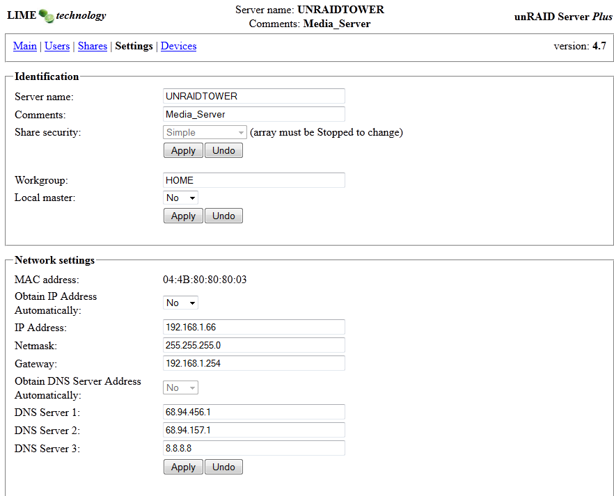

Do you have your unRAID server SMB  (samba)  (I assume that your issues are in Samba) as a Local Master?
I don't think I have ever played around with SAMBA??
He's talking about on the main page, select settings.  Then in the identification section, there is a selection called:
Local Master  and you can select Yes or No.  This is for which device on your network is the device that maintains the list of available resources.
I had to change mine to Yes to get it to work, which is odd as it used to work with this set to No originally.
Try setting it to Yes.
I set it to yes, and it lost connection even with nothing playing or accessing the server
Switching local master  to yes, cause it to lose connection even when nothing was using the server

Here is the unraid settings
