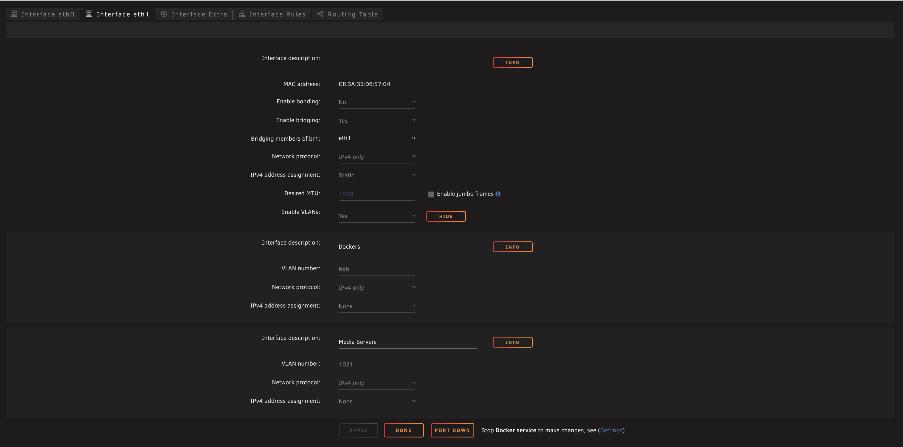

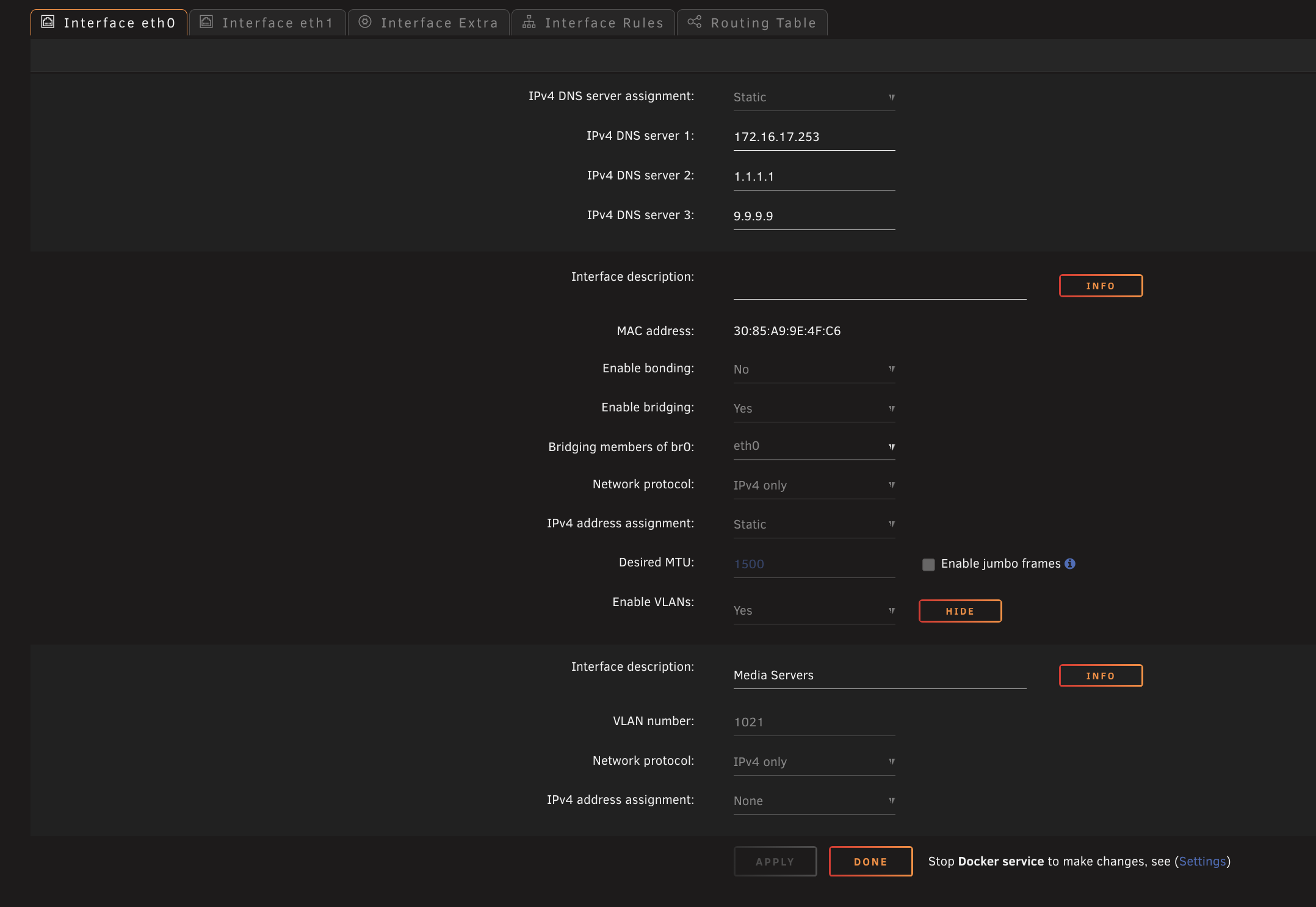

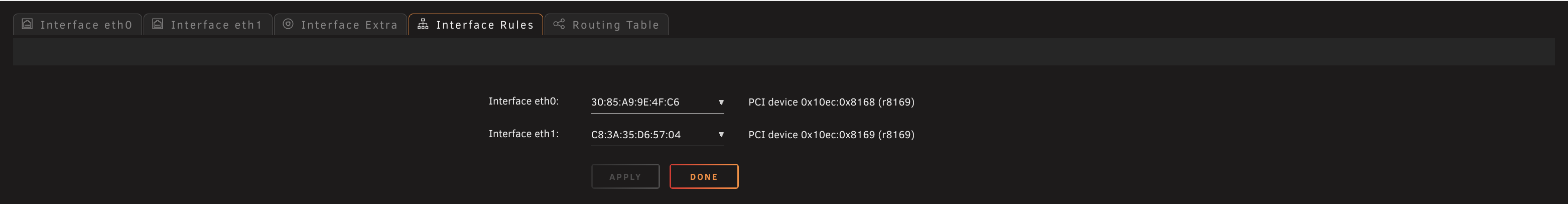

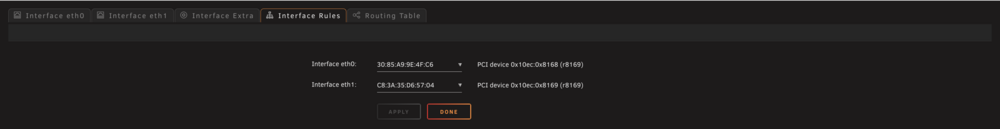

I have some confusion about now unRAID is handling network adapters. I have two, physical adapters configured as follows:
eth0 - plugged into port 15 on my switch, configured with 172.16.17.252
eth1 - plugged into port 16 on my switch, configured with 172.16.17.251
Now, when I disable either of those ports on the switch, BOTH addresses will still answer. It's confusing to me, as I would expect one link to be down (unRAID says it is) but yet both IPs answer to pings. Why I'm confused is that I want to setup a VLAN for my Dockers and also segregate network traffic coming in on either interface from media servers (eg, some map NFS via .252 and some via .251 for primitive "load balancing").

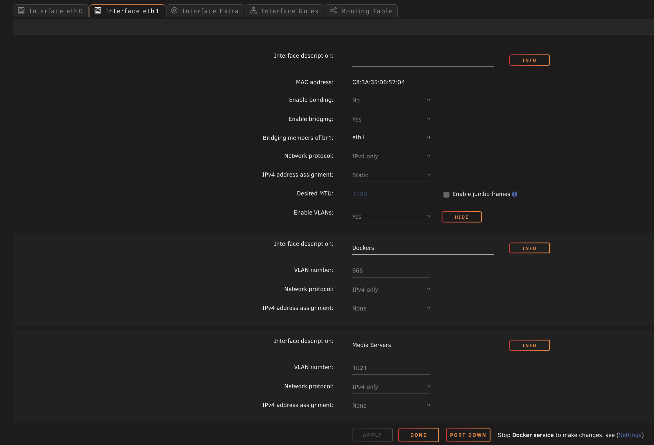

I have the Dockers VLAN (666) setup as br.1 on eth1 and it's working... but I just don't know if it's sending over BOTH interfaces somehow as all traffic seems to traverse even if the port that .251 is plugged into it disabled. If I disable BOTH ports then all traffic stops, as expected.

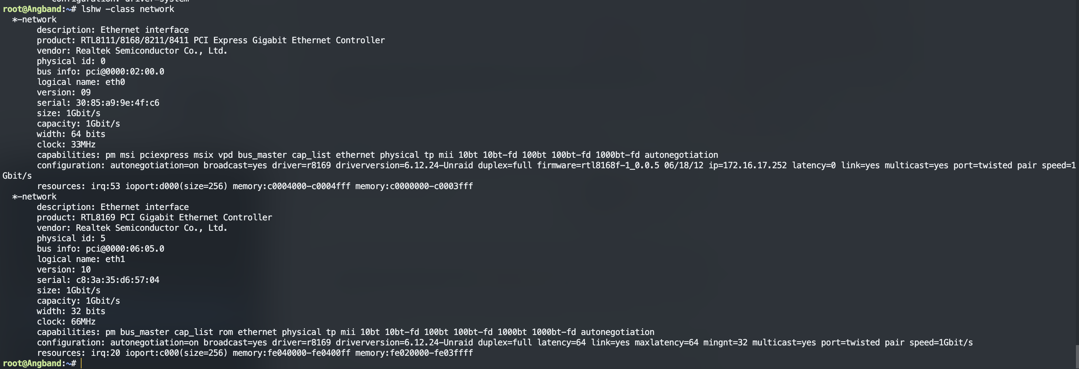

Here's the hardware output and unRAID screens... I will attached logs / diags as well in case those help. I am just confused, and it's HIGHLY likely I'm just dumb :)

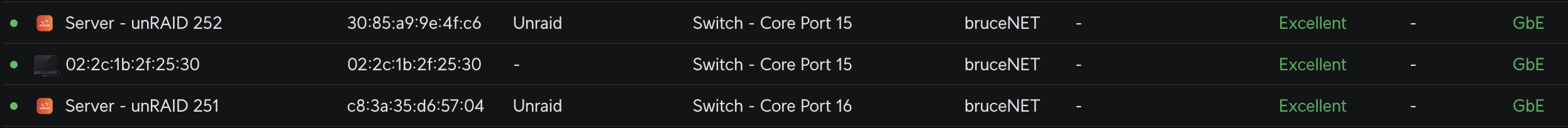

There is something interesting, the switch shows a third MAC address attached to port 15 ... not sure what this is or how it's being used.... image attached.
*** I think this is solved, I enabled bridging on eth0 and that mac went away, it was being added as vhost0, after enabling bridging on eth0 this went away ***

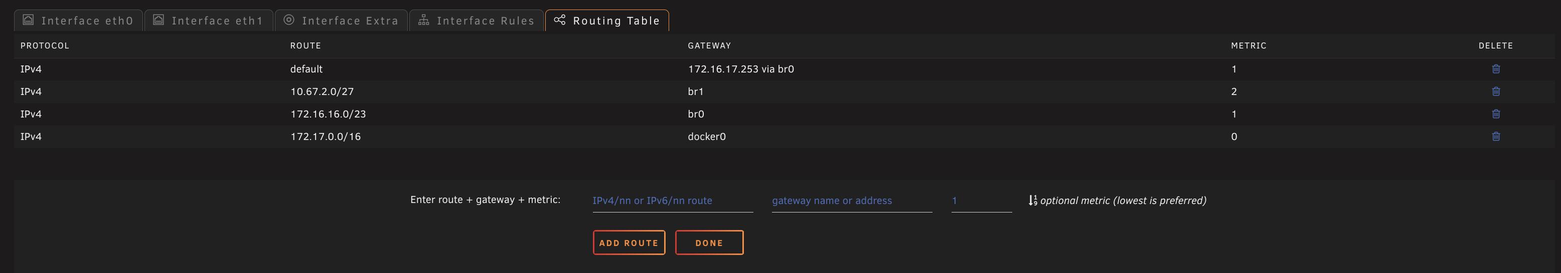

eth0 toook primary as in linux you can't have 2 nics on teh same subnet.
run iproute. You will see that the subnet for 172.16.17.252 is set for routing the 172.16.17.0/24 thus any ting on unraid trying to reach the 172.16.17.x lan will use eth0 per the data of the iproute
*This is where you would setup bonding...
UNRIAD is not networking equipment! ...
further, you have Linux networking in unraid issues with tagged vs untaged...
"I have the Dockers VLAN (666) setup as br.1 on eth1 and it's working"
for the unriad interface to correctly use vlan 666 the interface needs to be setup and made as br0.666 and or eth0.666
In network setting in the web ui make sure you enable vlans and add valn 666. Unless your using a layer 3 switch and doing weird vlan cross talk br.1 is a network misconfiguration...
so whats your end goal here???

Thank you for your thoughtful and quick reply, remember when I said "there's a huge chance I'm just dumb" ?
It, of course, makes sense about the two NICs on the same subnet, I can see that now, thank you.
I wasn't trying to imply anywhere that unraid was networking equipment
My end goal was to see if I could segregate traffic between media servers - one going to NIC 1 and the other to NIC 2.
I had tried LACP and RR bonding (yes, my switch supports LACP) but I didn't really see much of a difference.
I also wanted to visualize how much traffic was flowing over either interface.

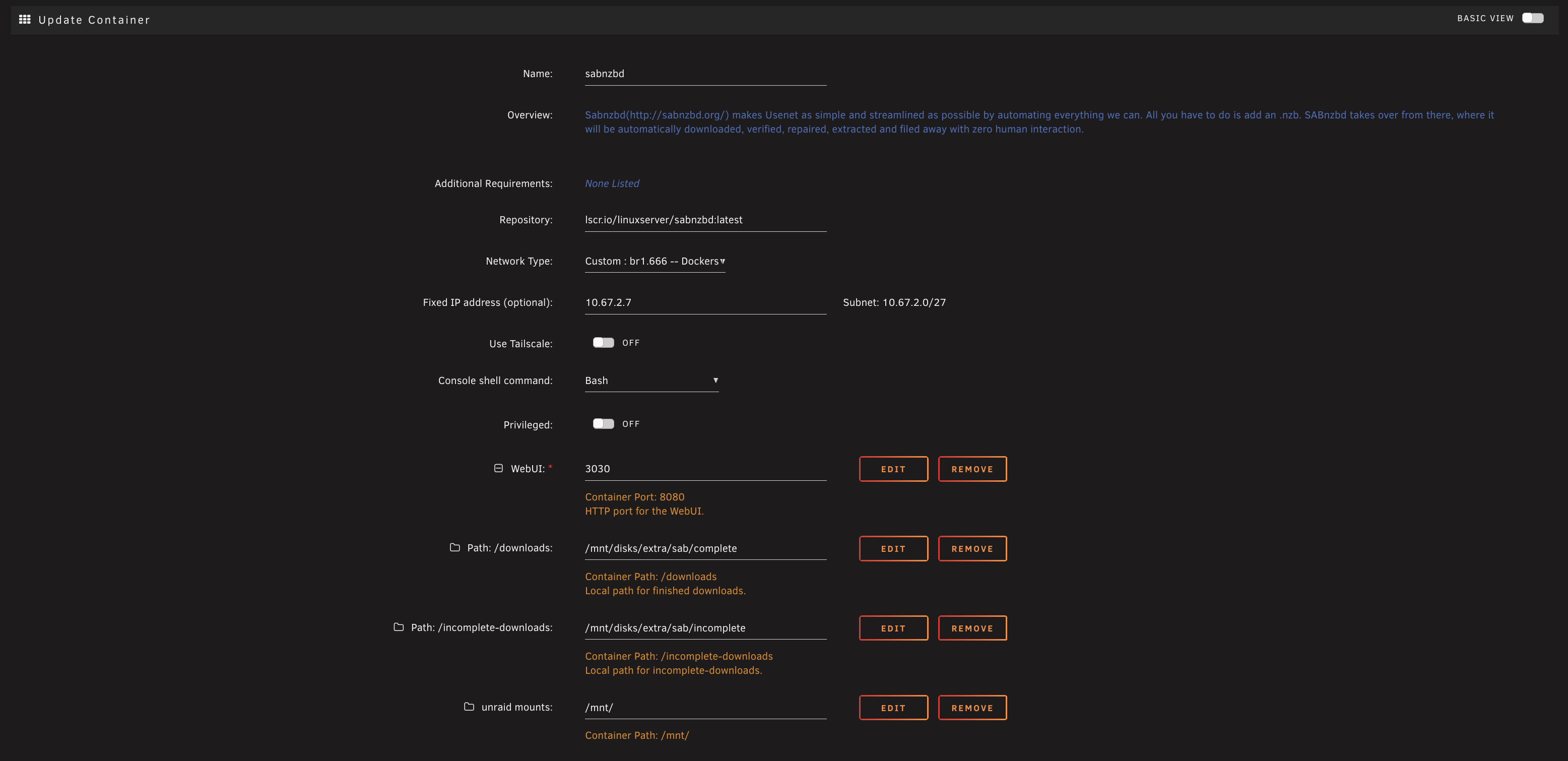

So, in the interim now, I set my eth1 to be 10.67.2.30 (the outside of my /27 range for the Dockers network on my router).
ETH0 - 172.16.17.252, VLANS (1021 for media servers)
ETH1 - 10.67.2.30, VLANS (666 for Dockers)
When I tested by downloading something, I can now see traffic flowing on the eth1 interface.
I'm aiming to isolate the heavy traffic of downloading away from the media serving, hence the two physical adapters on two separate switch ports.

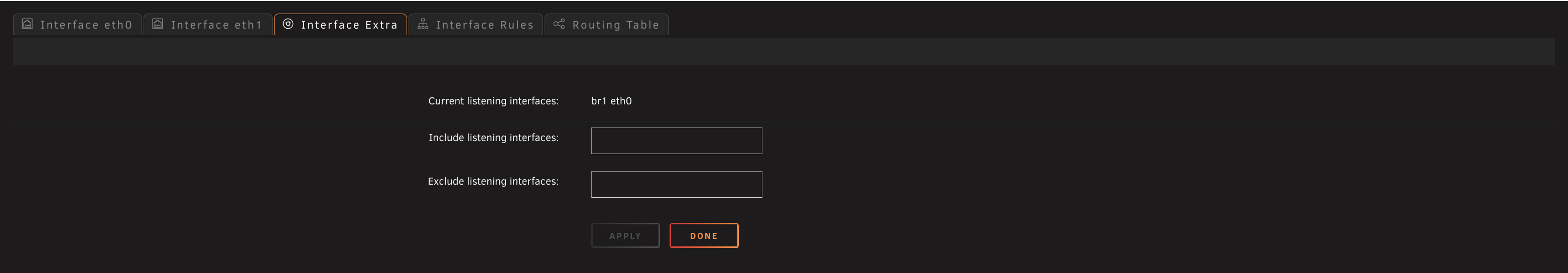

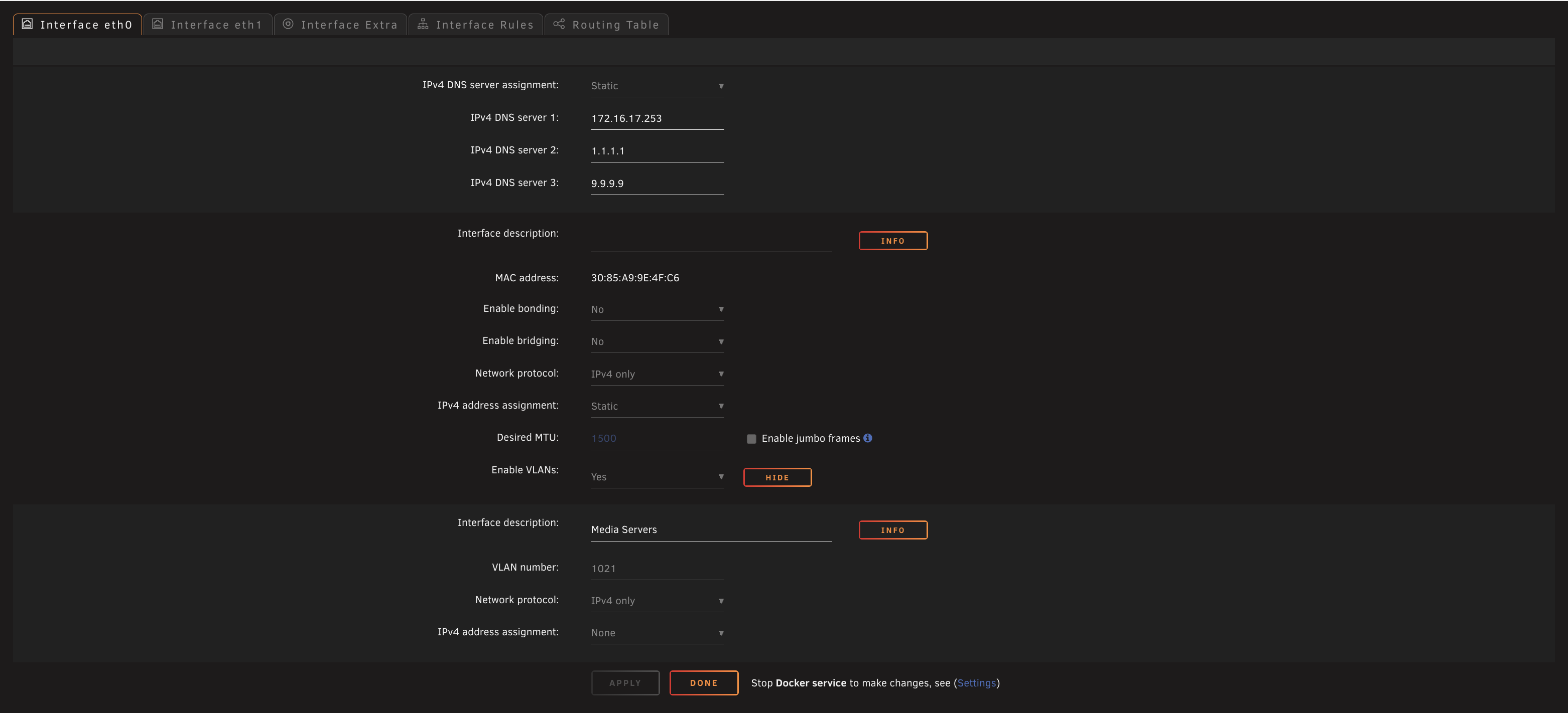

Thanks for clarifying, and I totally get being frustrated -- I am actually in IT and I know dealing with constant newb questions can get tired fast.
I'm not very strong in networking (trying to get better) and it's things like vlans etc where my brain starts to hurt.
To clarify I'm not using unraid for the streaming, only the NFS storage that the media servers pull from.
I have both NICs bound to the MEDIA SERVERS vlan (in case I want to move one server onto that physical NIC.
I attached screenshots so they make better explain what I'm not great at :)

ok, Is something not working in that configuration?
https://www.youtube.com/watch?v=0xk7LsWwp2I
https://www.youtube.com/watch?v=9Ta9e09KyYw
You may need to go to listening interfaces to edit what br0 is connected too...
the unraid webui affects eth0 / br0 depending on other settings.
thus the use of terminal and other command line commands to make another bridge interface for eth1 and tagged vlan.
an example is making a linux bridge our seves... no web UI as the Web UI is limited to what its interacting. This requires Decker setting preserver user defined enabled.

No things seem to be working fine. I can see media traffic on eth0 and docker traffic on eth1 now.
I am just concerned about saturating the eth0 now, lol. Perhaps I'll add another NIC at some point - or try to get some of the media servers onto eth1 too (just to offload a bit).
It's definitely made a difference during heavy download periods -- however, there was a point where eth0 was registering 1.2Gbps lol.
