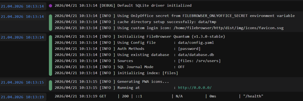

Strange my container still working fine , and cant see changes in docker hub :
ENV FILEBROWSER_DATABASE=/home/filebrowser/data/database.db0
ENV FILEBROWSER_CONFIG=/home/filebrowser/data/config.yaml

What is the status with noted error previously:
2026/05/19 10:14:33 [DEBUG] Default SQLite driver initialized
2026/05/19 10:14:33 [ERROR] unable to load config, waiting 5 seconds before exiting...
2026/05/19 10:14:38 [FATAL] error unmarshaling YAML data: [136:3] unknown field "defaultLandingPage"
133 | darkMode: true
134 | dateFormat: false
135 | debugOffice: false
> 136 | defaultLandingPage: ""
137 | deleteWithoutConfirming: false
138 | disableOfficePreviewExt: ""
139 | disableOnlyOfficeExt: .md .txt .pdf
140 |
I came back to a previously work but upgraded version I hadn't used in a bit and received this. I reinstalled and have the same error.
Update: Commented out offending lined relating to defaultLandingPage and appear to be up and running.
Update Jul/26 : Broken again. I suspect yaml but I am not expert.
Edited by goldbondx
