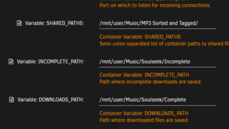

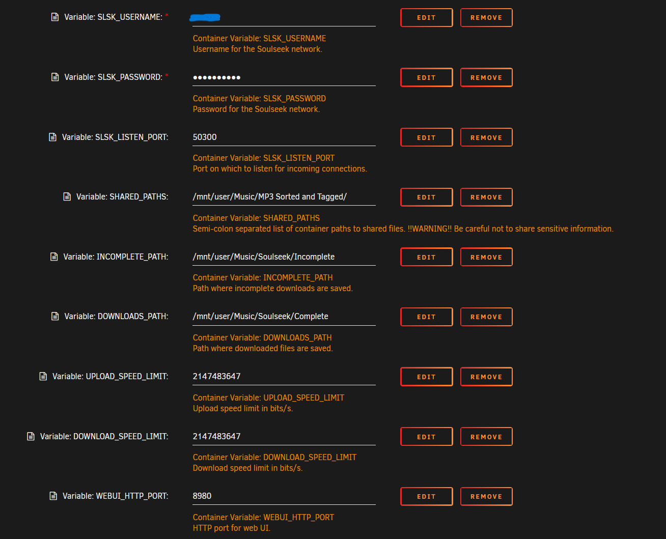

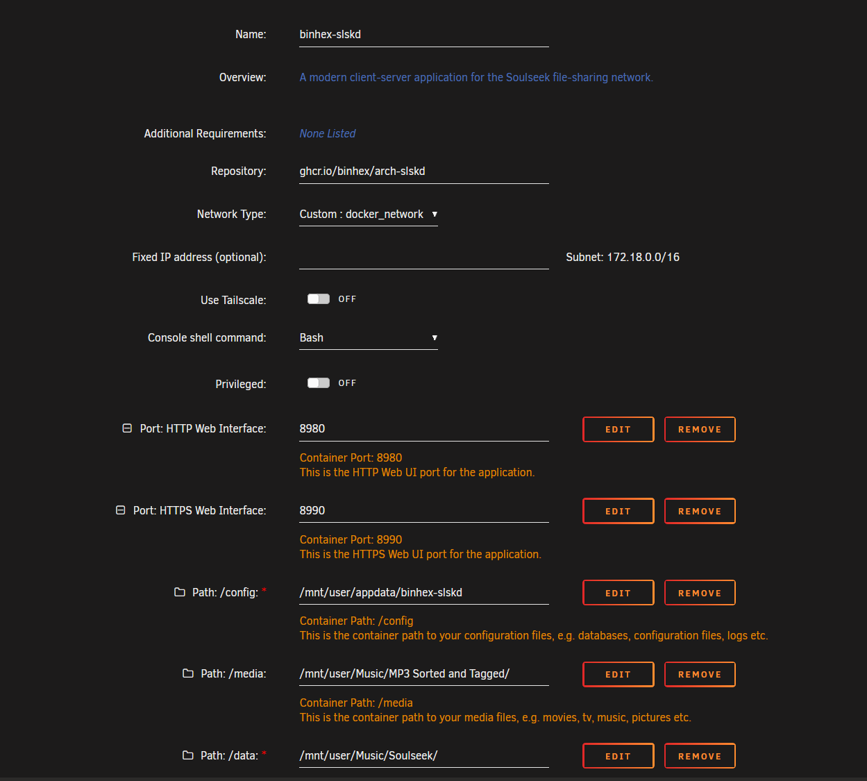

post a screenshot of the settings of the container (left click container select edit)
Absolutely! Thank you! I feel like I'm taking crazy pills!
Ive spotted your issue, this is it:
So what's wrong with that you might ask, well the paths specified here must be container paths NOT host paths, so for example (these are examples tailor to what you want):
SHARED_PATHS = /media
INCOMPLETE_PATH = /data/incomplete
DOWNLOADS_PATH = /data/completed
