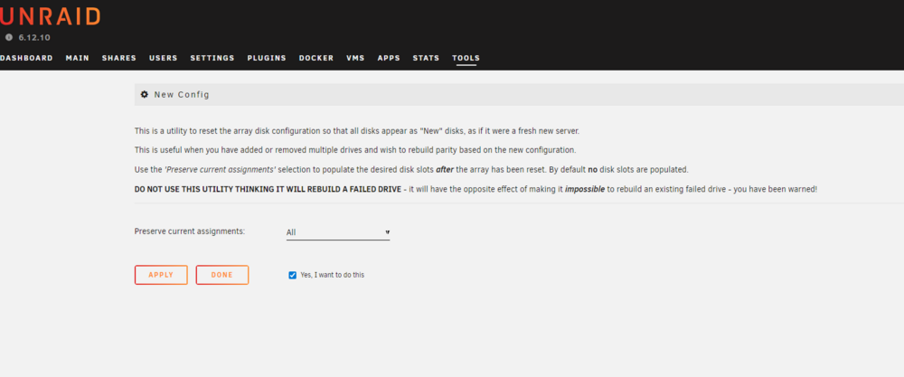

19 hours ago, trurl said:
Tools - New Config - Retain All - Apply.
If any drives are not assigned, assign them as before.
Check BOTH Parity Valid and Maintenance Mode checkboxes then Start the array. This will accept all drives into the array without changing any of them
Stop the array, unassign disk2, start the array in Normal mode. This will disable disk2.

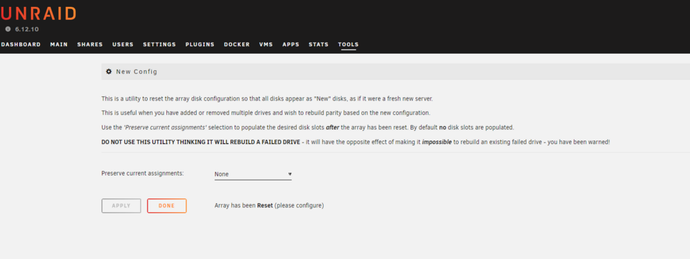

Then post new diagnostics so we can see if emulated disk2 is mountable.
Okay. Array has been Reset(please configure)
Done, right? Then assign drives, right?

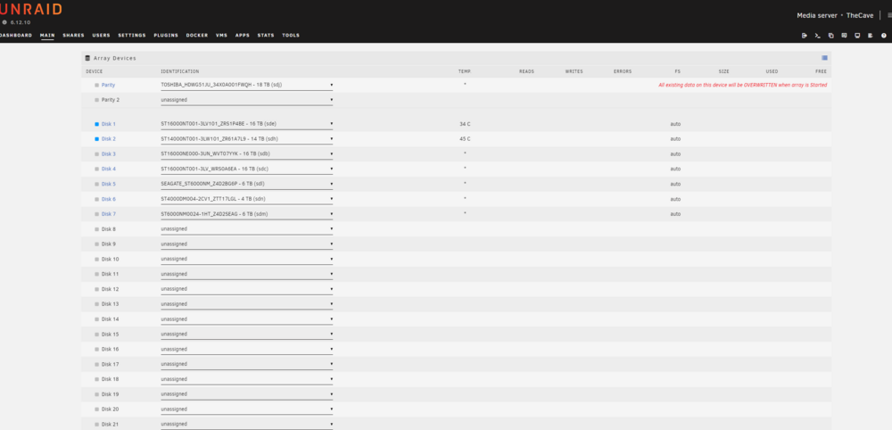

Post a screenshot of Main - Array Devices
Are those assignments correct? Disk2 should be the new disk, but it also thinks disk1 is new. Looks like that is the same disk1 from your earlier diagnostics though.
Okay updated:
Yes. no change for disk 1.

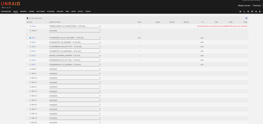

2 minutes ago, ButchR said:
Okay updated:
What did you do between taking those 2 screenshot?
I assigned the new 16TB drive for disk2 14TB drive.
Is something off now?
Oh, I see, you changed disk2 to the new disk. Not immediately clear why it thinks that is not a new assignment, but maybe the explanation could be found earlier in the thread.

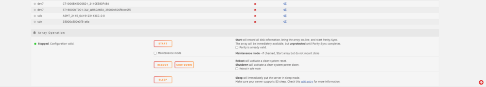

Checkboxes very important
I will pause my actions on this project until I heard from you. Let me know if I did something wrong. When you can , thanks for now. Just another shot of screen Array operation.
On hold with steps and observing warnings.
