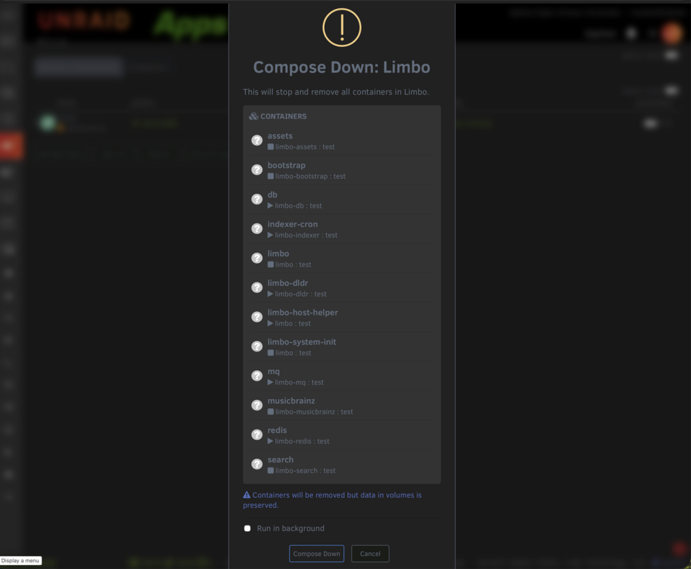

3 hours ago, LAS said:
I have a weird issue where when I I click update, I'm left with a non-interactive terminal window at ~/
Running docker compose pull from the project dir successfully pulls the update, and down and up -d works as intended.
I do have a custom .zshrc loaded at server start, with some vars set, but this shouldn't really interfere.
I see mentions above to cd /boot/plugins/compose.manager/projects/[your immich project]
I assume this is a typo, as projects are in /boot/config/plugins/compose.manager/projects/[your immich project]
Does the update complete if you check run in background? That will tell us if the command is correct or not. Then I can check just the ttyd path. Do you have another ttyd window open, like a log window?

20 hours ago, mstrhakr said:
After some brief testing, when a compose log window is open, and you run update (likely other options also) it takes over the log window and the popup is left empty. It runs the update in the existing new tab log window and does nothing with the popup ttyd. I will be looking into this, expect the fix to land in the beta first. The workaround is to ensure log windows are closed before performing actions or use run in background and grab the output after.
No log windows open, I had an open ssh session though, but closing it did nothing.
Was this a one off issue or something you can consistently reproduce? What version were you on when you experienced this issue? I have fixed the issue I spoke about above and will be pushing it to the beta soon.
I'm on v5.0.2
I had 4 stacks needing update, it happened on all of them. Manually updated one of them via docker compose pull -> down -> up -d
I've not found a way to get it to update in foreground, but Run in background seems to be working reliably.
I've not attempted rebooting, as this is my this-should-always-stay-on server.
I recently removed that 5.0.2 from the title bar as that is actually the Compose CLI version, not the plugin version. You can find the plugin version on the plugin tab if you are on stable, and in the beta I've moved both the plugin version and the Compose CLI version to the settings->credits page.
Is this only happening for update, or do all foreground actions have the same problem?
2026.04.10
Compose Down, Compose Stop, Compose Restart, Force Update all does this. Did not test Compose Up, but I can only assume it does for this as well.

Found the culprit though, and this is a real edge-case, that you might even don't need to worry about.
I append to .bash_profile on boot with if [ -d /mnt/user/appdata/zsh/.oh-my-zsh ]; then if [ -x /bin/zsh ]; then /bin/zsh; exit; fi fi in order to have zsh as my shell, and $innerCmd = "bash -lc " . escapeshellarg($scriptCmd); (compose_util_functions.php) pick up and execute this.
I've added [[ $- == i ]] and everything now works as it should.
I guess if you want to avoid user customizations you could do --noprofile --norc then load a controlled env, but I wouldn't worry too much about it.
Thank you for letting me know, I will look into this.

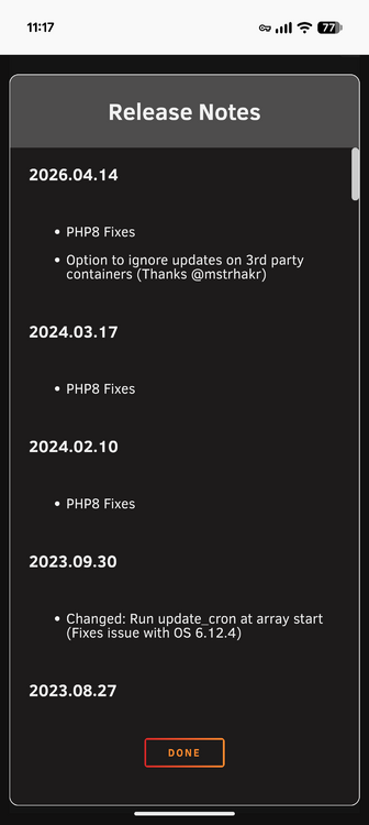

I'd also break with Unraid's convention of using the "DONE" button and relabel that button on the bring-up window "CANCEL" if you can't close the window without stopping the process.
Anyone involved in Unraid web design: DONE does not mean what you think it means and CANCEL buttons shouldn't be named "DONE" all over the UI.
yea, i have to figure out how to deal with this as its in an Iframe and i have limited control over it. i'm sure its possible but I havent looked at it yet. Should show done once the script is finished. I also want to add a setting to run an action without -d and the button would say detach in that case.
