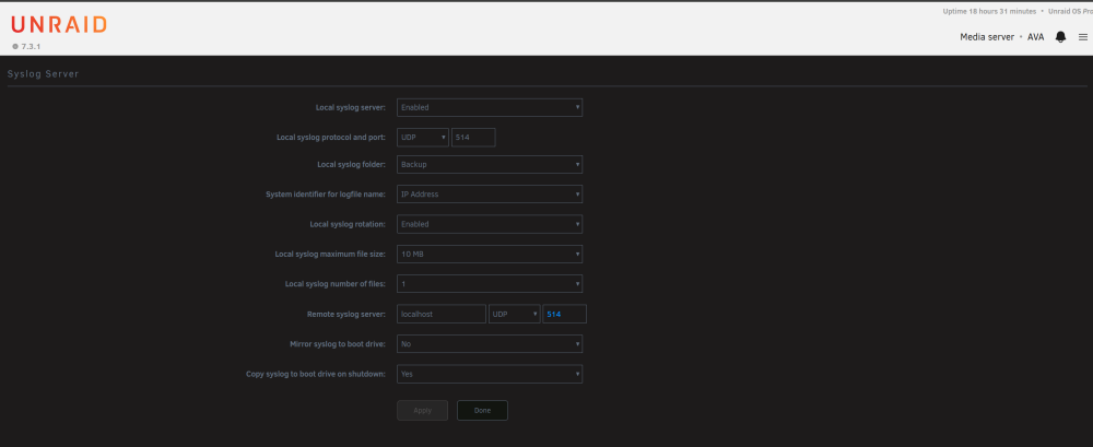

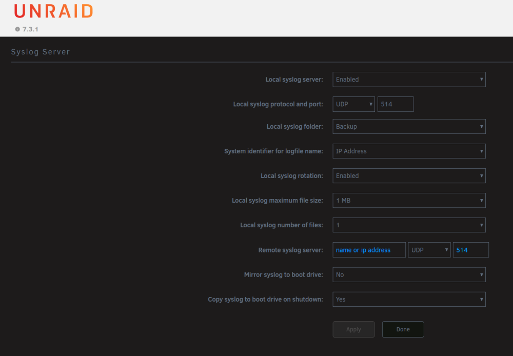

18 minutes ago, Ebein said:
Guess im confused about the syslog server, I went and enabled it, is it added to the regular syslog or a separate file?
ava-syslog-20260716-1429.zip
It's a separate file saved to the share you selected, it will log everything up to the time you reboot so that way the record is not lost after a reboot.
It might be worth posting a screenshot of your syslog server settings so we can check that they are set correctly (many people get them wrong). It will also allow to tell you where its output is being written to (assuming you have correctly enabled the server).
You also have to set the Remote syslog server field. If logging to the same server, you can put localhost.
