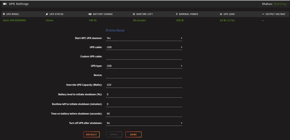

Recently I have added a UPS for my Unraid server - APC Back UPS BX950MI.
Below you can check my current settings. All looks fine to me, but as soon as I cut off power to the UPS, Unraid shuts down immediately.

You can see in my screenshot a load of 12% (62W).

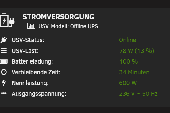

I have changed my USP (thanks Amazon).
I have directly connected it to my laptop via USB. System Check successfully.

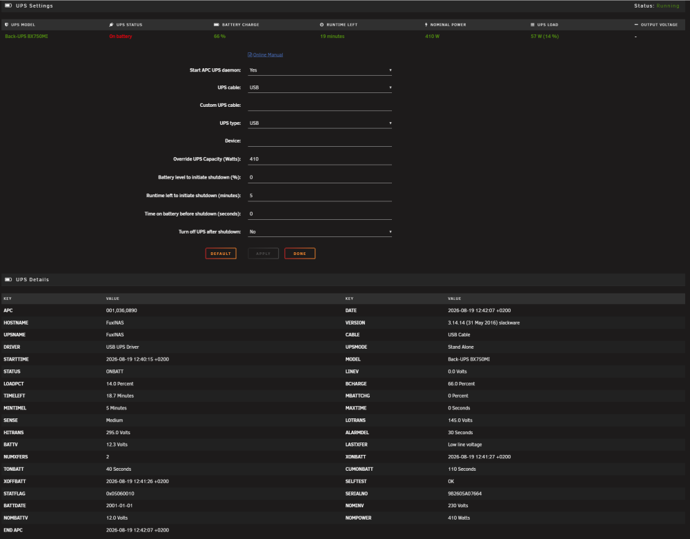

I connected my Unraid server to the USP (USB + power plug) WITHOUT power connection for the USP.
After the successfull bootup all seemed fine. Status "on battery" runtime left "19 min"

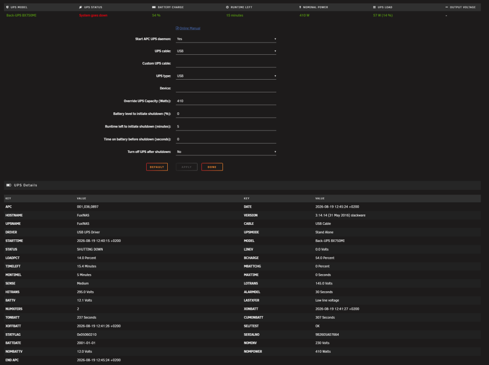

after additional 4 minutes, USP decided to shutdown the system. without any reason. 15min left, but it should run down to 5min as specified.
Any idea? I pretty sure we are able to exclude my UPS as the problem.

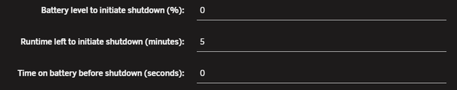

A little late to this thread, but just thought I would comment on the settings you have for your UPS.
The purpose of UPS isn't to allow you to run on batteries as long as possible. The purpose of UPS is to allow you to run long enough to get through very brief power outages, and to allow your server to shutdown cleanly if the outage is more than brief.
The parameter you should be setting is Time on battery before shutdown (seconds). 300 seconds or less is my recommendation. You need to figure out how long a clean shutdown actually takes.
You don't want to allow the battery to run down very far. It is not good for the battery, it takes longer to recharge, and you don't want to restart your server on an UPS with depleted battery.
You need to remove the values to disable them. Only use one and preferably the last option starting with 300 seconds.
Right now three simultaneous things could happen:
  1. Unraid shuts down at 0% battery which means it could run until the battery hits zero which is no good.
  2. The UPS waits until there is 5 minutes left of runtime to shut unraid down which means if your server uses enough wattage to cause the timer to hit 5 minutes it will initiate a shutdown even if there is 99% battery left.
  3. Lastly, time on battery = 0 seconds means as soon as a power loss event occurs, it will immediately attempt to call a shutdown.

I don't think so, as UPS status change from on battery to shutdown, it should be the reason why UR will shutdown even timeleft sufficient.
Why you setting override power capacity in 520/410 ?Pls try empty those setting.

I have removed all settings and just keeped
Time on battery before shutdown (seconds): 300
