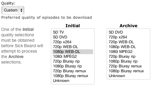

I've adapted the common.py source from sickbeard so it can search for 720p web-dl, 1080p web-dl, 1080i MPEG2 (usually TS files) and bluray rips (x264 re-encodes with bluray or hd-dvd as source with possible degraded quality) and bluray remuxes (non-re-encoded blurays but stripped and/or remuxed, keeping quality).
It also changes the wrong 'HDTV' quality to its correct name which is 'x264 720p'.
Quality is from top to bottom where top is worse, bottom is best. So a 720 web-dl is better then a 720p x264 (which is usually the case).
Offcourse, feel free to change it to your own likings.
Just replace the common.py with this one and you're ready to go.
(Keep a copy of the original one just in case)
common.py.zip
jowi,
that's brilliant, thanks for that. been missing that sort of customization.
cheers
