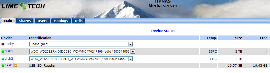

I think that I don't understand something, as wtitten in the FAQ I can't use 3 disk for data with basic license. As I said before I have basic lic and 2 x 2 TB drive in the array, so if I want to expand my array I need to buy plus license. Can you explain how can I add my 500 gb disk to the array step by step? Just assign one of the 2 TB hdd to the parity slot and 500 gb hdd assign to free data slot? I thought that parity drive is using only for parity and can't hold user files and I have 2.5 TB for data and 2 Tb for parity.
[/img]
I did not get you were still using the basic license, Then you are limited to three drives and the parity drive indeed does not hold your data. I would advice getting a license ..
