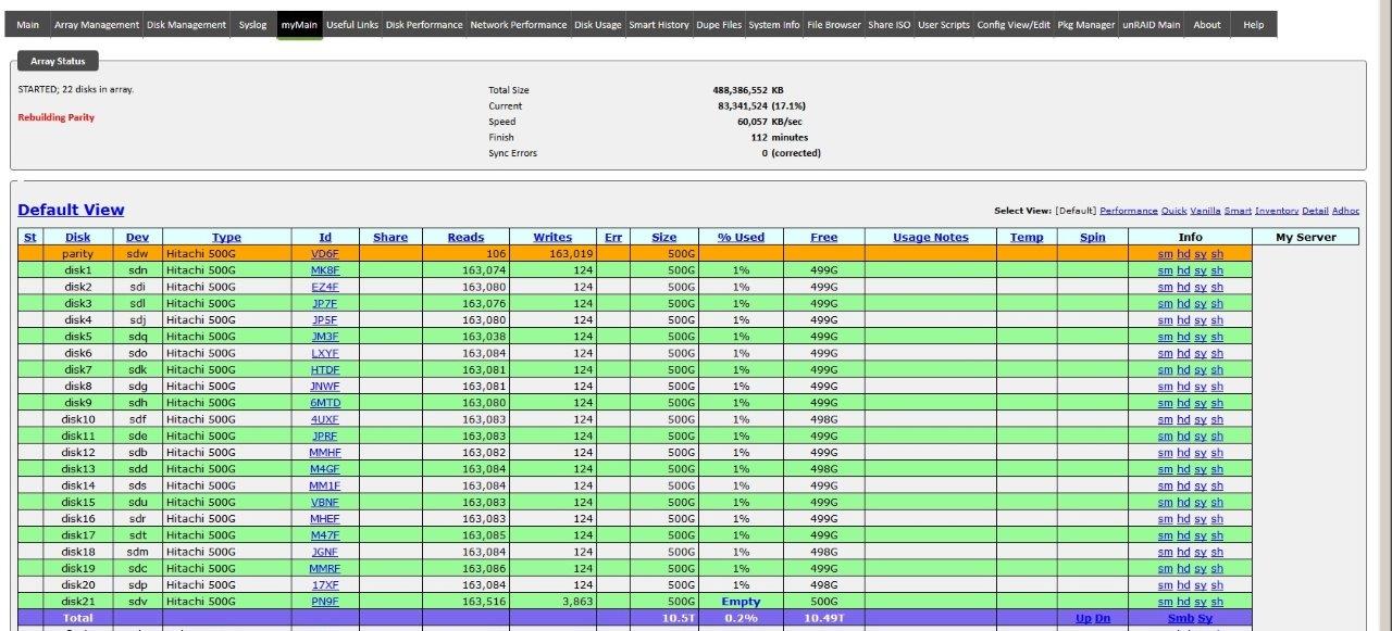

Just got Frankenstein up and running looks ugly but here is the moneyshot
I see no issues with 3 m1015 flashed to p15 running on latest esx 5.1 pass-through on a supermicro X9SCM-F motherboard running bios 2.0b with a xeon e3-1230V2 16Gb ram 4Gb to the vm and 22 disks.  Pic below of build doing a parity build.
