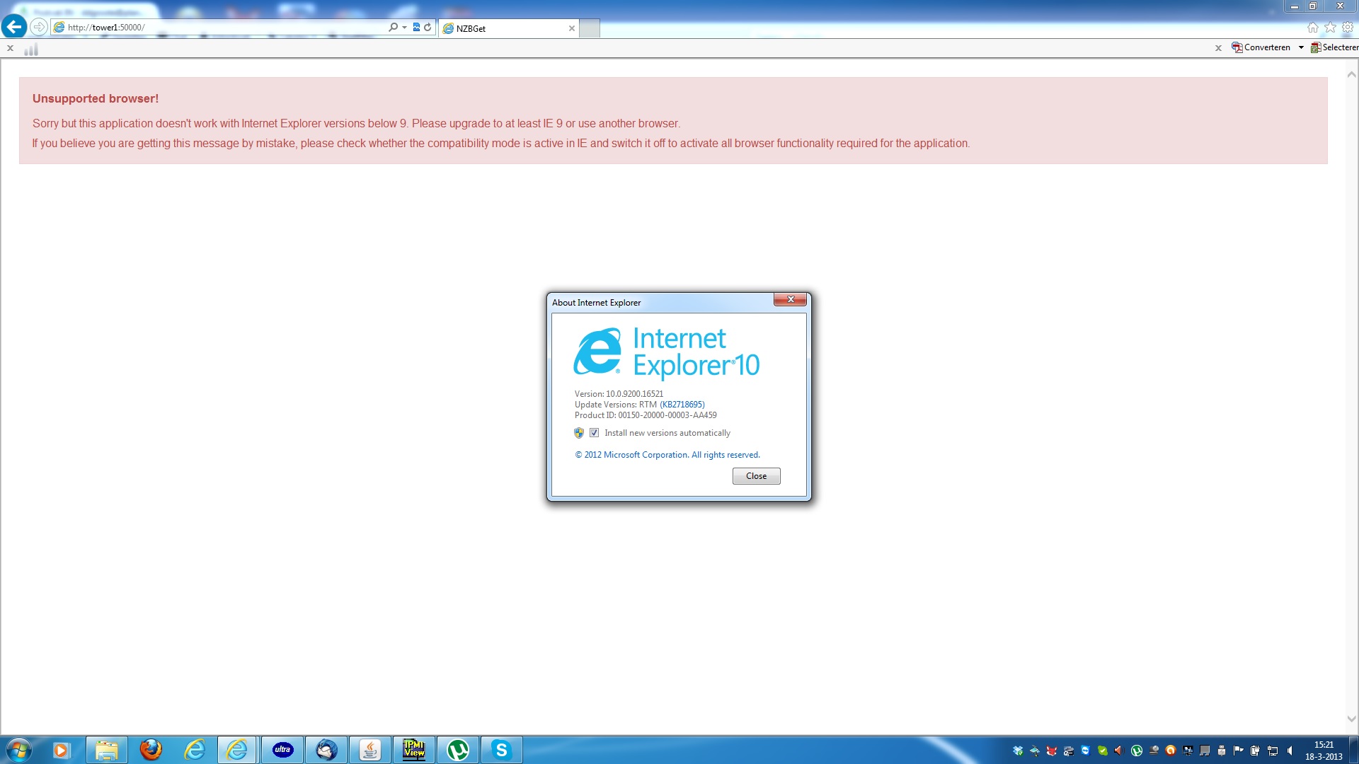

I get an unsupported browser error when open nzbgets webgui in Internet Explorer 10
IE10 is supported and works without issues. Please post a screenshot with error message.
Sure can, see atachment.
Just do what the error message suggests: switch compatibility mode off.
Detailed instructions and more info on IE10 compatibility mode. If you use IE10 you should know what it is or you may have troubles with many sites.

@dikkiedirk:
What about IE10, does it work now?
Yea, thats OK now. Thanks.
