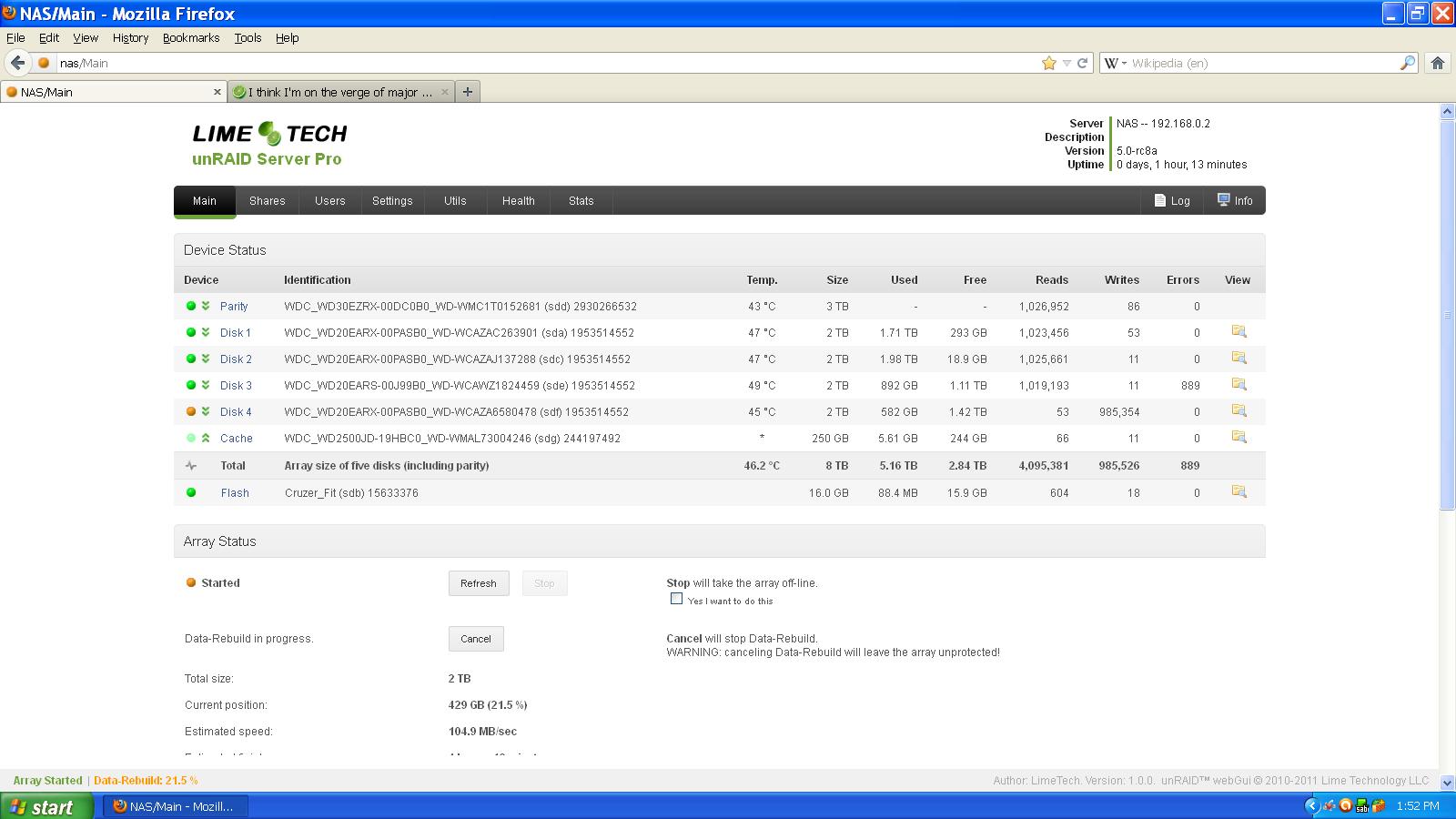

Alright, so I have woken the server up, I had to cancel the rebuild that was in progress as it was lagging the web interface. The disk that was being rebuilt is still red balled (as expected) the disk with the errors is still green, but shows 2581 errors in the web interface.
The SMB shares are still working so I am currently trying to grab everything that is not easily replaceable incase it red balls that second drive and I lose everything.

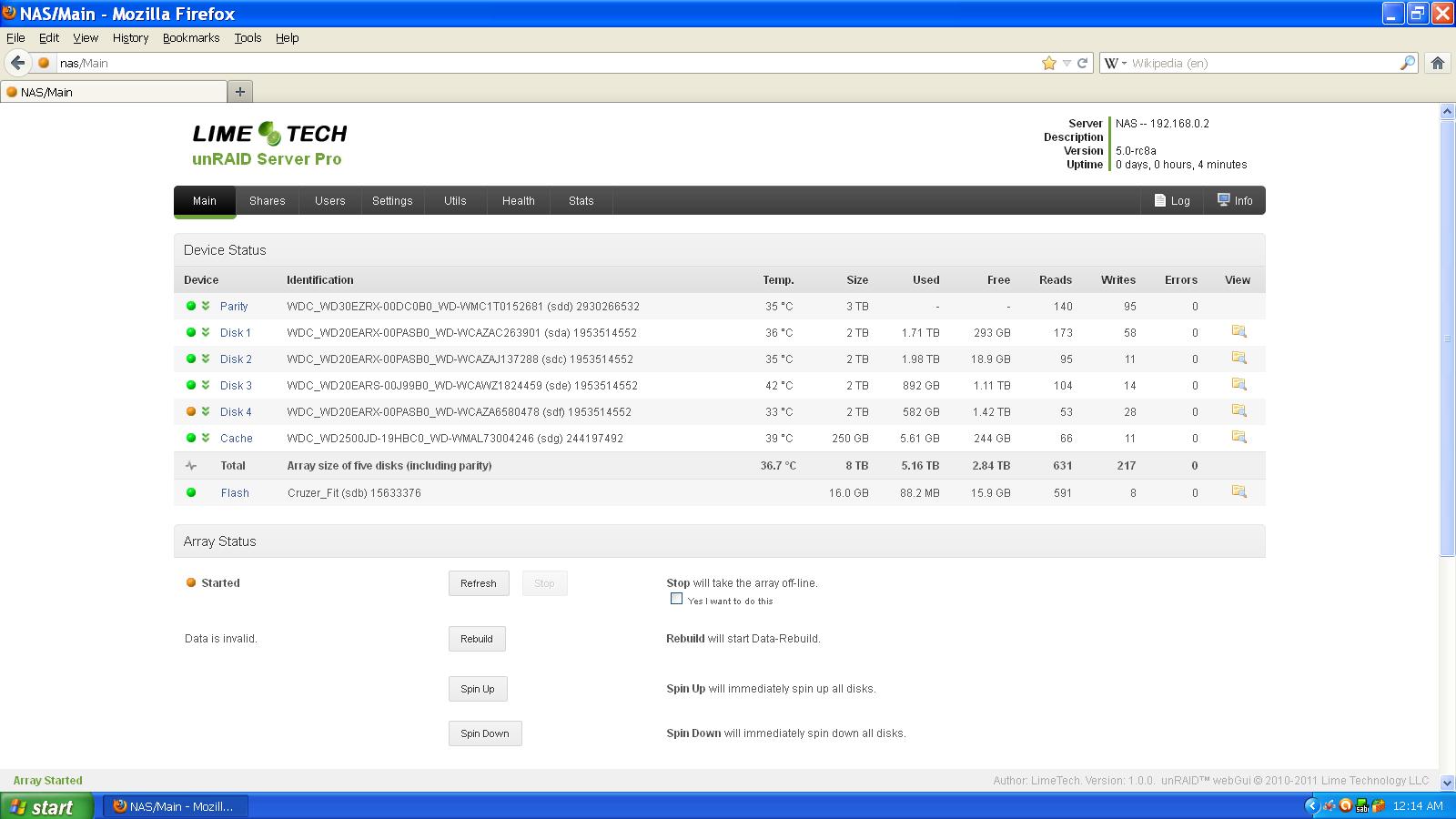

I ran memtest (1 pass - it took 1.5 hrs to complete) zero errors.
When exiting memtest the server reboots, so I was unable to remove the plugins from the flash drive, I let it boot anyway (intending to power it down once booted and remove the plugins then reboot). However unraid booted normally and now shows all drives as green (except the drive that was originally being reconstructed of course) the disk that had all the errors (disk 3) is green and no errors are listed.
The syslog seems error free too.
So what do I do now? Attempt to reconstruct disk 4 again?

Well everything was looking good, rebuild was underway.
Now disk 3 is throwing up errors again. The rebuild is still continuing at around 100MBs so I'm letting it run for now. But will it actually rebuild correctly when one of the disks has errors?
I'm not really sure what I can do to bring the drive temps down, the drives are still sitting in their trays but have been removed from the cages and are sitting elevated on some wood to allow for airflow underneath. Perhaps remove them from the trays and see if I can find a desk fan or something. It's just unfortunate its a 30 degree day today and I don't have aircon.
syslog.zip
Not long after my last post, drive 3 started spitting out more errors, I could hear the disk seeking constantly and the data rebuild dropped to a crawl, so I have cancelled the rebuild.
Right now I am backing up all the data off disk3 and as much from disk 4 as I can (disk 4 is only 100 or so movies and I can live without them).
