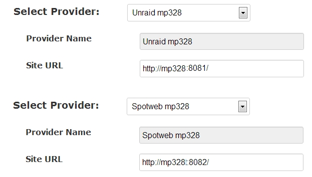

maybe we're misunderstanding each other, i was trying to explain how i had mine setup and working with newznab. but was to lazy to type it all out on the tablet lol. i use dyn.com myself for all my unraid access from the outside  newznab/spotweb/sb/sab/cp/subsonic/plex and all the other pages
but your write up will sure help the other fellas that are trying to set it up. and as i was hoping someone was just gonna add a free one and zack did just above this post

i am not sure if i understand the question correctly. but if u see below that might answer it... my settings in sickbeard with the port number behind the adress!?
Yes, that answers my question. I'm on the most updated SB version and when I enter a port # after the IP, click Save changes, then restart SB, it automatically drops the port# and am only left with the IP address, so connection fails. Consequently, I cannot seem to point SB or CP to my local Newznab (or Spotweb) databases. Any insights from you or others what I might be doing this incorrectly? Is it possible I have to do this port forwarding thing on my router to get it to work?
do you have a trailing slash?  http://XXXXXXXXXX:8082/
Be sure to delete the source and add as a new one if you create incorrectly.  Don't try to update an old one.
