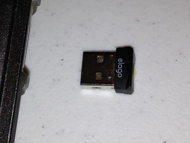

Flash Drive: elago Mobile Nano II USB 2.0 microSDHC Flash Memory Card Reader
with a SanDisk Ultra 32 GB MicroSDHC Class 10 UHS-1 Memory Card.

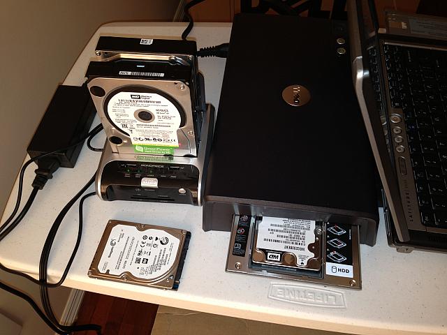

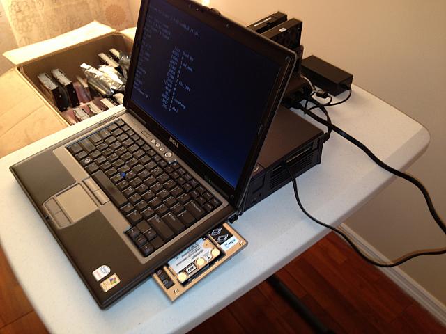

This is the Dell D630 on a Dell PD01X Dock. PCI SATA card in Dock connected to Mono Price External USB/ESATA Dock.
Notice how the Dock has a HDD Caddy with an Additional 2.5" sata drive.
You can put a floppy, DVD-RW, SATA Drive or a Bay battery for charging.
eSATA 2.5/3.5" Dual Drive Dock. Needs a eSATA connection capable of Port Multiplier Support.
Another close up of the HDD Caddy.
Other side of Laptop. Notice the HDD Caddy can also be placed in the Media Bay replacing the DVD drive.

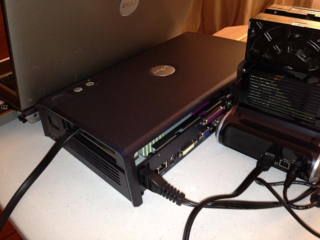

The edge of the PCI card is in the dock showing the eSATA cable attaching to the dual eSATA/USB dock.
This is the back of the dock, Shows where the PCI card gets inserted.
Close up of the PCI card. I choose the SYBA PCI card due to it's small size.
Once I got a look at the dock, I realized I could have used a larger card, thus I could have used the 4 port SIL3124 cards that are common.  In the mean time this card does well, plus there are two more internal SATA ports.
I could always rig a temporary SATA to eSATA connection if needed.
Close up of the dual dock and back of Dell Dock.
I put it near the exhaust fan hoping to move some air over the drives.

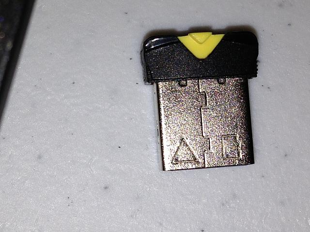

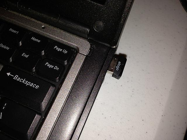

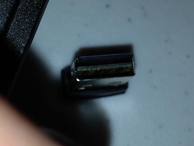

The USB Card Reader is so small. Takes the SD Micro cards on the inside of the USB connection.
All nice and neatly stored away.
This shows the dock and the bay area.

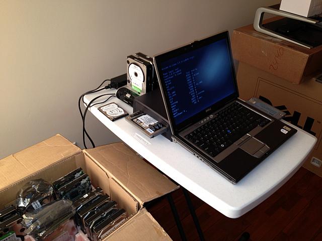

What it looks like closed up. I plan to put this on the monitor stand showing up next.
In the meantime this is how for I've gotten.
I purchased this all used on ebay for a song and a dance.
The Dock hooks in under the monitor stand.
Once I set this all up I'll be putting the San Digital 4 BAY eSATA/RAID device on top of it so I have more to work with.
  I choose to use the D630 and PD01X Dock since the Dock supports 1 PCI card. This let me use a SIL3124 PCI card which also supports port multipliers.
With the eSATA dock and the Sans Digtal array, I should be able to do the most basic of hard drive administrative tasks that I need.
The D630 also supports removable BAY devices as does the dock. This lets me install up to 3 1tb 2.5" drives to store data temporarily until I move it to other 3.5" drives.
The D630 is pretty cheap on the used market as are the bay devices and docks. Makes a good all in one lab machine.

The flash drive I am using is the elago Mobile Nano II USB 2.0 microSDHC Flash Memory Card Reader with a SanDisk Ultra 32 GB MicroSDHC Class 10 UHS-1 Memory Card.
I choose this as it is really small and a card reader. If the flash goes bad I can replace the memory card without dealing with a GUID change.
I just wanted let everyone know that this usb reader did not work for me with a plus or pro version due to non-unique GUID. I purchased one for a very good price, it is tiny, looks super cool, but when I contacted Tom, I found out that the same GUID is already registered to somebody else.
One possibility is that the reader somehow uses the microSD card's GUID and the only microSD cards I had were the same brand and model, therefore they might have the same ID.
But more than likely, the reader has a non-unique GUID
I had to go out and get a Kingston Mobilelite G2, which worked without problems.
Thanks
Thanks
Well that bites! I ordered two of them and was going to register them.  Dam!
