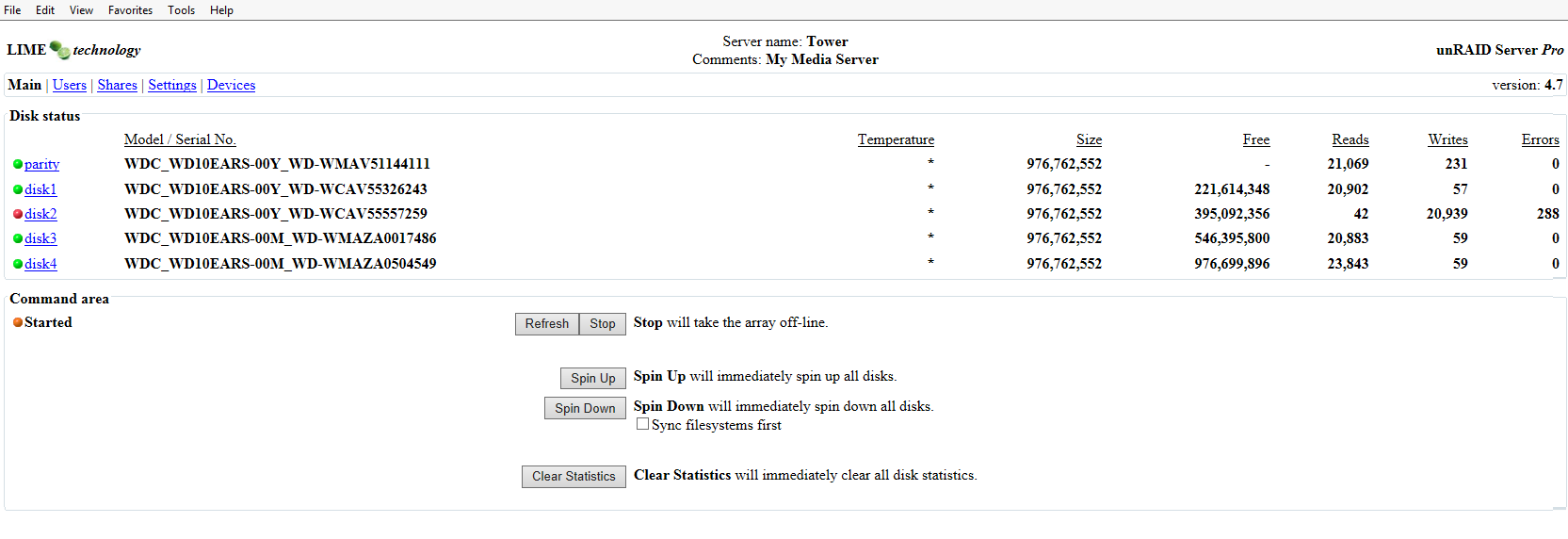

Post a picture of the Web GUI to show the full array's status.
But from your outline of the situation, it does sound like it's time for a new drive.

Attached is the screenshot you asked me for.
You've got good parity, and the drive clearly is having issues => so I'd simply get a new 1TB drive and replace it.
