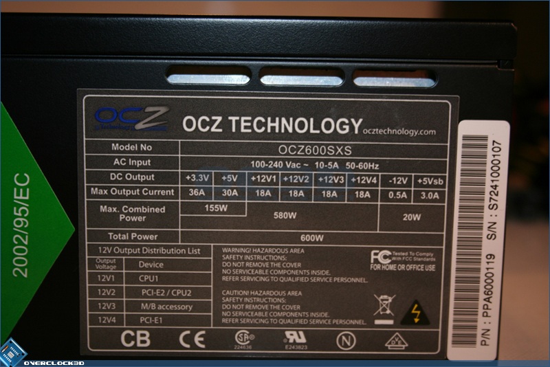

Your multi rail PSU has a single rail that powers the MB and ALL your hard drives.  The other rails are used to power graphic cards - your PCIe 6 or 8 pin connectors - and to power the CPU with the 4 or 8 pin connector.
Attach a digital oscilloscope to the all of the drives and monitor the voltage over time. HP makes some great digital recording muti-meters.
30W is 2.5A per disk = 15A. If the rail is also used for the MB there is not enough power. Less than 1/4 of the power is available for the drives. The PSU is great for a gaming or parallel computation machine. It is not appropriate for a file server.
30W at 12V = 2.5Amps. 6 disk drives X 2.5A = 15 Amps on one of the 12V rails. Each rail supplies up to 18Amps. 3 Amps overhead for anything else drawing from the rail. Find a wiring diagram for the PSU to determine exactly how the rails are wired.

Yes, I thought the math was off... Your calculation is what I got, 2.5 per disk. Also i don't have six disks, I have five at the moment, so that would be 12.5A. Shouldn't it be more than enough?  I'll look for the diagram, it's the OCZ Stealth X treme, 600W
Yes, for 5 disks that should be enough power -- especially after they're all spun up.    If you can boot the array, and all disks are spinning, then the power requirements are even lower at that point.
Nevertheless, a high-capacity single-rail unit has a LOT more "headroom" ... that's why for systems with a lot of disk it's preferable to use the single-rail units.
It should be, and probably was, when everything was new. Things wear out. That PSU doesn't have much extra capacity, so anything that pulls extra current as it wears is going to stress it even more.

Ok I'llkeep this in mind.  S looking at the ratings for my psu, and trying to understand all the info you guys gave me, if I look at the label (pic attached) do you mean that of the 4 "rails" listed, 3 are for the motherboard and pci-e video etc, and for EVERYTHING else you may connect (hdds, cds, etc) you are left with just a single rail and 18A max?

See this page: http://www.hardwaresecrets.com/article/OCZ-StealthXStream-600-W-Power-Supply-Review/451/6
12V3 has all of the SATA and MOLEX connectors as well as the MB.  The MB alone can consume 5 amps.

... specially because the psu I have is not badly rated, it's just that it wasn't the best match for this use from all I'm learning....
Correct.  Yours was designed to be used in a Gaming rig where you would have one or two graphics cards installed and the power would be dedicated just for the cards.
Yeah ok, so I think definitely power supply issue,since the boot problem I just ried to see what's going on, so I just disconnected all disks, and powered it on,whichit did just fine (and this is the part I don't understand why) but then after loading memtest a while just to let is boot something,I turned it pff, and after that, subsequent power ons and the computer does not boot...  Throws me off why it does boot thefirst time though, so I don't know wtf... On top of the "stealth/silent" psu's fan makes some really bad whirring noises, so that's gota be telling something as well...
