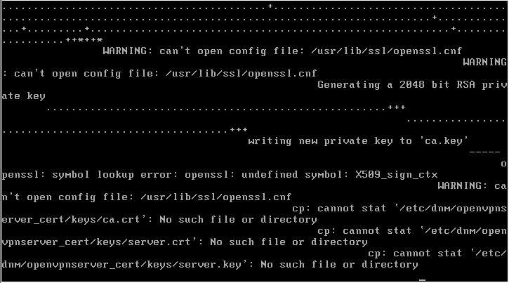

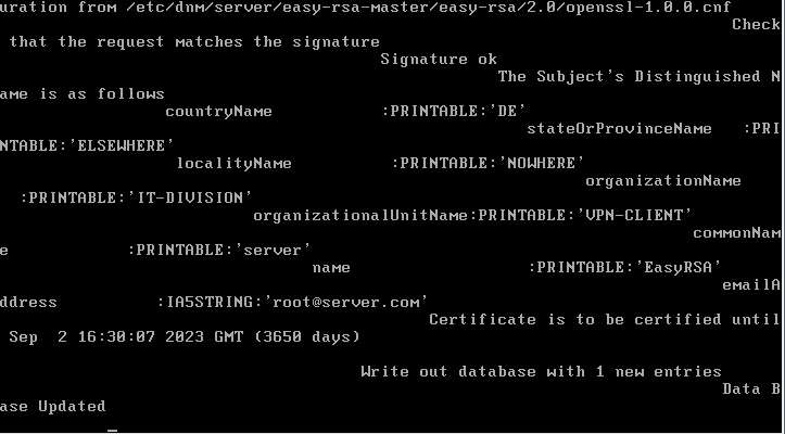

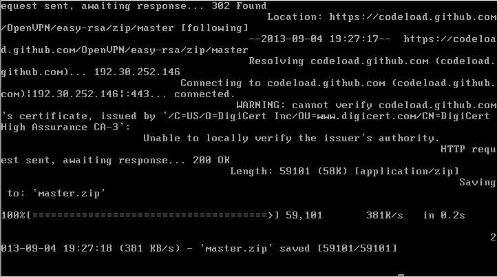

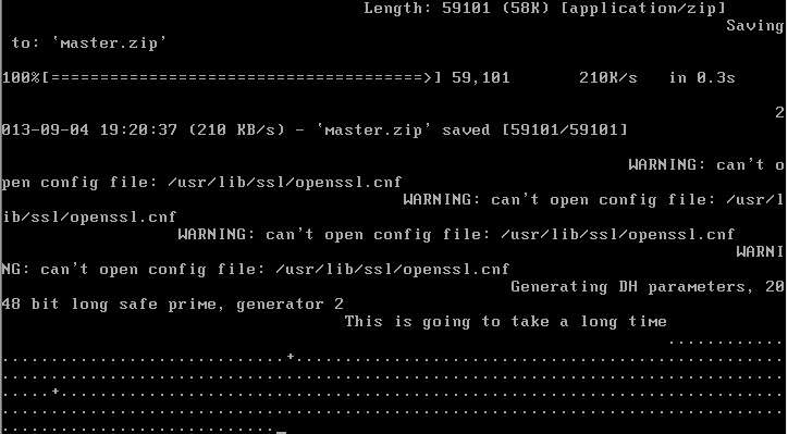

:o finally i find the conflicting plugin: serviio !
you can see the terminal screen snapshots attached with and without serviio installed (with reboot).
if anybody has an idea i ll be listening.

if you:
1) start the server
2) install serviio
3) install openvpn
4) create cert etc and try to start openvpn it will create cert & start without problem.
But
if you:
1) copy serviio & openvpn plg file to /boot/config/plugins
2) restart the server
3) create cert etc and try to start openvpn it will not create cert properly & cant start openvpn.
Or
if you:
1) copy serviio plg file to /boot/config/plugins
3) install openvpn plg
Googled serviio, it looks like it using openssl-1.0.1e-i486-1.txz in some way ??
yoc an verify what version is installed by....
[1] Login to unraid from putty.
[2] Type openssl and press enter.
[3]type version and press enter.
[4]type exit
or
openssl version | grep -E "1\.0\.[[:digit:]][[:alnum:]]?"
find another fact you have to install serviio first. thats why when installing in bootup is not working. Because in bootup plugins intalled in alphabetic order...
openvpn,serviio installed, openssl output:
root@Test:~# openssl
WARNING: can't open config file: /usr/lib/ssl/openssl.cnf
just serviio installed, openssl output:
-bash: openssl: command not found
so i guess serviio definitly doesnt install openssl but somehow manipulates the config.
edit:i attach the installlog for installing openvpn and serviio
installlog.txt
