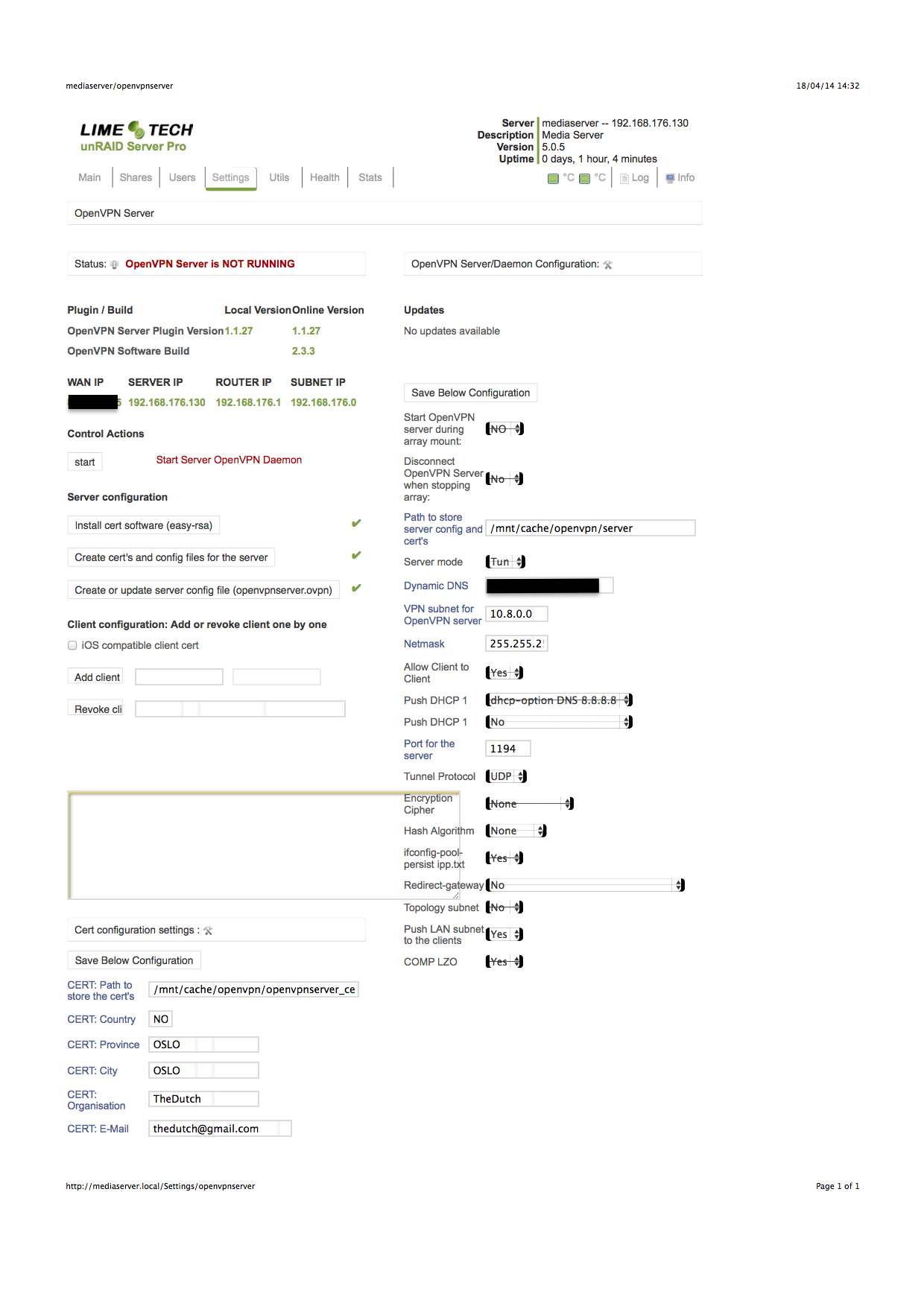

Hi Peter,
I am using the 64bit version on Beta 6.4. I got the server set up and it is working, the only thing that is not working for me is the button "Save below configuration".
When I edit any field in the config and then press the button, all settings are erased from the config file under /boot/config/plugins/openvpnserver/openvpnserver.cfg
I had to manually edit both config files to get the server up and running, but now i want to add encryption and since i cant save from the WEB-UI I dont know what to fill into the config....
I tried hitting the button on Win 7 machine with Iron, Chrome and a vanilla Firefox install and on Linux Mint on Chrome and Firefox, the behaviour is the same everywhere.
What kind of Information and Logs do you need?
In the SysLog it only states: "rc.openvpnserver[7991]: Plugin configuration written"

Hi, I hope it is allowed to post my problem into this thread...
So far I have set up Openvpn Server on the latest beta 4. It is working that i can connect remotely to the unraid server BUT only to the unraid server and not to the LAN behind it. For example I can not connect to my router on 192.168.1.1
The client is a Windows 7 machine running Openvpn 2.3.3
All my machines are at 192.168.1.xx, the gateway is 192.168.1.1.
I have forwarded port 1194 to my unraid server IP adress and tried to add "net.ipv4.ip_forward = 1" to /etc/sysctl.conf but that didnt help.
I guess my problem is trivial, but i can not find a way to get it working. Any help would be highly apprechiated!!!
My server config:

Hi all,
I can not start the OpenVPN Server plugin.
I'm running:
unRaid 5.0.5 final
SimpleFeatures 1.0.11
Cache Directories 1.6.7
iStat Server 0.5.8
PMS Updater 0.9.9.7.429-f80a8d6
PMS Server 0.9.9.7.429-f80a8d6
SABnzbd+ 0.7.17
Sick Beard a211e87bf797dd b9829472eda6d2 2b0d666ecfe6
S.N.A.P. 5.27
OpenVPN Server 2.3.3
I have installed the cert software, Created the cert's and config files for the server, and Created the server config file.
I have the three green checkmarks.
When i push the Start button i see these messages at the bottom of the screen
Starting OpenVPN server
OK... Started
But the status on the OpenVPN Server screen stays at OpenVPN Server is NOT RUNNING
I have opened the port 1194 in the firewall.
I have created one client.
I have rebooted the server already several times.
Still i can not start the OpenVPN Server.
I have looked for the OpenVPN server log file at /var/log/openvpnserver.log but that file does not exists
I have attached the screen shot of the settings page for the OpenVPN server aswel as the syslog file
I hope someone can help me get the server running.
Regards, Rob.

Sab is installing an earlier version of OpenSSL, the plugin needs to be edited to download the latest version
use notepad ++ to edit the sab.plg file
ctrl + h to find/replace
replace openssl-0.9.8r-i486-3.txz with openssl-1.0.1e-i486-1.txz (1 instance) - dont replace the second instance, use the below
replace http://slackware.cs.utah.edu/pub/slackware/slackware-13.37/slackware/n/openssl-0.9.8r-i486-3.txz with http://slackware.cs.utah.edu/pub/slackware/slackware-current/slackware/n/openssl-1.0.1e-i486-1.txz (1 instance)
replace dd6ef02ebfe3e54fc54c03a52f736197 with 3ef010a9da36b042d6724ebf00061192
This is a fix I used before, you would have to check the above is still the latest version
