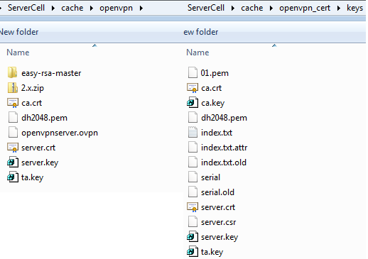

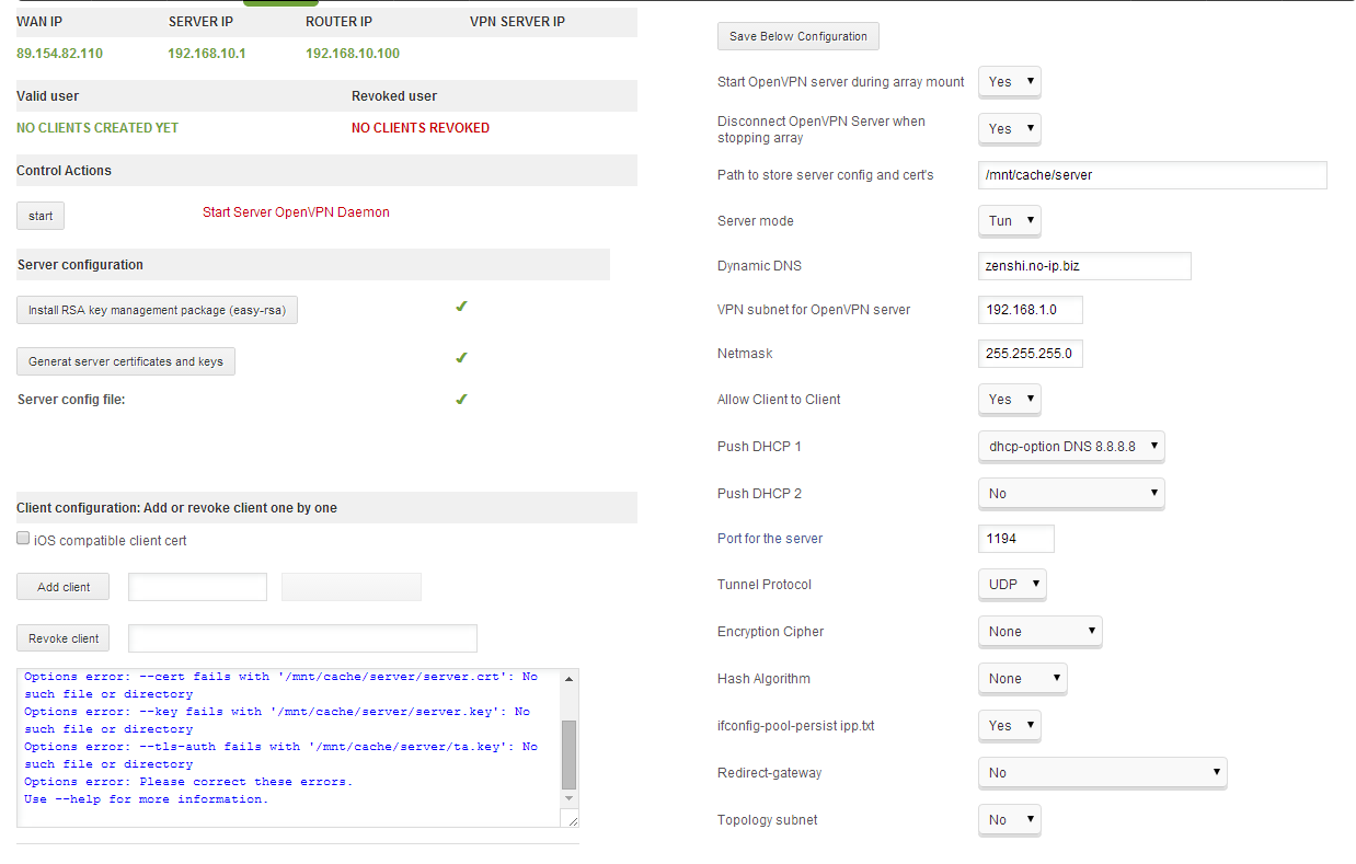

Now what happens is, when I try to run the daemon, I get this error:
Options error: --crl-verify fails with '/mnt/cache/openvpn_cert/keys/crl.pem': No such file or directory
Options error: Please correct these errors.
I tried to generate the keys twice now, and the file isn't created.
do you have same path for both settings? ( cert & server)
openvpn for server
openvpn_cert for cert
Do you have these folders on your cache drive?
if the server folder is empty, try to Generate the server certificates and keys again
//Peter
I attached an image with the contents of both folders.
Thank you,
Zenshi
Are your cache drive healthy? Try to start over again on new folders, and see what happens , I did a fresh install and all are OK
