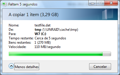

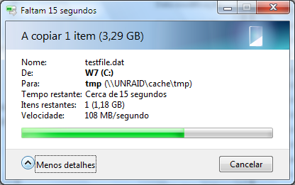

July 28, 201313 yr I did just tested it and I can't really reproduce any smb slowdown on rc16c with w7 as client, see attached screenshots, showing copy to and from cache drive on unraid server. And I'm using the crap onboard realtek nic (details on my sign) and a very very cheap TP-Link TL-SG1008D switch. P.S. I did double checked speed values with iftop to make sure they match the ones showing on Windows file copy window. P.S.2. Repeating test on XP SP3 as client I can still get ~105MB/s when copying to unraid but only near ~50MB/s copying from unraid, however this is not new and I did always seen this on XP as client. I did searched for that on the past and it seems usual, apparently mostly because XP doesn't have smb2 and thus efficiency is not good for a gigabit network, understandable for XP age, but pity that it didn't got smb2 as update, along with tcp rescale window auto-tuning...
