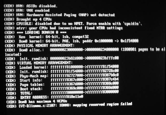

arch_1 /home # xl info
libxl: error: libxl.c:87:libxl_ctx_alloc: Is xenstore daemon running?
failed to stat /var/run/xenstored.pid: No such file or directory
cannot init xl context
 xl info

Have you updated grub and rebooted into the Xen Kernel?
grub-mkconfig -o /boot/grub/grub.cfg
I get the same results as smakovits installing the Grumpy's latest build of xen. For me, when I reboot into the xen kernel the system halts then goes into a reboot cycle pretty early in startup process. Edit-- Attached is a screen shot just before the system restarts. BTW, this test server runs OpenSUSE KVM but will only do USB-passthrough.
No Xen for me.  It's time for a little head scratching.......
Are you doing this with the hardware in your signature? If so, PCI Passthrough will not work because the Intel Atom doesn't have VT-D and possibly the motherboard too (I didn't look it up).

 xl info
Erre,  not yet
OK, updated grub, had same issue as when installing, had to rename *.new to *.cfg, no big deal, I accept it as something I need to do.  However, upon boot, the system boots out of range for the monitor for some reason.  If I reboot and select normal arch, it still works fine, so something when booting to the xen kernel jacks things up.
That sounds about the same as what I'm going through. For the time being, I went ahead and removed the Xen package using pacman.

for me because I get the following:
Generating grub configuration file ...
Found Xen hypervisor image: /boot/xen-4.3.1.gz
        Found linux image: /boot/vmlinuz-linux
        Found initrd image: /boot/initramfs-linux.img
error: out of memory.
error: syntax error.
error: Incorrect command.
Syntax error at line 184
Syntax errors are detected in generated GRUB config file.
Ensure that there are no errors in /etc/default/grub
and /etc/grub.d/* files or please file a bug report with
/boot/grub/grub.cfg.new file attached.done
I have to replace the grub file so:
mv /boot/grub/grub.cfg.new /boot/grub/grub.cfg
reboot, done

nr_nodes               : 1
cores_per_socket       : 2
threads_per_core       : 1
cpu_mhz                : 2992
hw_caps                : bfebfbff:20100800:00000000:00000900:0408e3fd:00000000:00000001:00000000
virt_caps              : hvm hvm_directio
total_memory           : 8025
free_memory            : 128
sharing_freed_memory   : 0
sharing_used_memory    : 0
outstanding_claims     : 0
free_cpus              : 0
xen_major              : 4
xen_minor              : 3
xen_extra              : .1
xen_caps               : xen-3.0-x86_64 xen-3.0-x86_32p hvm-3.0-x86_32 hvm-3.0-x86_32p hvm-3.0-x86_64
xen_scheduler          : credit
xen_pagesize           : 4096
platform_params        : virt_start=0xffff800000000000
xen_changeset          :
xen_commandline        : /xen-4.3.1.gz xsave=1
cc_compiler            : gcc (GCC) 4.8.2 20131219 (prerelease)
cc_compile_by          : root
cc_compile_domain      :
cc_compile_date        : Wed Jan  1 14:48:25 EST 2014
xend_config_format     : 4
