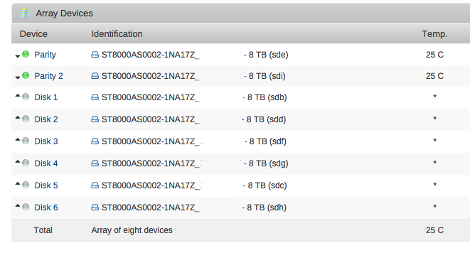

i have 8 seagate archive 8TB disks, 2 of them are parity drives.
for parity drives the Spin down delay: use default
for data drives the Spin down delay: 15 minutes
i use my server rarely.. once or twice a week for 2 hours.
Should i put all disks (inducing parity drives) Spin down delay: 15 minutes or use default?
what is the default?
thanks
  • 4 weeks later...
Could anyone suggest me what settings should i choose?
parity drives Spin down delay: use default
Should i use the 15 minutes spin down for all drives?
