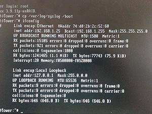

login and see what it thinks its ip address is by doing
ifconfig
see attachment for ip
i see packets received and sent.
from your computer, can you ping that address?

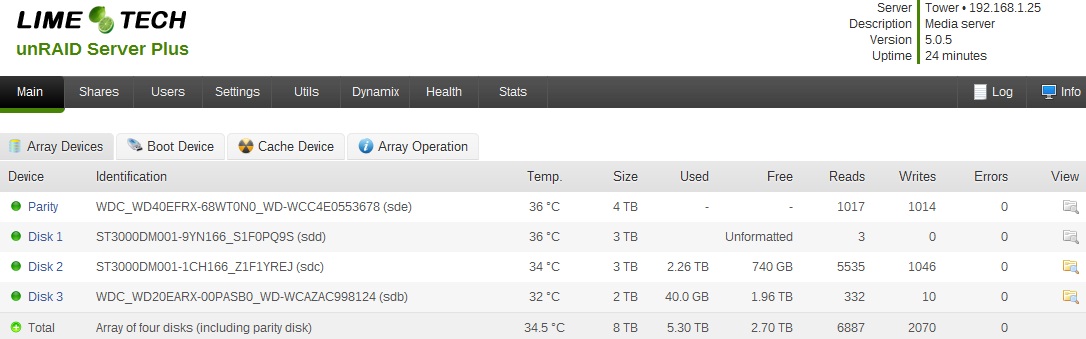

Now my parity disk shows blank (see picture)
Disk 1 unformatted.
How do I proceed????

What do you mean "parity disk shows blank"? If you are referring to the Used and Free columns that is normal. Those are meaningless for the parity drive.
Could it be that the parity check that you cancelled wrote to disk1 thinking it was parity? A drive will show as unformatted if unRAID cannot mount the reiser filesystem on the drive.
You say you backed up the faulty flash drive. Are there any log files in that backup that might include the period when the "disks were all messed up"? In particular we would be looking for a line like this:
Apr 10 07:26:19 Tower kernel: md: import disk0: [8,64] (sde) WDC_WD40EFRX-68WT0N0_WD-WCC4E0553678 size: 3907018532
This shows that your parity drive is what we see in the screenshot. What I am wondering is whether it ever thought the drive with serial # ST3000DM001-9YN166_S1F0PQ9S was disk0.
