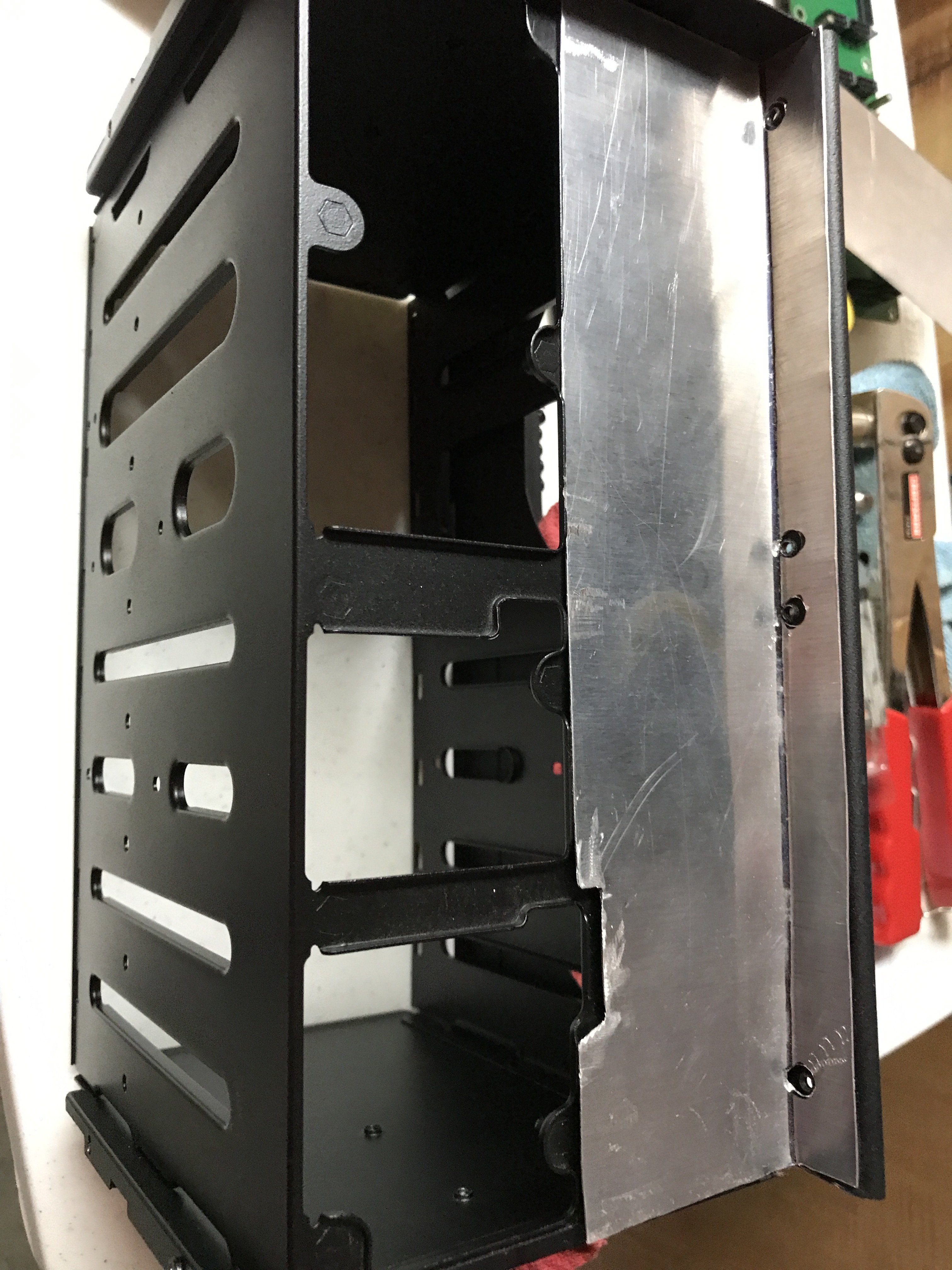

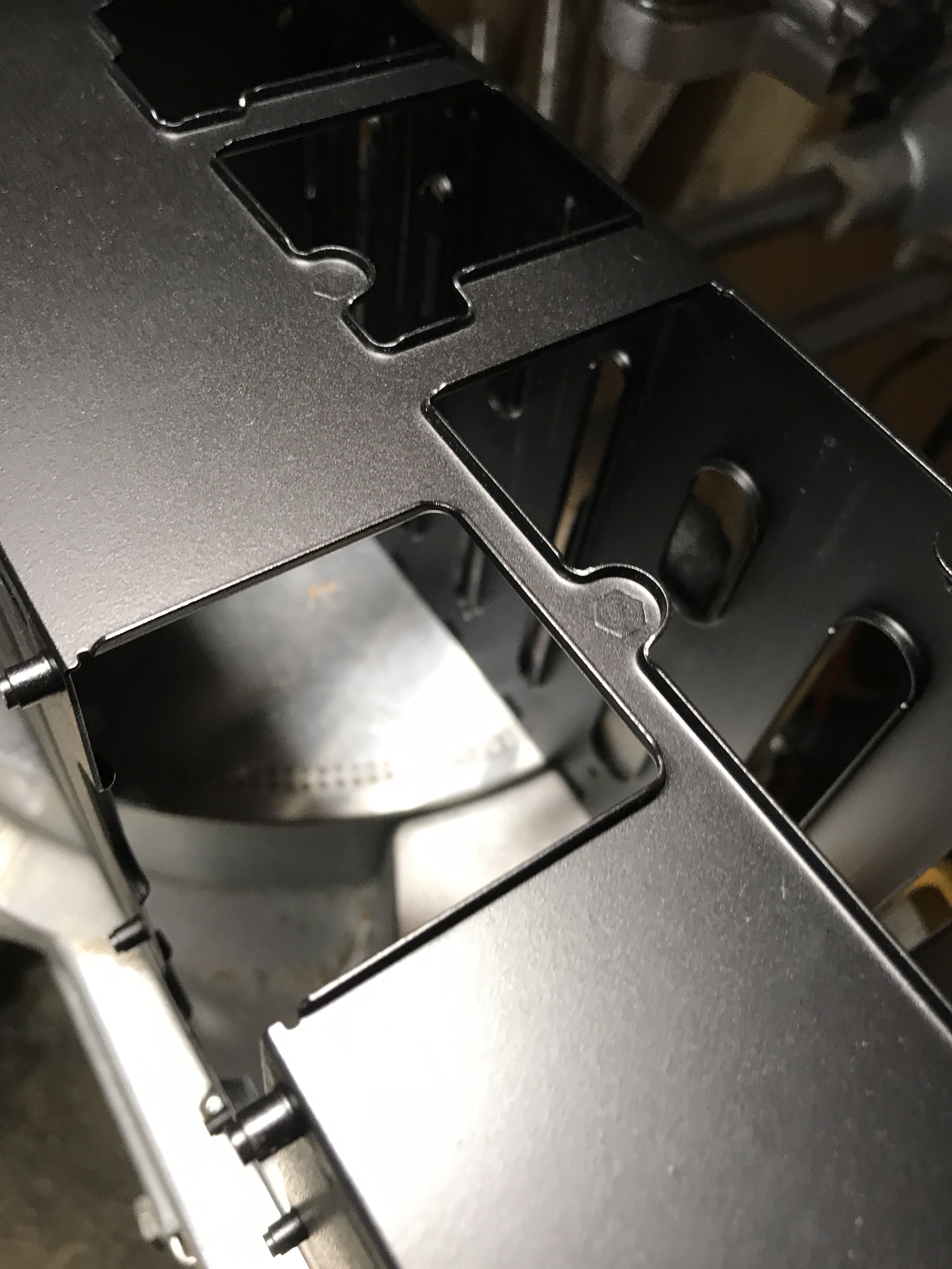

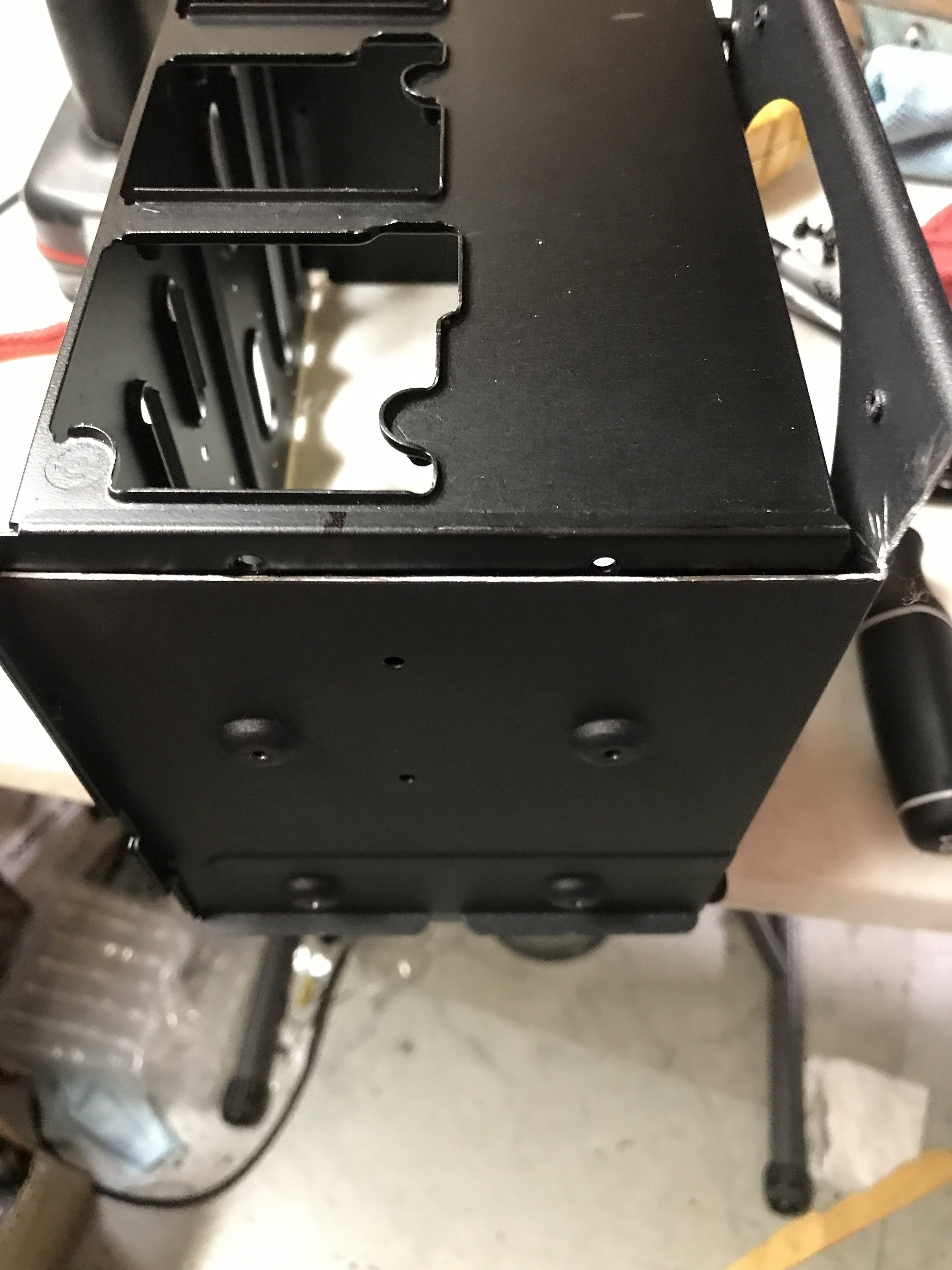

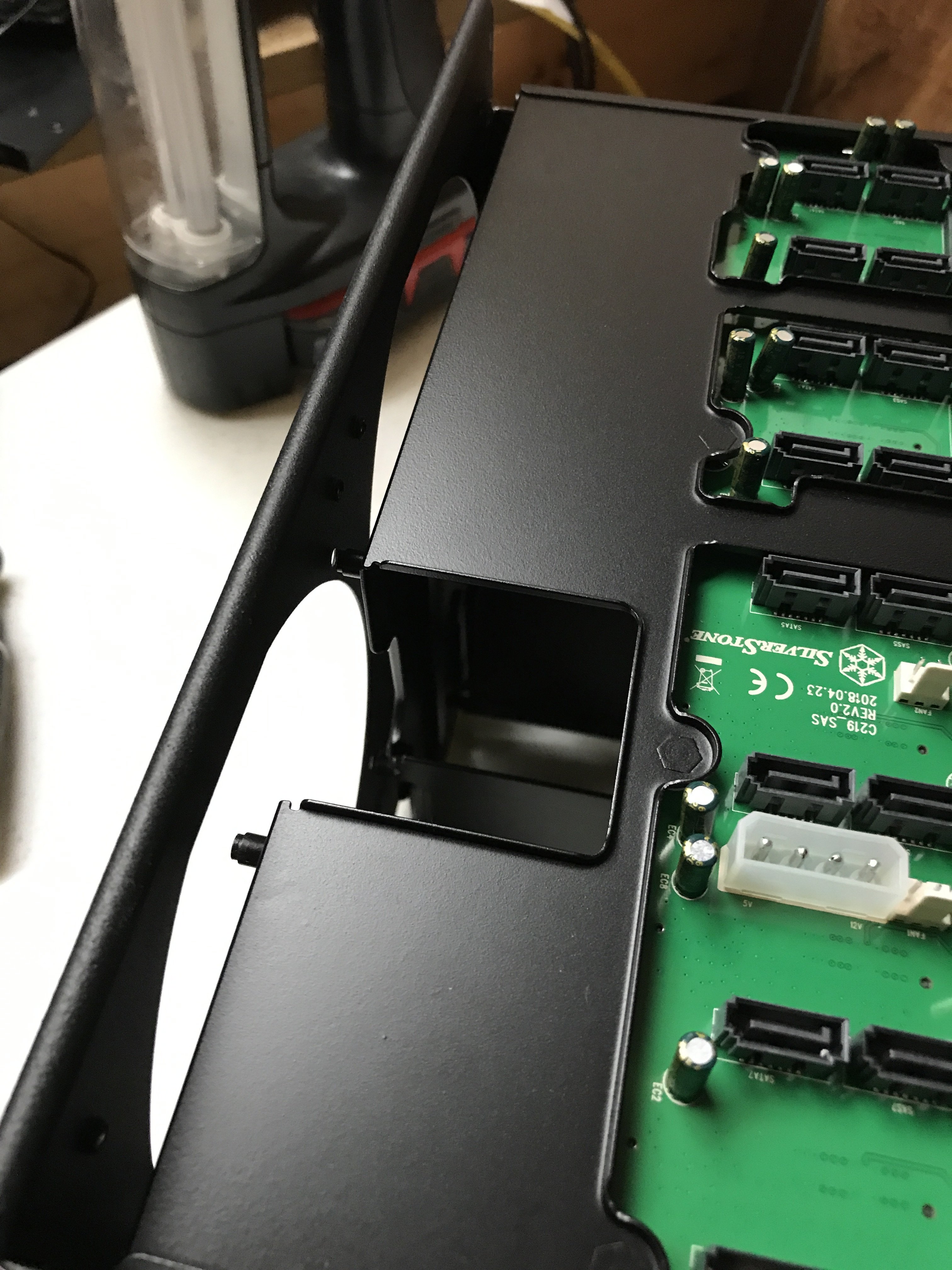

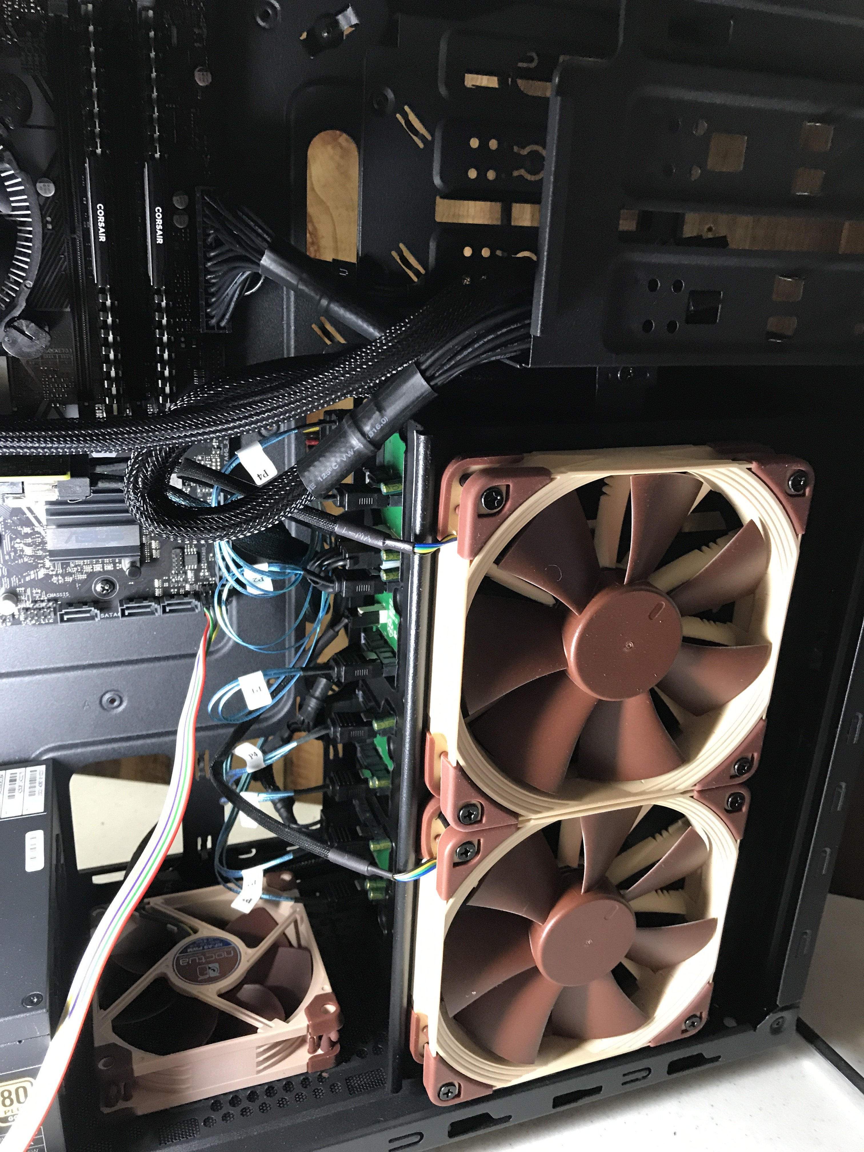

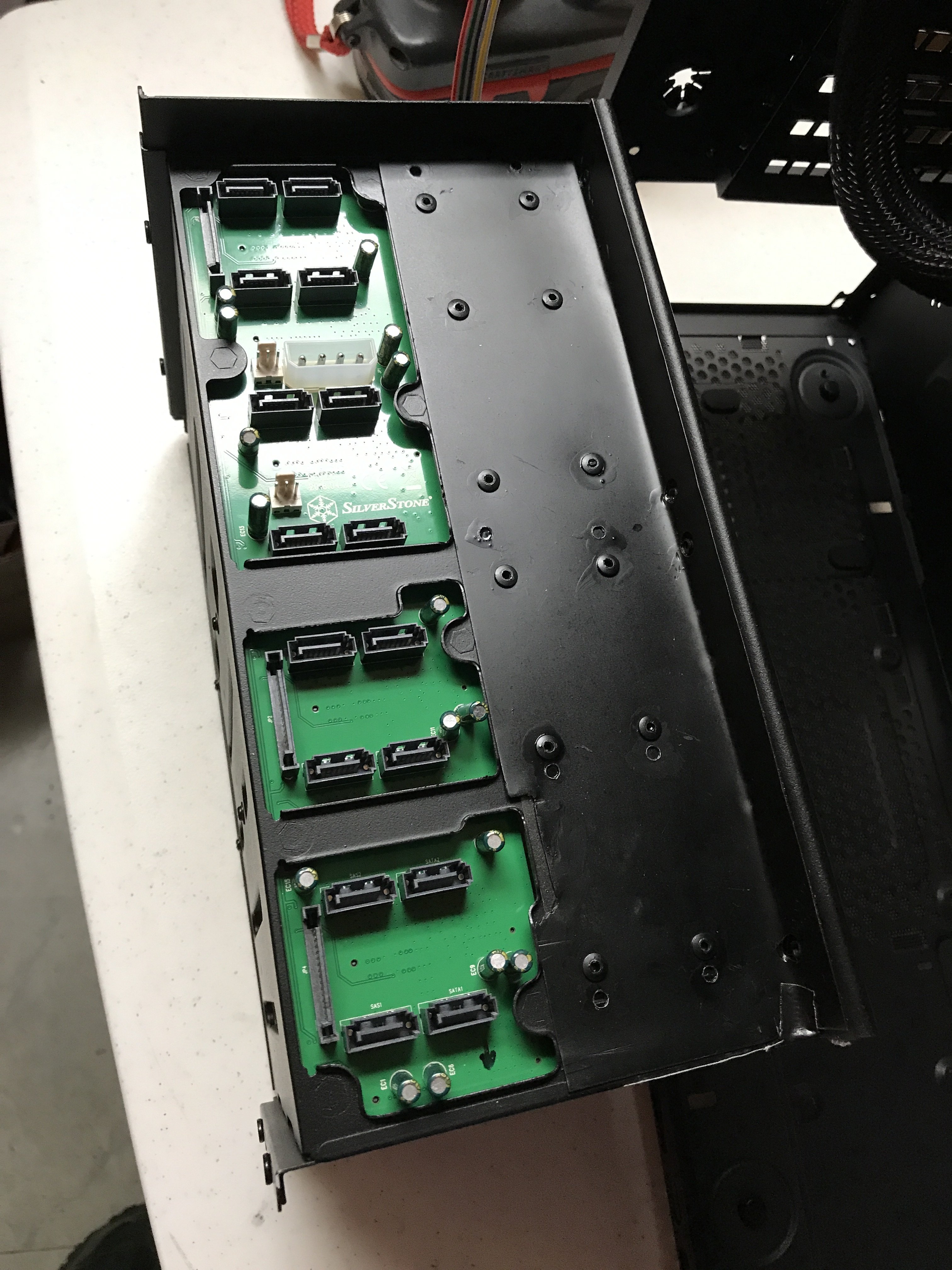

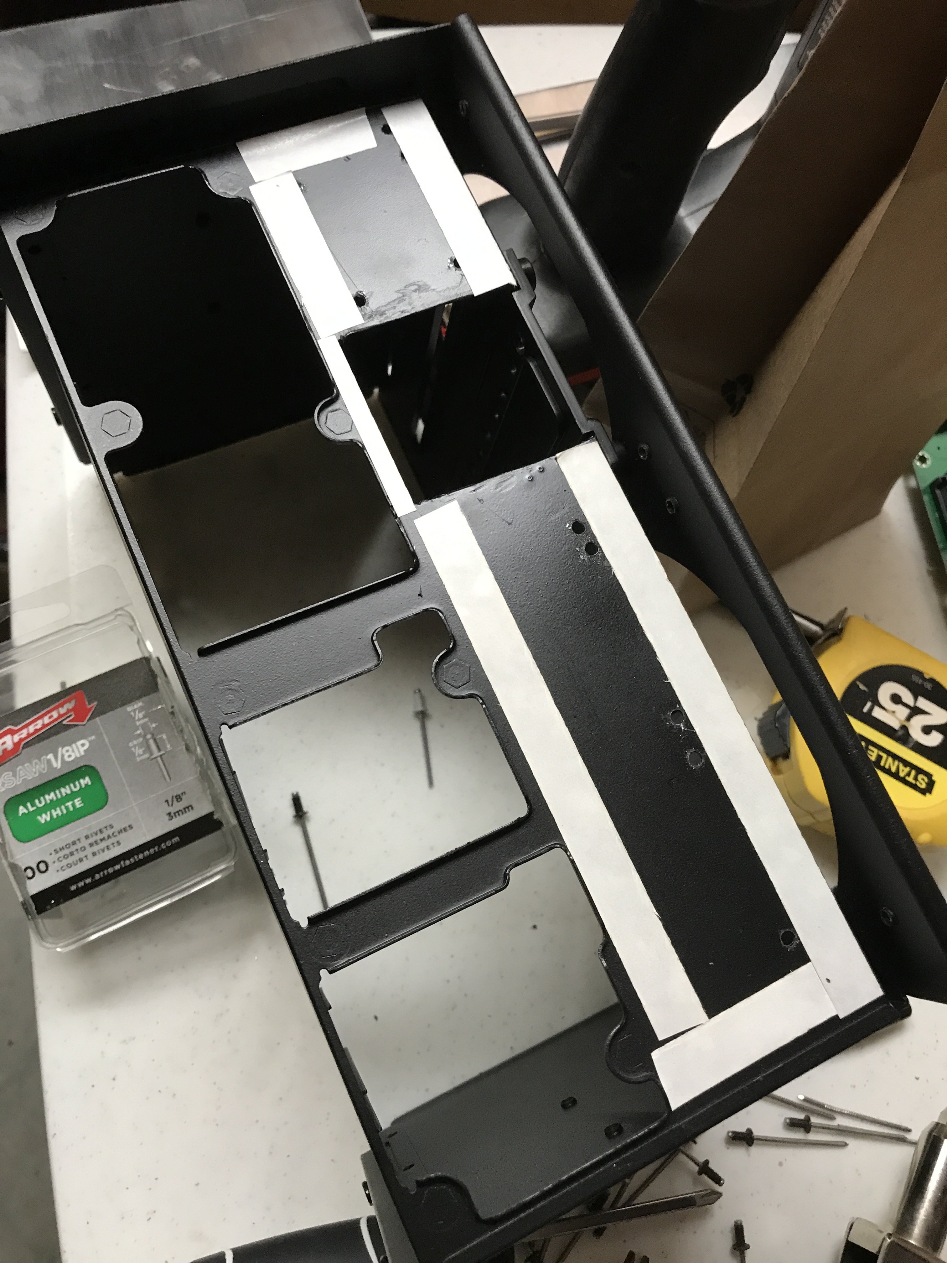

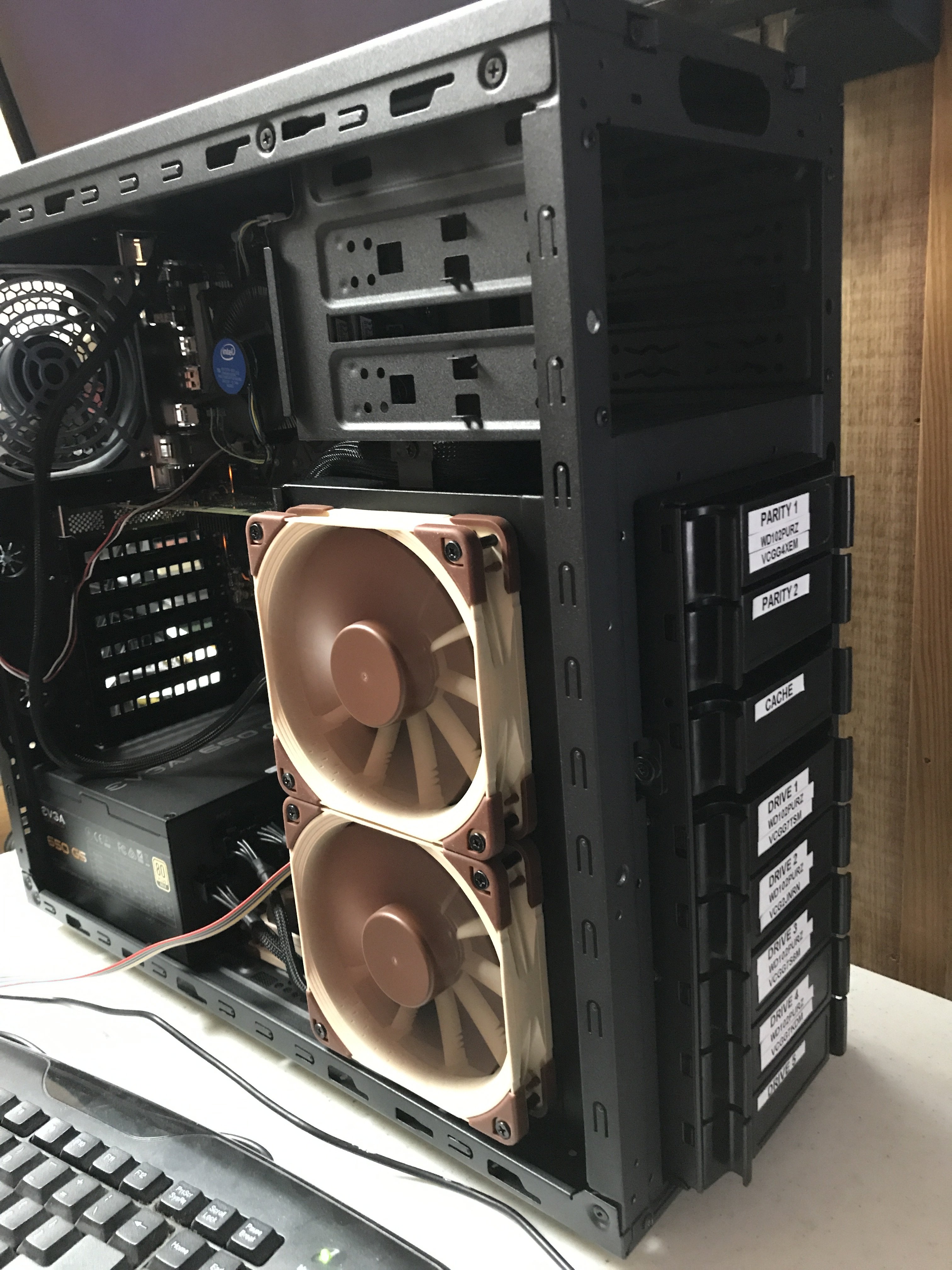

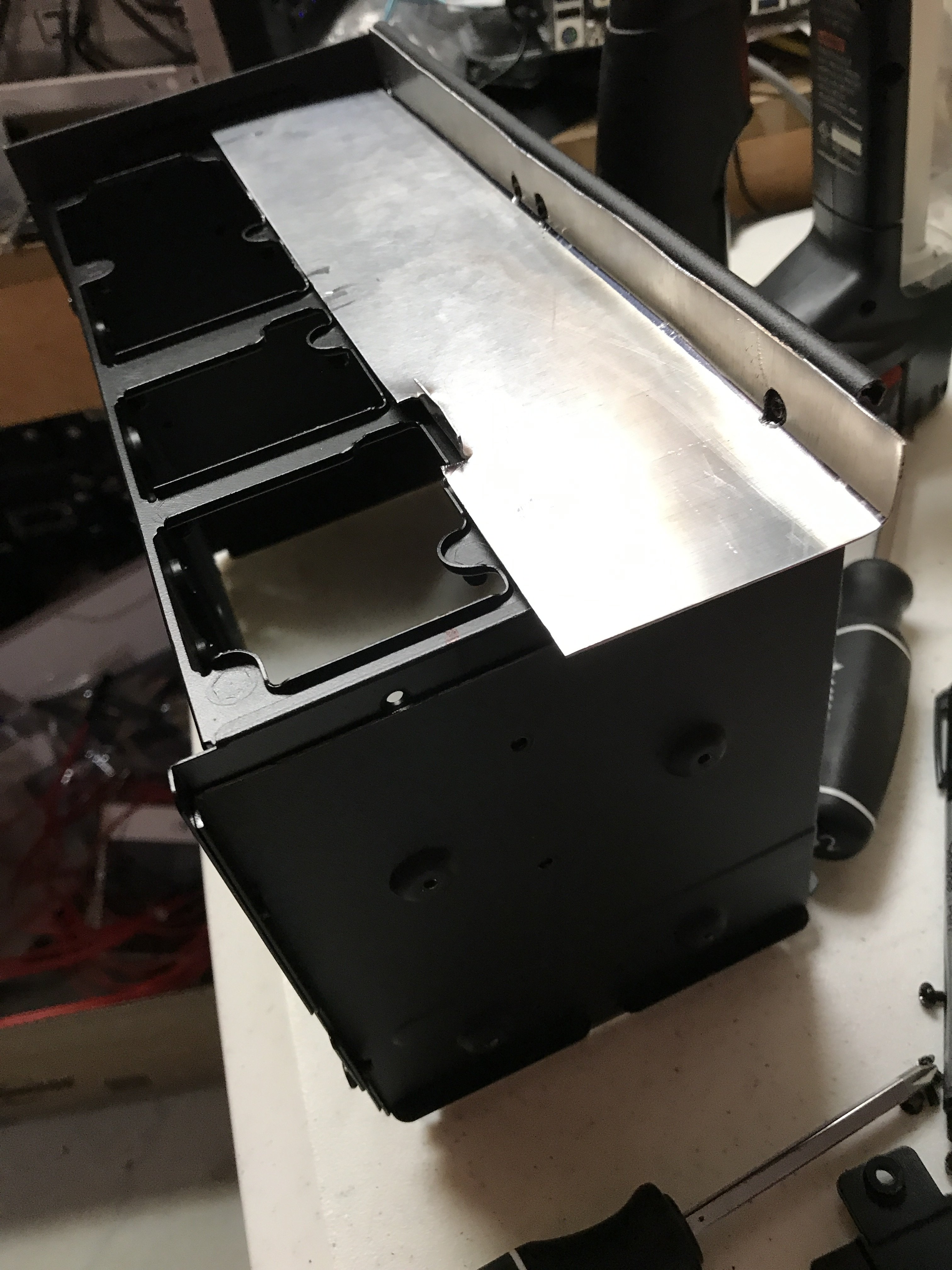

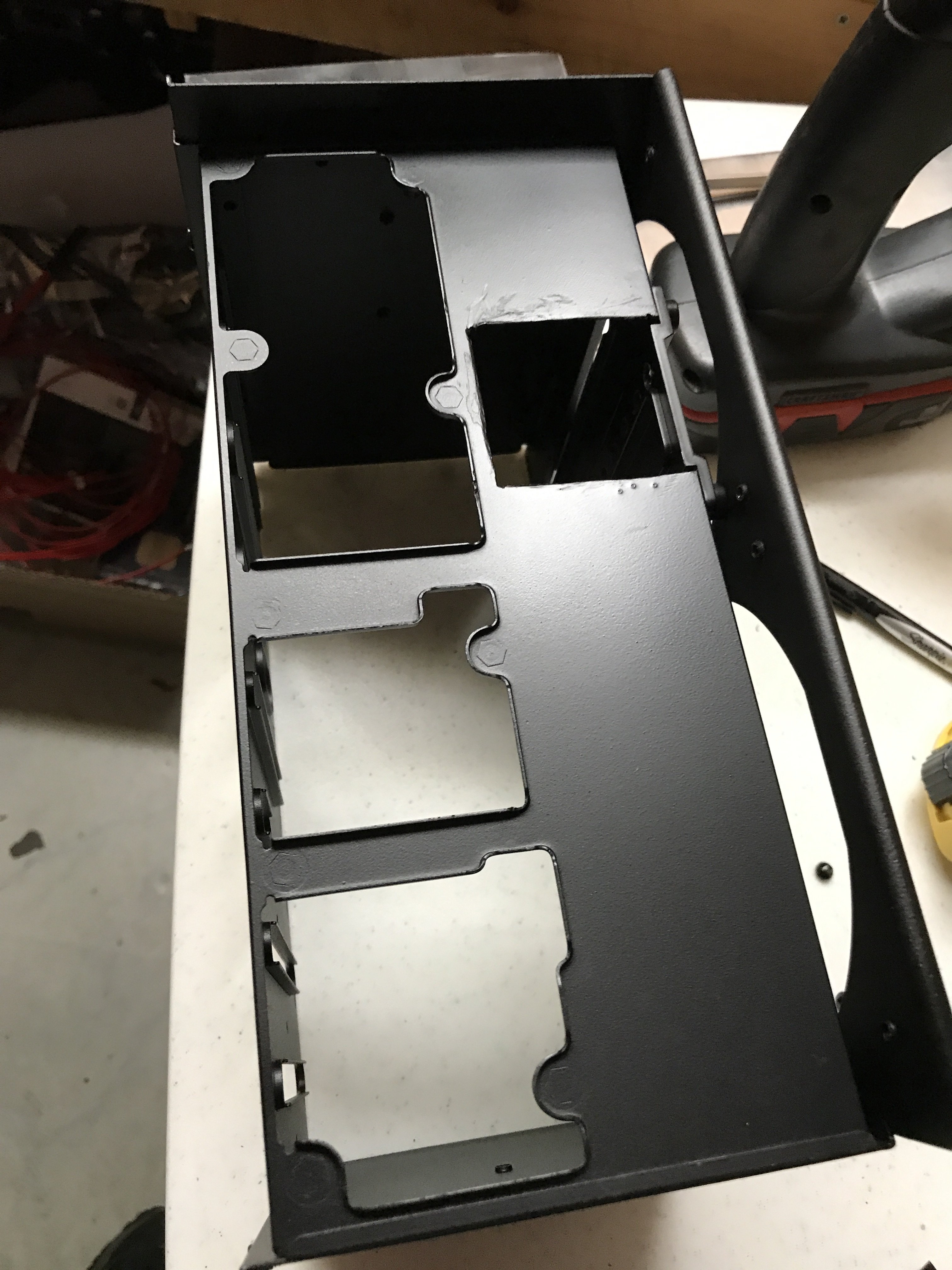

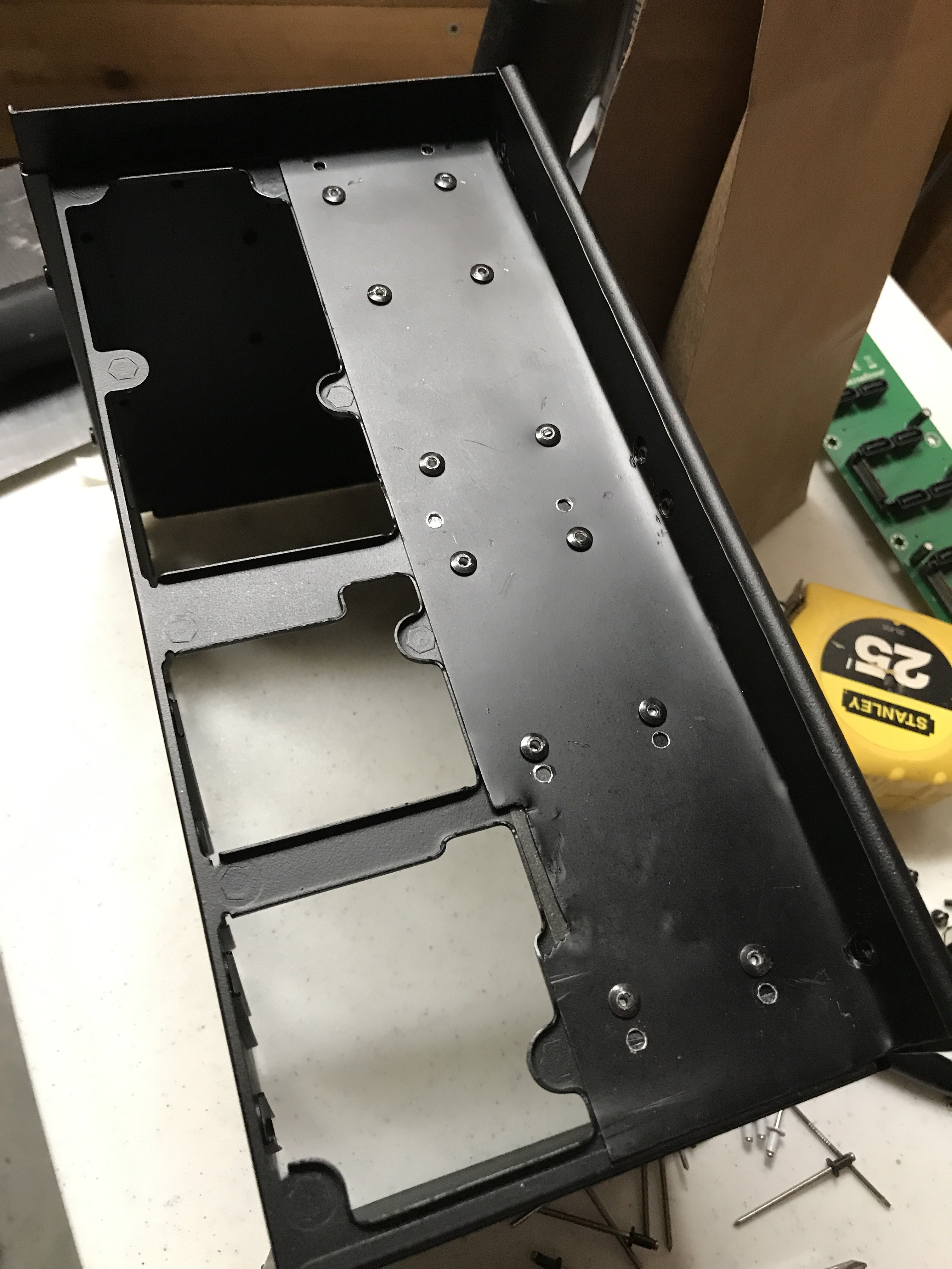

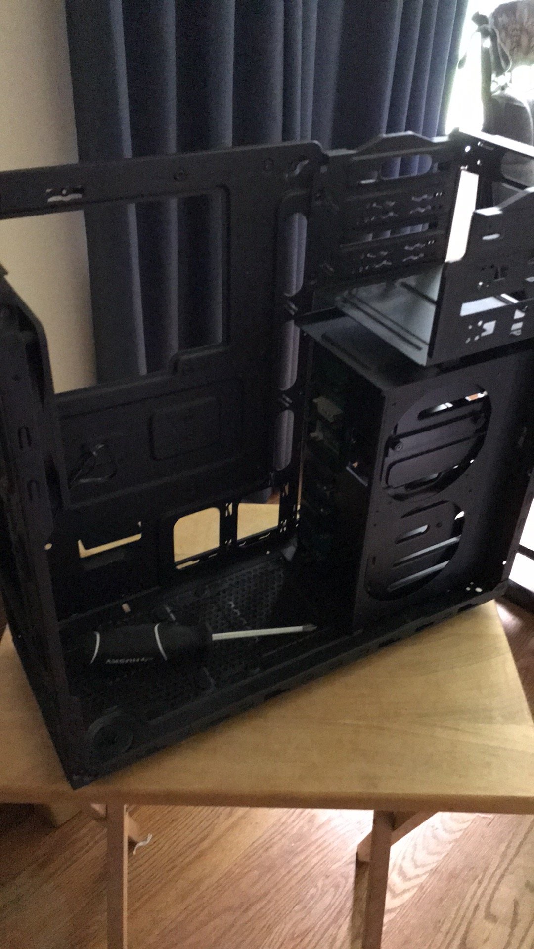

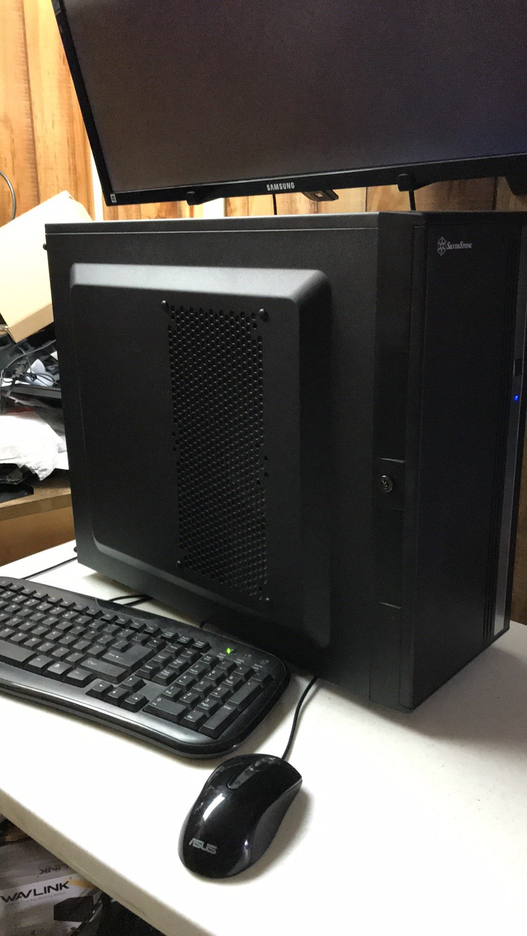

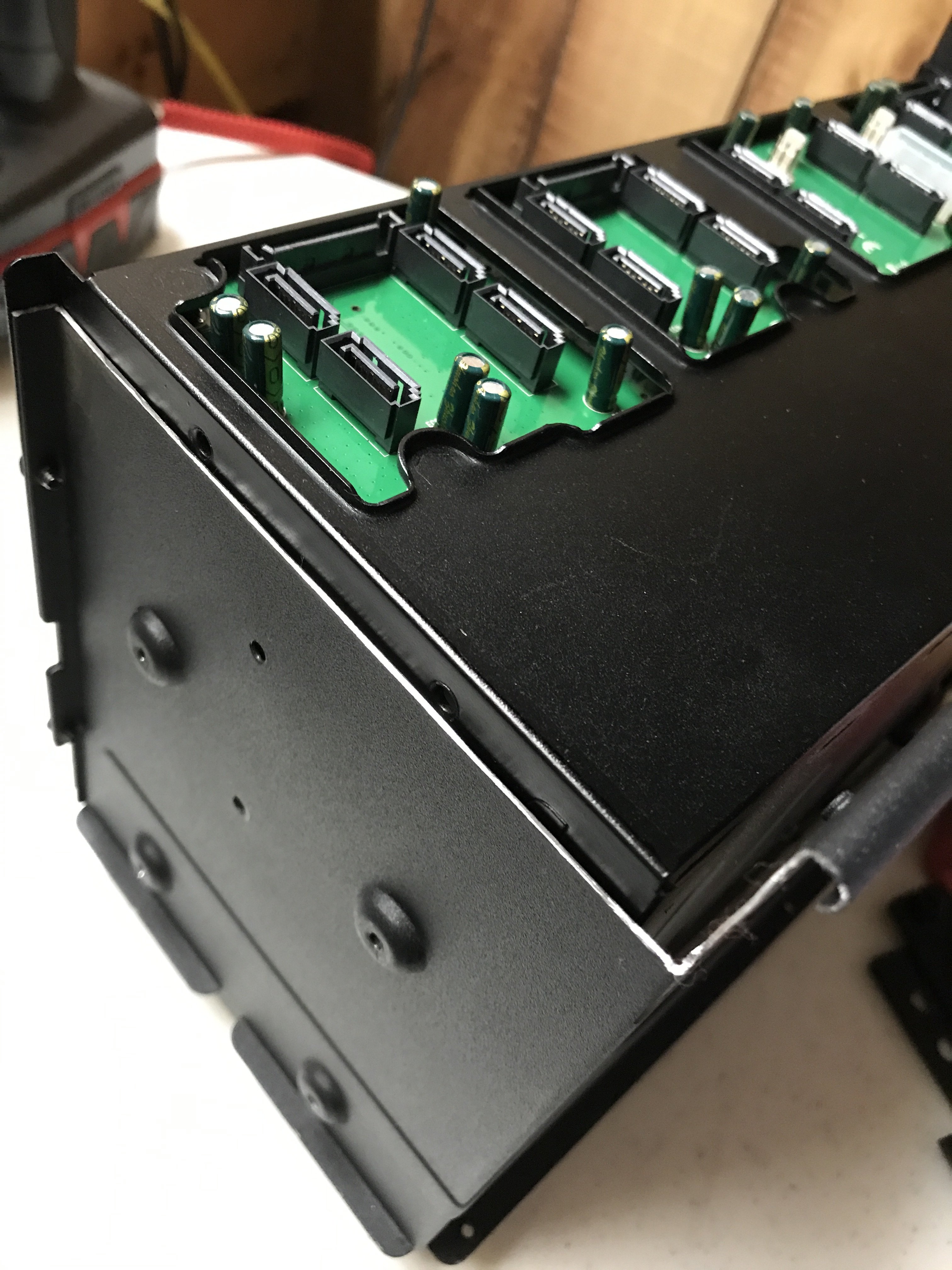

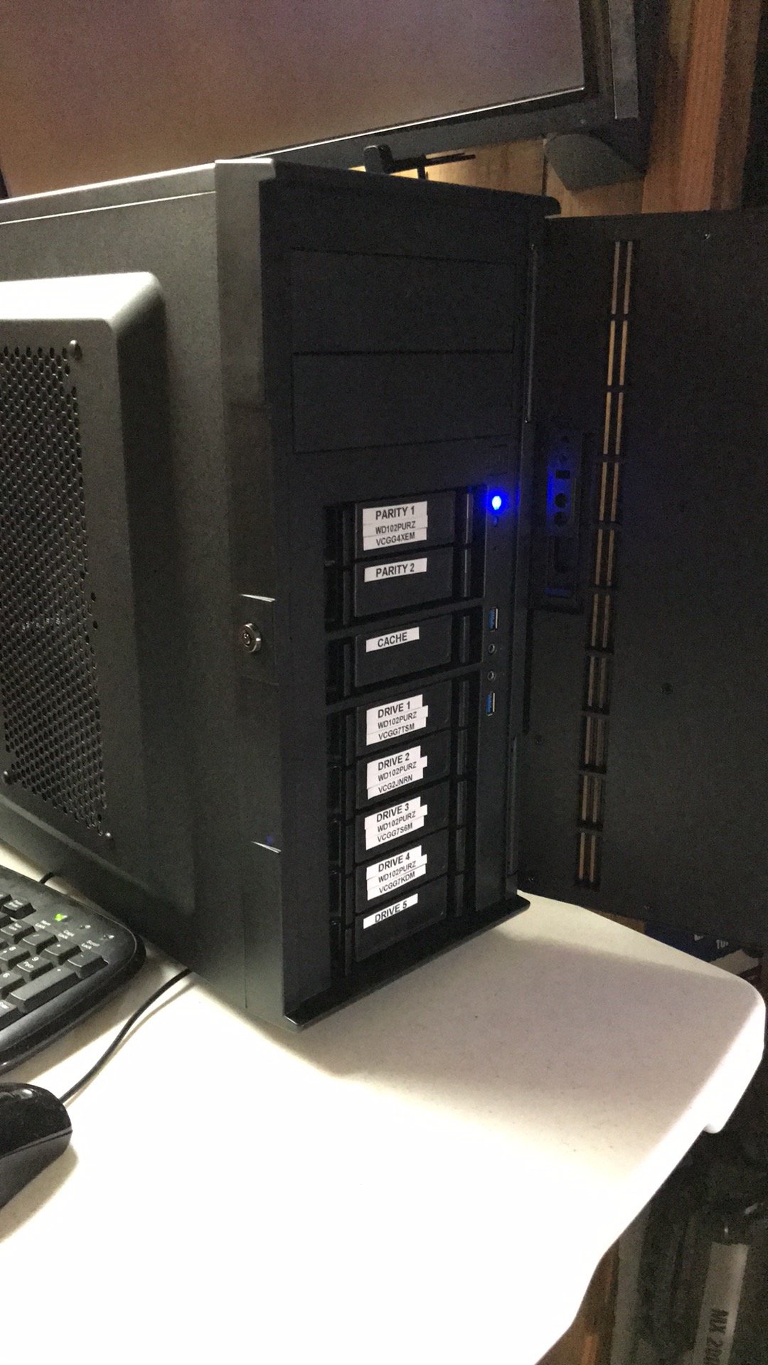

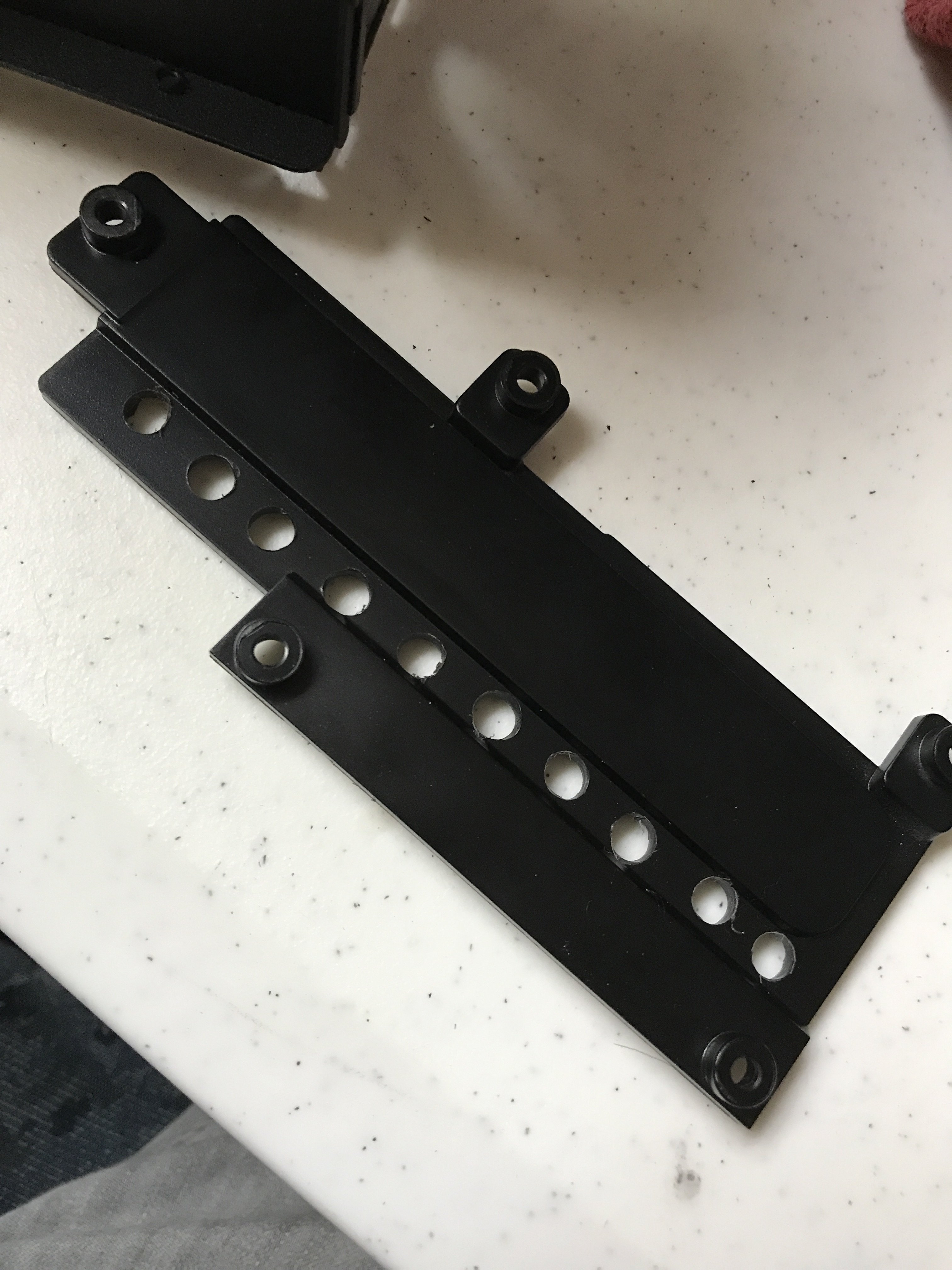

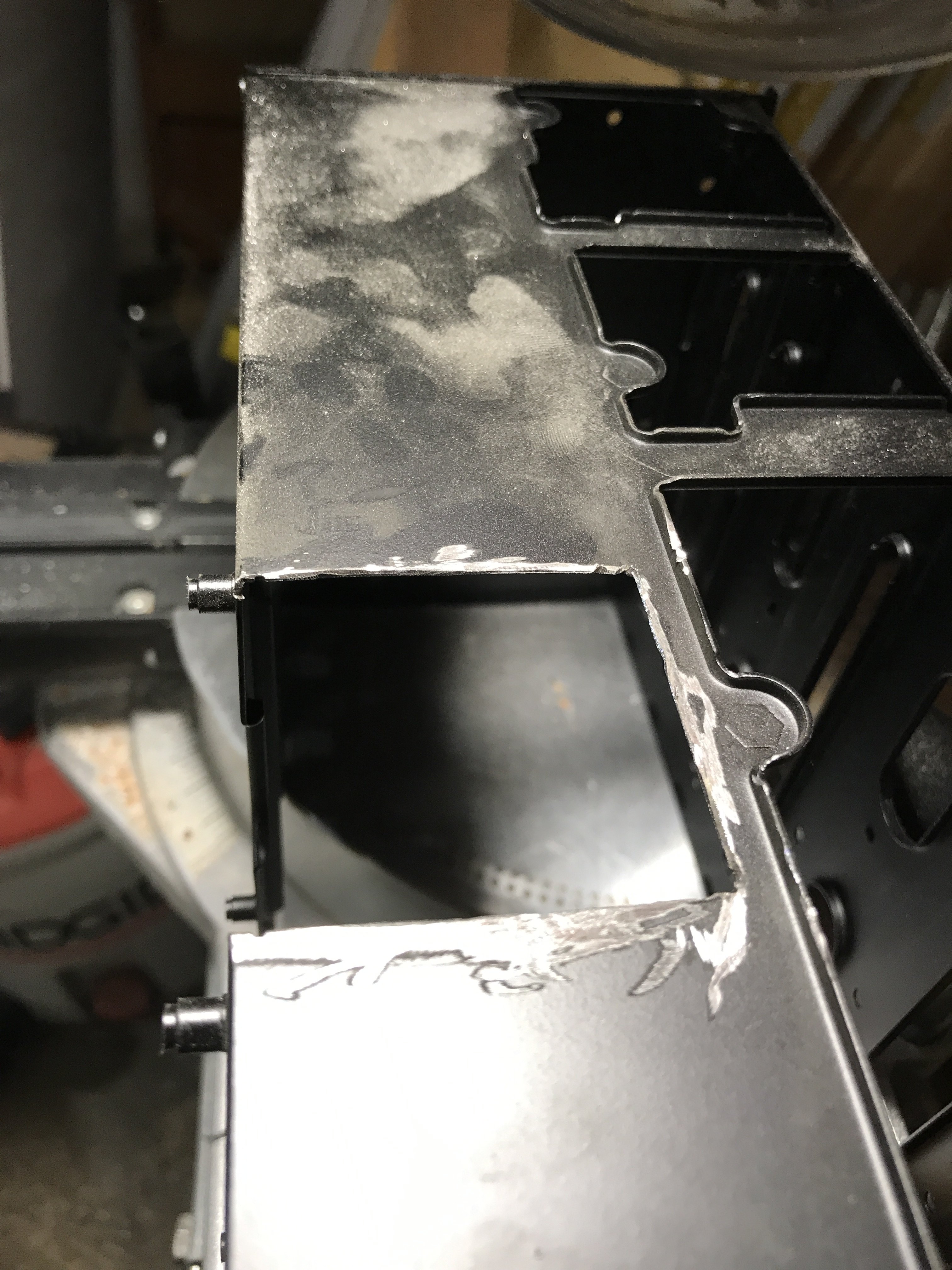

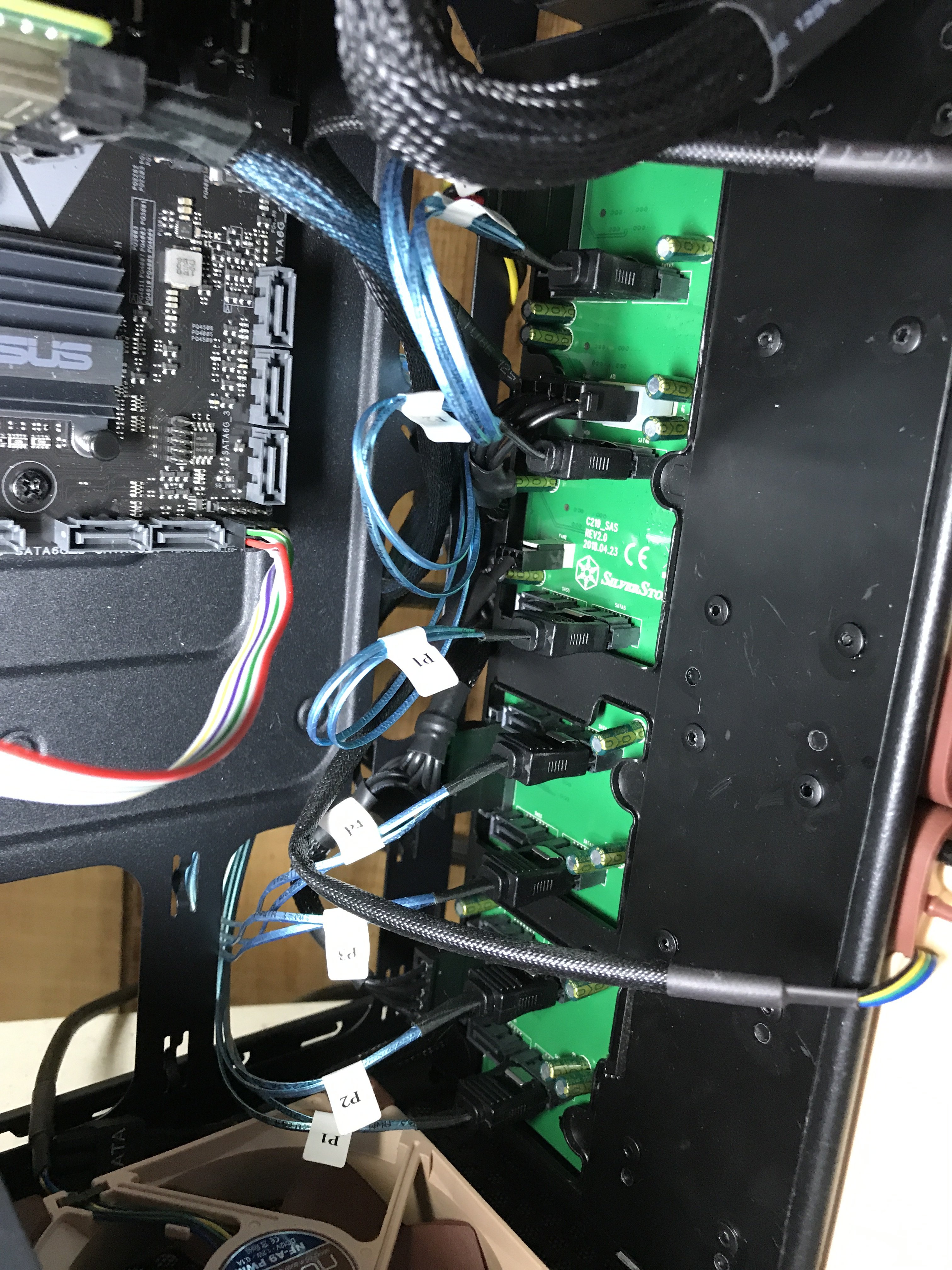

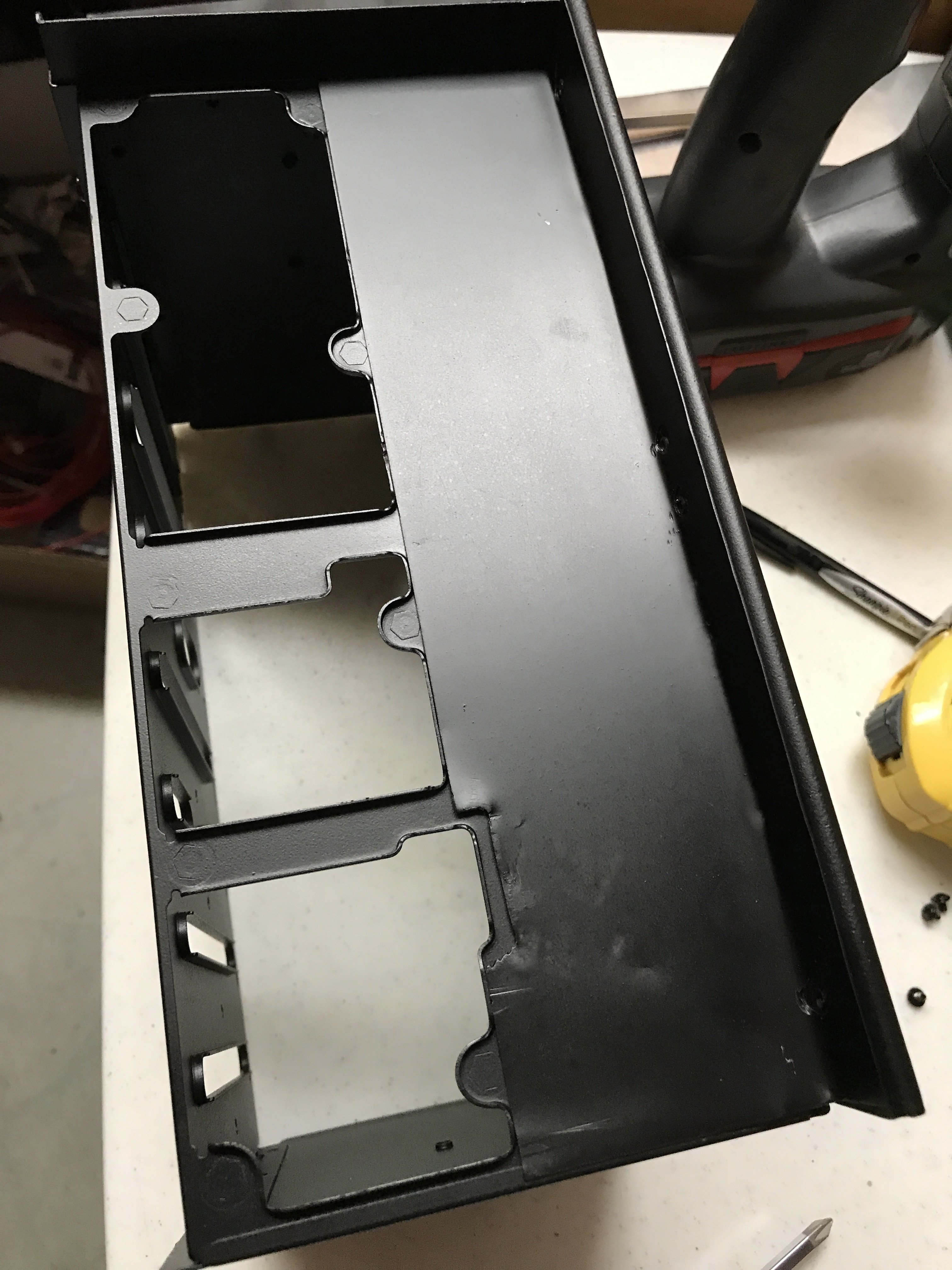

Just went through with my Silverstone DS380 build and modifications, let me know what you think. the temps and airflow are improved greatly after some real trial and error (could not have been done without you guys).
Here are some pics (gimme a little time to add them) to answer most of the questions.

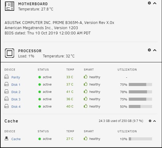

Here are the Temp stats for this case, running for about two months now. Under a media scan in emby this is an average of 43 degrees on the hard drives (WD Purple 10TB) and it might reach 30 degrees for the board, maybe 38 degrees for the cpu. I am so happy this turned out this well

Great work on your case! Are you happy with it?
Yes,  very much so, and greatly improved as far as cooling
And thank you,
Ice
