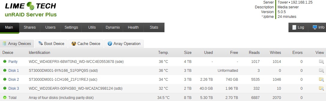

I did update parity to a 4 tb drive ove two months ago and the old parity became disk1.
Okay, this explains exactly what happened -- it also means UnRAID worked exactly as it was supposed to ... it was simply doing that with an old (no longer correct) configuration.    This is confirmed by reviewing you older thread (which is now available, thanks to the link provided by trurl).

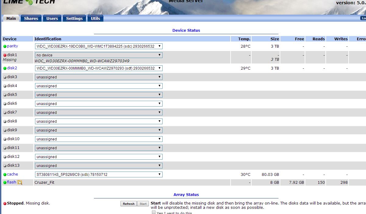

However ... somewhere along the way, the configuration info has been corrupted.  The Web GUI picture you posted [ http://lime-technology.com/forum/index.php?topic=32849.msg301742#msg301742 ] shows Disk1 as "Not Installed" -- not "Missing" ... but at the same time it shows it as an "Unformatted" disk.    I'm surprised at this display.
I get that disk1 is bad but the rest?????
The rest should all be fine -- at least the data disks.
Question:  Did you do a "clean" shutdown the last time you shut down the system with the RIGHT flash drive?  [bEFORE you booted with the wrong one]    If not, then what MAY have happened is that after you realized you had booted with the incorrect flash drive, you booted with the correct one ... but due to the unclean shutdown it started a parity check and began to update the parity drive.    However, these updates would be incorrect -- since the reason for sync errors was the changed data on Disk1 (caused by the incorrect boot to the old flash drive).    Thus the new parity info is no longer valid either.
If that did NOT happen, then you should indeed be able to install a new disk in the Disk1 slot, and do a reconstruction of the old drive.    But if it DID happen, then Disk1 is simply not recoverable (since you've already confirmed that Reiserfsck won't help).

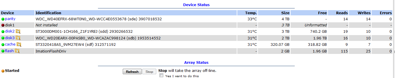

Ok all done...same screen.....array stopped....unassigned disk1
Disk 1 shows as 'missing' then right?  If so go ahead and Start array and let me know how disk 1 shows up afterwards.
see attachment
Disk one shows not installed
see attachment
That's unfortunate.  I haven't read through both threads to see the exact sequence taken, but if disk1 device was the only one clobbered, this procedure should have worked.
