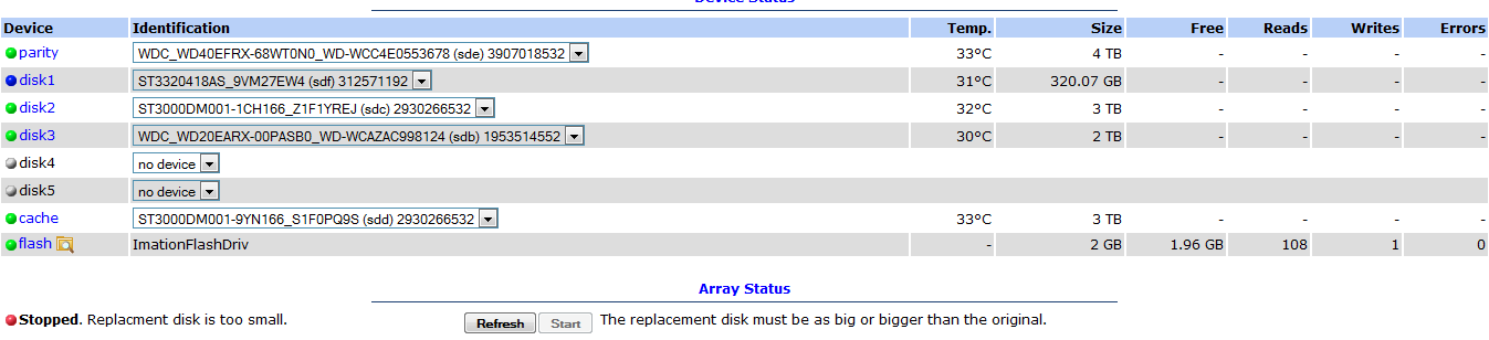

Here you go
Just want to make sure I understand where you are now.
Your "drive1" that you corrupted is currently assigned as your cache drive?

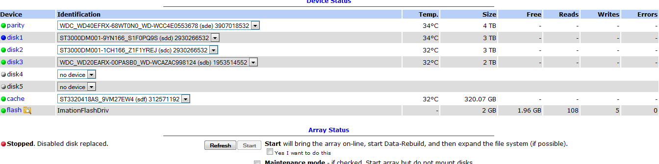

Ups sorry, wrong pic...

You can Start the array now and let it rebuild Disk1 -- it won't have any impact on disks 2 or 3.
Here's the issue:  Your earliest mistake (booting to the wrong flash drive) wiped out part of disk1, due to the automatic parity rebuild that was rebuilding parity on that disk;  and your subsequent actions resulted in an automated parity check on the correct 4TB disk that was rebuilding parity on it from the WRONG data on disk1.    Since then, you also made some changes to disk1 by running reiserfsck.
So ... whether or not a rebuild will result in any more recoverable data depends on WHICH disk -- disk1 or the parity disk -- had the most data messed up by those two actions.    But it certainly won't hurt to do it.  After you've rebuilt disk1, you'll need to redo the reiserfsck recovery on it ... exactly the same set of recovery steps you did before ... and then see whether or not you can recover more data than the first time.
So ... the steps you want to do now are:
(1)  Start the array and let Disk1 rebuild
(2)  Repeat the recover steps with reiserfsck that you did before -- with all of the same precautions.
Once you've done that, you're ready to do a New Config, and let a new parity sync be done, so you'll be back to a parity-protected array again.  But that's a couple days away at this point.
