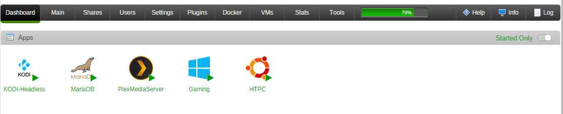

dmacias, of course I was able to run them before. I am running them right now, with the plugin uninstalled. VT-x / VT-d question: not answering  ;D. Please check attached image and signature for details and running VMs. Passthrough is enabled and running as well ...
It looks like I am missing something here. I've installed the plugin (since I am trying to setup Virtualbox as well). After installing the plugin, I am unable to run any of the VM's, with message "Error:invalid argument: could not find capabilities for arch=x86_64 domaintype=(null)". Tested several times (install plugin / reboot /VMs not working - uninstall plugin / reboot / VMs working). Images attached... Any ideas?
Were you able to run them before install this plugin?  Do you have vt-x or vt-d eneabled in the bios?
From that image you are running kvm vm's. I assumed you meant virtualbox vms. I had no problem installing apache and running kvm vm's. However there was a package conflict that would not allow vm's to be created because of libpng error.  I have removed a couple packages and updated apache. To fix that problem you will have to upgrade the plugin and reboot.  For the problem your having I believe it's caused by virtualbox running. You cannot run them at the same time. To run virtualbox you would have to stop libvirt under settings/vm manager, enable vms = no.
If that doesn't fix it let me know.
