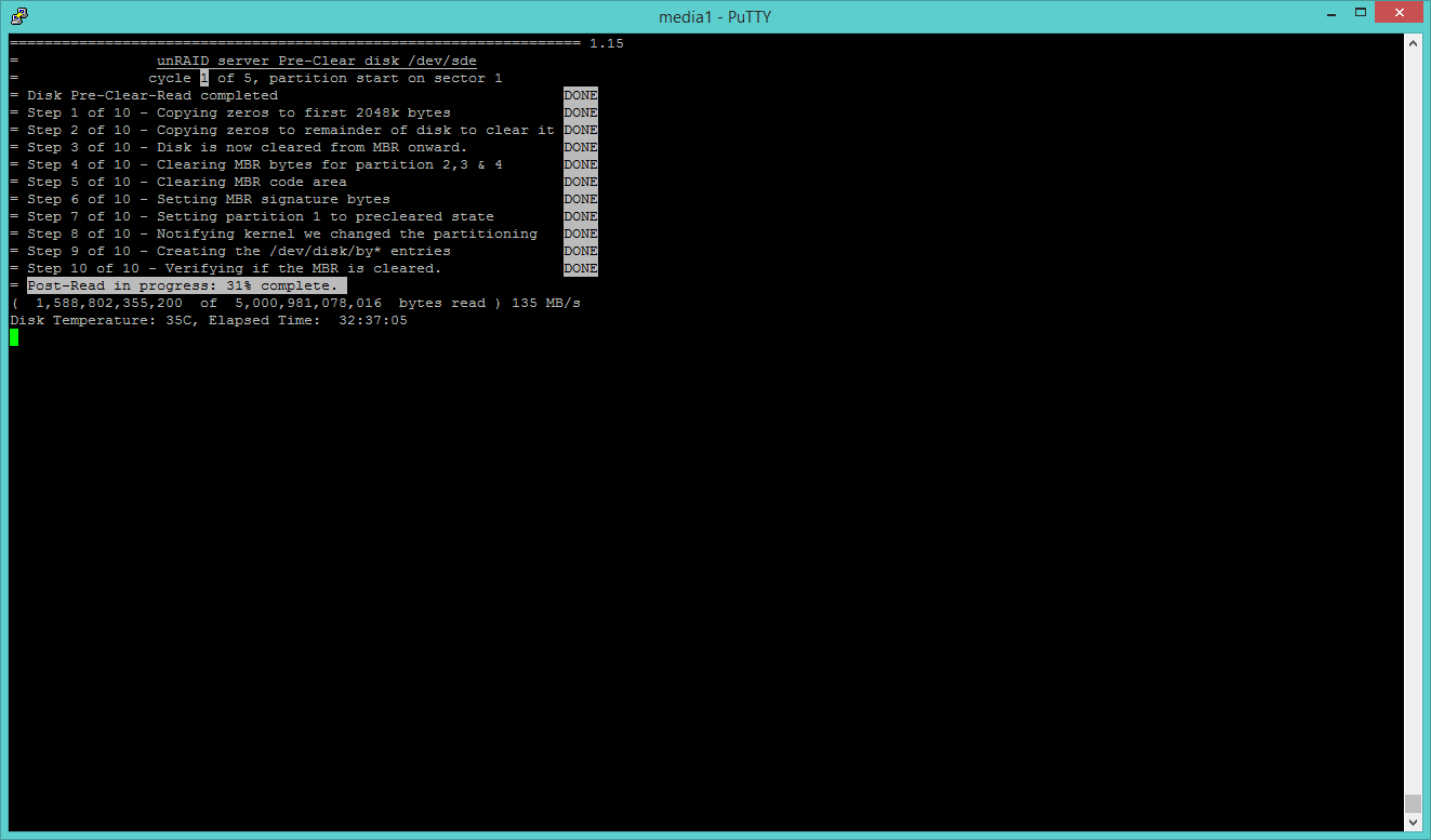

I started it over.  It had ran 50+ hours and was completed but I couldn't find the logs on /boot.  The subdirectory was not there.  I did find some out in /var/adm but I think since I restarted it, it wrote over the old ones.  Such as life.  Anyway, I am wondering if it is normal for the speed to slow down as it gets into the 90% range of completion?  Here is what I am currently getting after it running just the pre-read for 10.5 hours...
Yes, you are now reading the inside of the platters...its slower.
Yes, you are now reading the outside of the platters...its slower.
The outside of the platter is the fastest part AFAIK.  Assuming a drive is running at a steady RPM, one revolution at the outside of the disc holds a lot more data than one revolution at the inside of the disc.
Yes, thank you. I corrected my post, hoping nobody saw it yet.
My WD Red 4TB's dropped to about 77 mb/s towards the end but started of at 147 mb/s. Perfectly normal Pre-Read, my temp's on the drives normally max out at 34c during the preclear.
Sounds just about right for Reds -- I had about the same performance with mine.  I did notice a slight difference in timings if they were done on my Atom server vs. an i5-based server -- but it was only a few minutes out of the many hours of pre-clear times, so it could have even been just a variance in drives.
Ok, it is currently on the Post-Read and is 15% complete. Here is what the "smart_mid_after_zer01_sde" report looks like.  Can someone interpret this for me and let me know if there is not enough data to go on yet or tell me if this disk is a no-go and I should take it back today?
