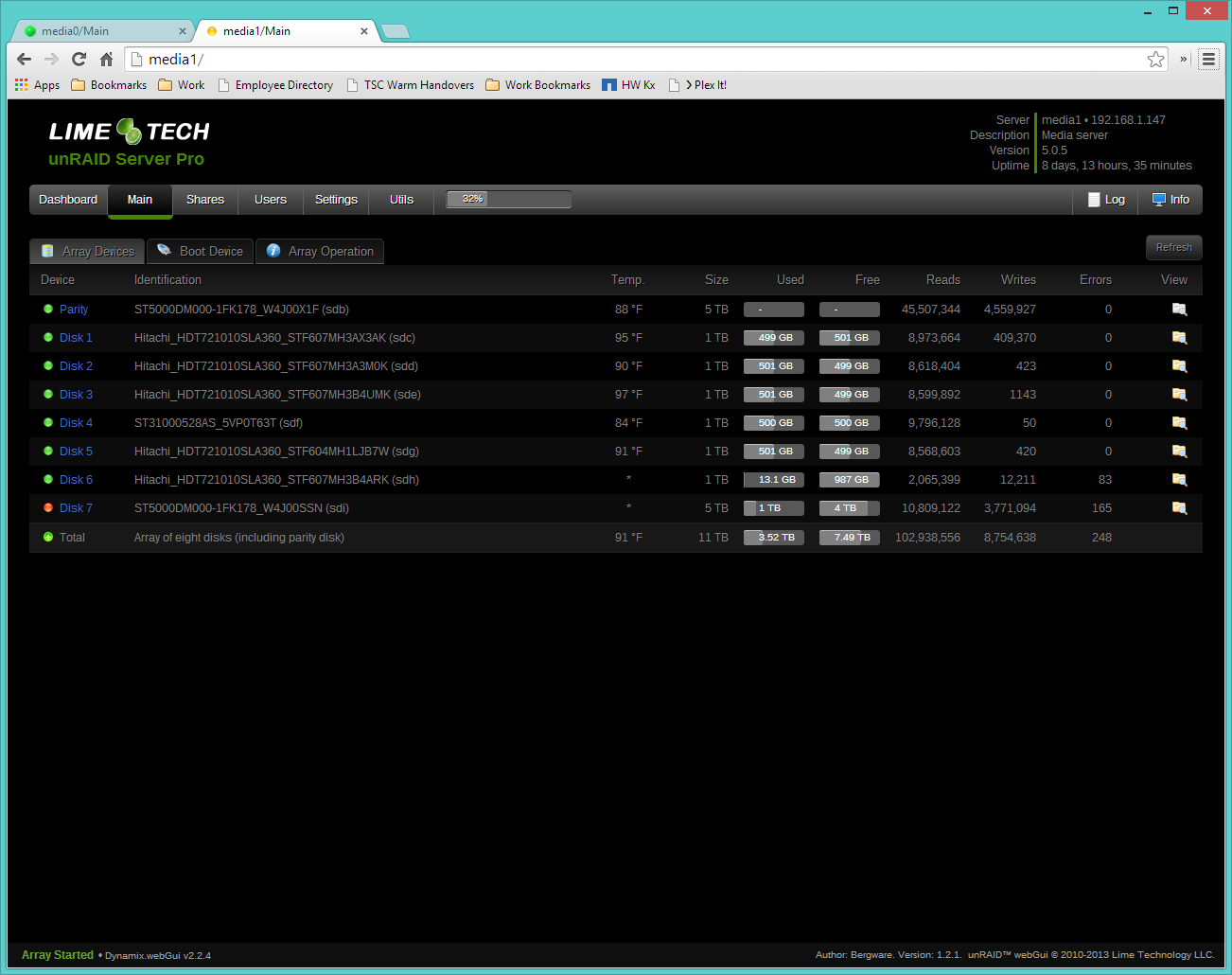

Brand new Seagate 5TB bought last week and now this...
This was one of the external "backup" disks.  Got it for $199 at Best Buy.  Shortest a disk has stayed in the unRAID box yet.  This sux.

So I stopped the array and rebooted.  It came up and said the disk was missing.  I stopped the array again and it said the disk had been "replaced" and said to click start to bring the disks online and expand the array.  Something aint right here.  :o
its now doing a data rebuild and the estimated finish is 3 days.  The pre-clear when I put the disk in last week took that long so I can go with that.  I just am wondering why it did this hiccup.
