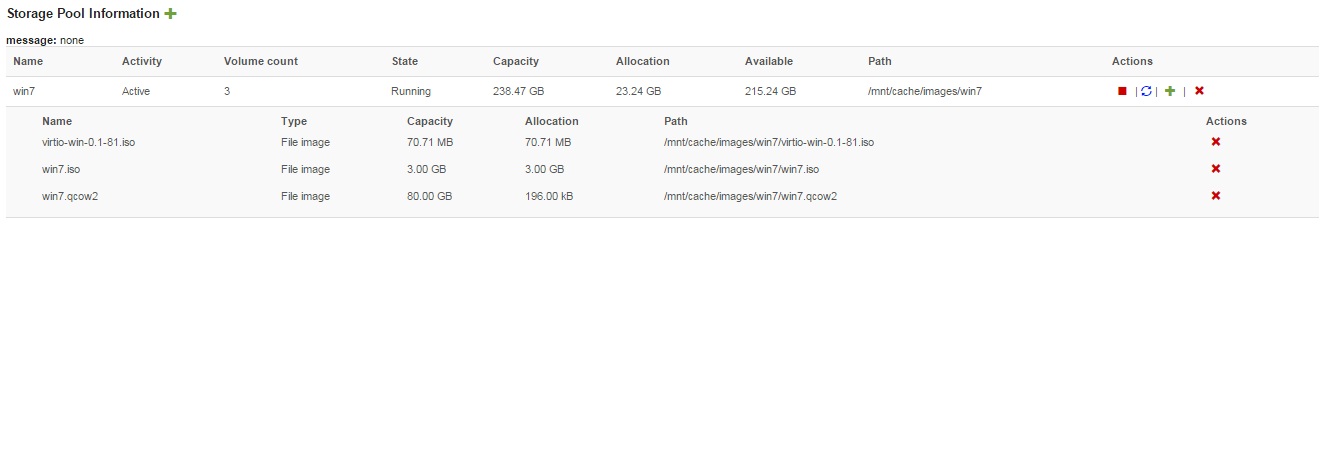

I just installed my first windows 7 vm through the create template section. You need a storage pool created with an image created for the vm first and the windows iso and virtio drivers images.  Storage pools just point to where images and iso are located.  You can create as many as you want or point to locations with iso images and a separate location for creating vm images.
Then goto create section, type  a name for your vm, add windows iso and virtio iso images, change cpu and ram to your needs ( e.g. 2 cpus and 2048 and max 2048), select disk image and type if not qcow2 then usb tablet for vnc mouse. Then click create vm. You should now be able to vnc into your windows setup.  Add drivers at hard drive install screen.  Browse through the virtio cdrom to the windows version your installing.  Once windows is fully installed I left the virtio cdrom persistent so you can goto device manager and update drivers for network from virtio drivers cdrom.  It will shutdown multiple times and you just start it up again and finish.

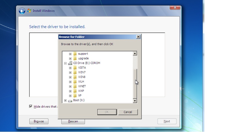

Thanks for the update dmacias. I have tried your steps but the drive to install on still isn't showing.
I really don't know what I'm doing wrong.
Using your steps my xml looks like this:

When I went to the Create XML I left the "Mount Tag" empty.
My unRAID share was /mnt/cache/images . Would that have something to do with it?
Anything jump out that would cause it?
I guess I need to label that better.  The share settings won't work for windows. They are for passing through your unraid shares and mounting them in a linux vm. There is no 9p share pci driver for windows. They won't hurt anything. There will just be an undefined pci device in the device manager.
But from your screenshot you need too go to the win7 folder on cdrom e: and then to the 64 or 32bit driver folder and install the hard drive drivers. I think it's the scsi drivers.
Also make sure your cache image folder is cache only.

Also, you must have the storages section filled out before trying to create the VM.
I was struggling with this last night.  Here's what I discovered.  I was unable to install my windows, due to a problem with my iso image.
After stopping the progress, then resolving my iso issue, when I went to start the VM again, it failed.  I looked at the XML and all the drive information was missing.
i had to delete the VM completely, then start from scratch, and reselect all the drives in the setup again, and then it finally worked.
I don't know why the drives kept getting removed, but I suspect this is the problem Manticore is facing.
Once the installation progressed enough that windows wanted to restart, the VM didn't restart, and I had to manually start the VM each time.  I was afraid it wouldn't work, due to the drive issue above, but it did start fine again from this point, and it seems to be working fine right now.  I'm currently installing updates as I type this.
Other than the issue with the drives disappearing, this plugin is REALLY helpful.  Thanks for providing this for us.
Any chance you could post your XML Justin?
Did you have to install network adapter drivers after you got it up and running?
I'm going to do what you said and remove and re-add everything again....here we go agiin
Thanks again to dmacias for this great tool. I'm sure the issues that I'm facing is something silly on my end.
Any chance I could get a peek of your xml dmacias  :-[
My xml would look almost the same as Justin's. After install and all the rebooting is done, you go to start then right click on computer and select properties then device manager. There should be some devices with ? marks. Just update the drivers for those pointing to the cdrom/win7 and 32 or 64bit. I believe one's network and the other is memory balloon.
When I was installing windows, I selected the balloon and network drivers before the scsi driver, and they stayed installed thru the windows install, so I didn't have to do this step :)
All good now. Thanks guys.
