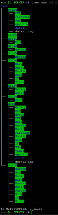

What exactly is the error? Are you saying that you can't navigate to /mnt/disk3/disk3?
4 hours ago, tunetyme said:
can't do a /mnt/disk3/disk3
Could you please paste the output of this command?
tree /mnt -L 2

So is this the output of the tree command asked for?
It would be much better to see the complete output as a screenshot exactly as it appears rather than some sort of transcription.
How are you getting to the command line? Keyboard/monitor or telnet/ssh? Should be easy to get a screenshot from telnet/ssh client.
For example, this is what that command gives me:
That is the display I saw but not clear how to copy and paste to the forum
