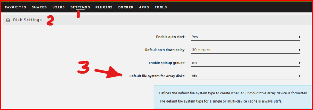

One thing the wiki doesn't mention is formatting the new large disk. unRAID will give you the option to format that disk after adding it when you start the array. Since that method doesn't involve rebuilding any disk, you can format that disk to any filesystem you want.

Stop the array.
Click on the disk you want to reformat to get to its settings page.
Change the filesystem to XFS.
Start the array to reformat.
There is never any removing a disk or adding a disk back again. The disk is already part of the array. You want to keep the disk as part of the array. You can format the disk while it is part of the array. Formatting will write a new filesystem to the disk, and since it is still part of the array, that write will also update parity so it remains valid.
As for the other thread, it is completely irrelevant whether the replacement disk had a filesytem or not. When you replace a smaller disk with a larger disk, that smaller disks contents are rebuilt to the larger disk. The filesystem of the smaller disk is its contents.
If you try to follow my instructions above, and for some reason you think it isn't working, post a screenshot.
