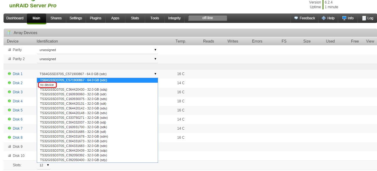

Minor change suggestion to the wiki:
Go back to the Main page and click on the dropdown for the new drive (e.g. Disk 11) and unassign it (click on "no device")
It actually is "unassigned" not "no device" on 6.2.4.
Do you mind posting a screenshot, is yours different from this?
Of course. I'm about halfway through converting another drive, so I should have a screenshot this evening after work.
Here it is:
Here it is:
You're right, the option is different when it's done with assigned disks (no device) or after a new config (unassigned), so for this procedure since it's after a new config the correct option is "unassigned".
Thanks for pointing it out.
@Rob, I still can't edit the wiki, please correct that when you can.
Thank you guys, changed it.  I decided to keep both, with 'unassigned' first, in case an advanced user is 'adapting' the instructions to their particular use.
