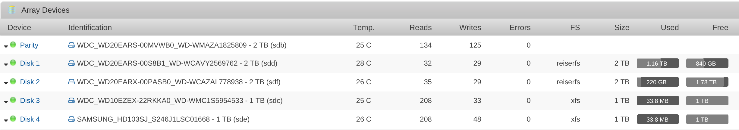

So to make sure I understand the concept that I'm going to do:
  • I have an empty 1TB drive (with xfs) and a 2TB drive (reiserfs) with a small amount of data on it. Therefore copying data from 2TB drive to the 1TB drive.
  • Format the 2TB drive just used. That gives me a 2TB drive with xfs. That drive will then be able to be the receiver for the data stored on the other 2TB drive I have
  • Then format the other 2TB drive. Job done...?
Is that fundamentally what's going on here? This is obviously an action that takes some planning - Google brought me here after I noticed that the two 1TB drives I added were in a different format (my upgrade path was 4.7 -> 6.1.9). Screenshot attached for ease of reference.

basically yes, although you left out the step where you change the format of the 2TB drive (with the array stopped) from ReiserFS to XFS.    The key point is that you cannot change the format of a drive and keep the data on it intact and thus a lot of copying is involved.

Thank you! It may be that my example is clear(?) enough to use to explain this - even if I did gloss over the fact that changing the format of the drive = nuking all the data on it. But I appreciate you confirming my thinking.
Just be CERTAIN that when you copy the data from one drive to another you do NOT do a share - share copy ... if you encounter the infamous "user share copy bug" you'll lose ALL of the data involved in that copy.
