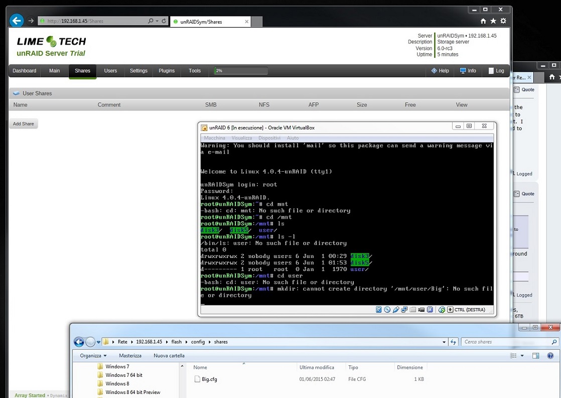

I can confirm this happens testing unRAID 6.0 RC3 in Virtualbox too using the "boot from disk and having an usb with licence key plugged " trick.
I don't know if this happens on "production" systems on bare metal too.
It's not possible to create user shares and the "mkdir: cannot create directory '/mnt/user/NewShare': No such file or directory" is displayed on console.
If I stop the array and make a user dir on mnt manually, it is possible to create user shares, BUT they display free space of the boot disk and NOT the free space of the array.
If I then stop array and remove user dir in mnt, when I start array again (with or without a reboot), my user shares aren't recreated even if they are present on /boot/config/shares and on \\tower\flash\config\shares too...
I hope (but NOT sure...) it's related to the boot trick used to test unRAID in Virtualbox and that all will go fine on bare metal with a "standard usb boot"... can you confirm it?
EDIT: added screenshot attachment to best explain... please note how user dir is created differently than diskX ones (not green like diskX... I don't know what's the difference anyway  ???)... I can't cd to it! And neither chmod it! :o
And when I go to add a "Big" user share by web interface... this is the mkdir error displayed.
The Big.cfg in flash share config has been created by adding user as dir with manual mkdir, BUT then it share space on boot IDE disk and not from array...  ::)
If I reboot, Big.cfg is still there, BUT no share go on if I don't mkdir user again...  :(

Please... read with more attention what I've reported.  :(
I have NOT enabled user shares with array started. And even after a reboot (with user shares already actived) the issue described is still there.
About RobJ thoughts... he's right, but this is not my case. I'm surely more trained on Windows OSes (I am an IT manager of a distributed network of over 400 workstations and related servers...), BUT I know a bit of Linux too, enough to understand how Linux filesystems work.
Mine was only a simple try on a testing (more... virtual!) environment to see how to fix a bug which otherwise I didn't know how to fix.  ::)
I think that it is related to bad attributes on how the 'dir' /user is created dinamically by Fuse, since if you look at my screenshots, it is well different from /disk3 and /disk5 that, in fact, works fine (and they are dynamically created too... but I'm not sure if ever by Fuse).
When I 'artificially' created /user dir (with similar attributes to /disk3 and /disk5), the web interface was able to create user shares but, obviously, they didn't work correctly because of mapped to boot disk since mine was a real dir!
Please note that even dirs created on top level of my disks aren't automatically shared on this test system.
If it's related or not to booting from ide disk with the 'usb inserted trick' I still don't know (I would go bare metal in a day or two...), but since there are a lot of people using it on VM systems with similar boot, I think this should be investigated as well.
If you need a syslog, just ask for it!  ;)

I've gone to bare metal. I can confirm this issue shows only if using hard disk for boot and "inserted usb trick" used by many on VM testing/use.
This is what I get on bare metal unRAID:
root@unRAID1:/mnt# ls -l
total 0
drwxrwxrwx 3 nobody users 20 Jun  2 20:45 disk3
drwxrwxrwx 2 nobody users  6 Jun  2 20:39 disk5
drwxrwxrwx 2 nobody users  6 Jun  2 20:43 disk7
drwxrwxrwx 1 nobody users 20 Jun  2 20:45 user
This is what I get on VM unRAID:
root@unRAIDSym:/mnt# ls -l
[color=blue]/bin/ls: user: No such file or directory[/color]
total 0
drwxrwxrwx 3 nobody users 19 Jun  1 04:02 [glow=green,2,300]disk3[/glow][color=blue][b]/[/b][/color]
drwxrwxrwx 3 nobody users  106 Jun  1 03:23 [glow=green,2,300]disk5[/glow][color=blue][b]/[/b][/color]
[color=blue]d------------[/color] 1 [color=blue]root root[/color]  0 [color=blue]Jan  1  1970[/color] [color=blue]user[b]/[/b][/color]
(highlighed the differences...)
It's A LOT different...  :o
Strange is that only Fuse go wild in the process, when all the rest of the system go flawlessly...  ???
Here you are...!

Since having Virtualbox still not supporting USB boot in 2015 (and with an USB support still quite buggy...  ::) ) and having Limetech officially not supporting unRAID on VMs (even if a LOT her are using it at least in ESXi with no or minimal issues), I'm actively working in solving this issue since I really would like to have a 'virtual lab' of my unRAID system where make tests, experiments and so on (I like working this way... I've a Virtualboxed replica of all my AD DC controllers with some clients too... and it's perfectly working & proved to be very usefull sometime! ;)).
This issue is officially related to Fuse that seems to go crazy on dinamically creating user shares when array is started and system has been booted from hdd using 'USB inserted trick' for licence and config files.
Since fixing Fuse behaviour is out of my 'abilities' (for now...  ;D) I'm concentrating in two different directions:
- a boot manager, possibly on a live CD or floppy .img, capable of booting fine from USB, and... it doesn't work.
- modifying unRAID syslinux startup commands to make them load bzroot and bzimage from USB even if boot has started from hdd (or CD... Eheheheh...  :P) since this could probably fix the Fuse issue...
The first seemed the easier one, BUT with Plop failing and Virtualbox USB support still a bit buggy, I've not still able to find a suitable solution (even SuperGrub live failed... suggestions are appreciated....)
it doesn't solve the issue.
So I'm focusing ond second one since syslinux is very powerful... BUT my experience on it is very limited... and I'm asking help to someone more trained than me on it...  ???
Since what I've understood, we should try a 'chain boot' with a first syslinux boot (from CD or HDD) that calls a second syslinux boot from USB (the unRAID stock one), OR a way to modify the original bzroot & bzimage load commands to make them pointing to USB instead of CD or HDD.
But up to date, I have been able only to get mounting errors & similar...  ::)
(unRAID syslinux sequence seems to be a bit 'advanced' and not so easy to fully understand and modify using syslinux manuals & guides...  :o)
Someone (limetech?  bonienl? :D) capable of giving me tips?
At last I was able to load from USB with PLOP and setting USB 2.0 support disabled in Virtualbox... BUT the Fuse issue is still there!  :'(
