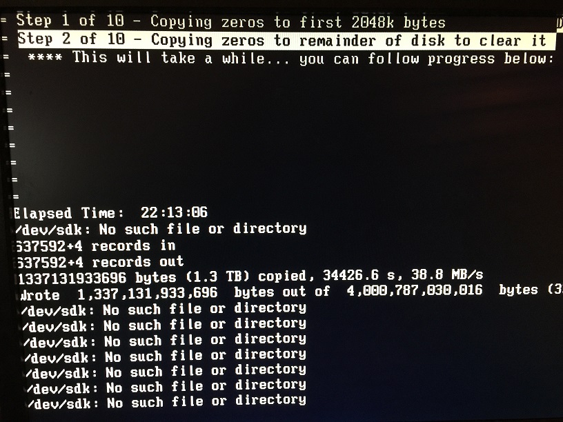

Cabling shouldn't be a problem as I am using a Norco 4224 case with SFF-8087 to SFF-8087 connectors to the backplane.  No other drives within that bank are having problems.
I started the preclear again last night and it got hung up again on Step 2.  This time it only made it 33% of the way through.  See the screenshot.
It looks as if the drive has dropped offline for some reason.
To get any further diagnosis you really need to provide a syslog that includes the problem period, and ideally a SMART report for the disk in question.
The commonest causes of this are always cabling (either power or SATA), or a power supply that cannot handle the number of drives in use.  Sometimes it can also be a drive that is not well seated so that vibration can cause a momentary disconnect.
I posted the syslog a few posts above the first time that the drive went offline.  I have attached the smart reports that I just ran last night for the drive in question.
In regard to the power supply, all of the other drives are spun down and not active when the preclear fails.  Therefore, I don't believe it to be a power supply issue.
