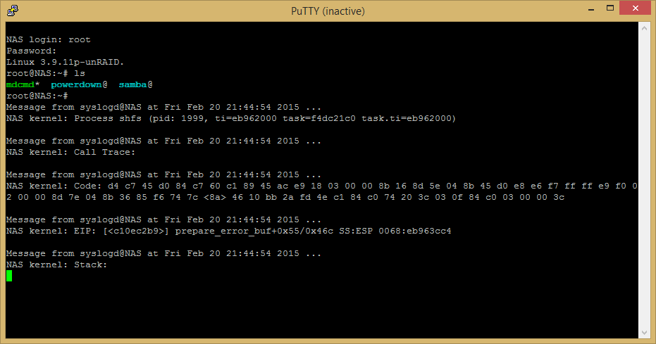

Out of the blue yesterday my unRaid 5.0.5 box started to hard crash on me.  I can't seem to get much information on it aside from the screenshot attached.  I really don't know my way around Linux so not sure where to look for dump files or error messages ect.
When the crash occurs the box is completely non-responsive both from a remote terminal, unraid web interface, shares or the command line itself.
Upon reboot the box seems to stay up for about 5 minutes then crashes again.
